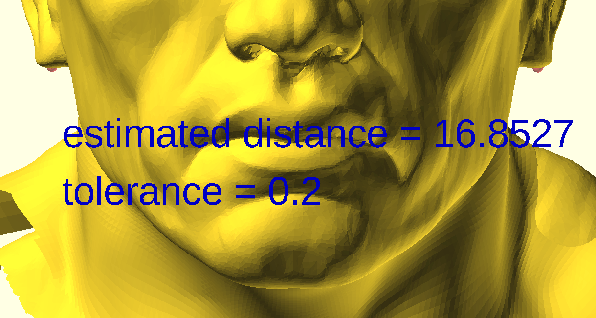

The advantage of % is you can hit F6 and the sphere won't get added to your
object. If you don't like transparent grey you can override it with color.
E.g.color("grey") %.

HI Nophead,
I  used your suggestions wrt the alt and up/down arrows, (and the norm)
and it makes the process far more usable, and I've used the % too, but in
this case, it was a bit distracting in the grey, due to transparency, to
locate the spheres where I wanted them, and for the final positioning I
removed the %, and lived with the possibly slightly slower rendering in
this example.
Having revisited it, I find that rendering times for moving a sphere
around in this particular stl file,  seem to be very similar, between 0,036
and 0.079 in both cases (i.e. with and without %.) - removing the text
lines, rendering (based on half a dozen or so alt/arrows)  lies between
0.038 and 0.043 for the yellow, and 0.026 and 0.042 for the transparent,
which explains why I noticed no difference in speed of rendering this
particular file.
On 04/09/2021 12:43, nop head wrote:
Looks like you are using # rather than %. # will highlight pink but still
be included in the model. % will be transparent grey and not included in
the model.
On Sat, 4 Sept 2021 at 12:19, Ray West raywest@raywest.com wrote:
Thought I'd try it with an stl. No problem. can easily reduce the
tolerance sphere, once it's located near enough. In this example the
distance between bottom of ear lobes (no idea of scale.) If it takes too
long to render, can always temporarily remove the region that is not needed
for measuring.

If you use the background modifier (%) for your measurement object, it
won't interact with the rest of your model, so the rest of the model SHOULD
be able to load from cache and not need to be re-calculated. Sometimes
preview is still slower than you'd like when nothing has changed if the
model is particularly complex, but it will always be faster if the program
isn't trying to do boolean operations involving any of the parts you've
modified since the last preview.

Just thinking. But how is it best to position a measurement checking
object quickly around a model that could take many minutes to render? How
is it best to cache the model and just have the measurement part redrawn
each time? It is still "check by eye", but I have found repositioning the
test object painfully slow at times.
needed for measuring.
