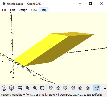

Consider mulmatrix.  It's not apparent to me why this is useful, unless I
want to do something fairly complex involving iterated transformations.  It
sounds like I'm missing something.  I understand what matrix transformations
do and whatever I'm missing isn't obvious to me.  And the search()
function?  I have no clue what that could possibly be good for.

I rarely use multmatix. So far I have only used it to skew things as most
other matrix operations can be done with translate, rotate, mirror and
scale.

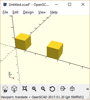

On 2/20/2019 4:59 AM, adrianv wrote:
Of course one can say you learn what you need to in order to make the design
you're trying to make.  But it wasn't apparent to me, for example, the way
that modules could use children and what (some of) the implications are.
Have you read this tutorial?
http://www.tridimake.com/2014/09/how-to-use-openscad-tricks-and-tips-to.html
It covers children in section 4.
The capsule summary is that you can write a module that can consume
child objects and manipulate them.
module double(offset) {
    translate(offset) children();
double([3,0,0]) cube(1);
Skewing.  This example skews in x and y based on z - that is, as z gets
bigger, x and y translate.
module skewz(x, y) {
multmatrix([
[ 1, 0, x, 0 ],
[ 0, 1, y, 0 ],
[ 0, 0, 1, 0 ],
[ 0, 0, 0, 1 ]
]) children();
skewz(1,1) cube(1);
