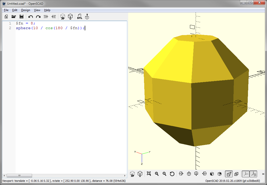

This is not sufficient.  In my original case I had $fn=8 and that resulted
in my model being unprintable due to the discrepancy.

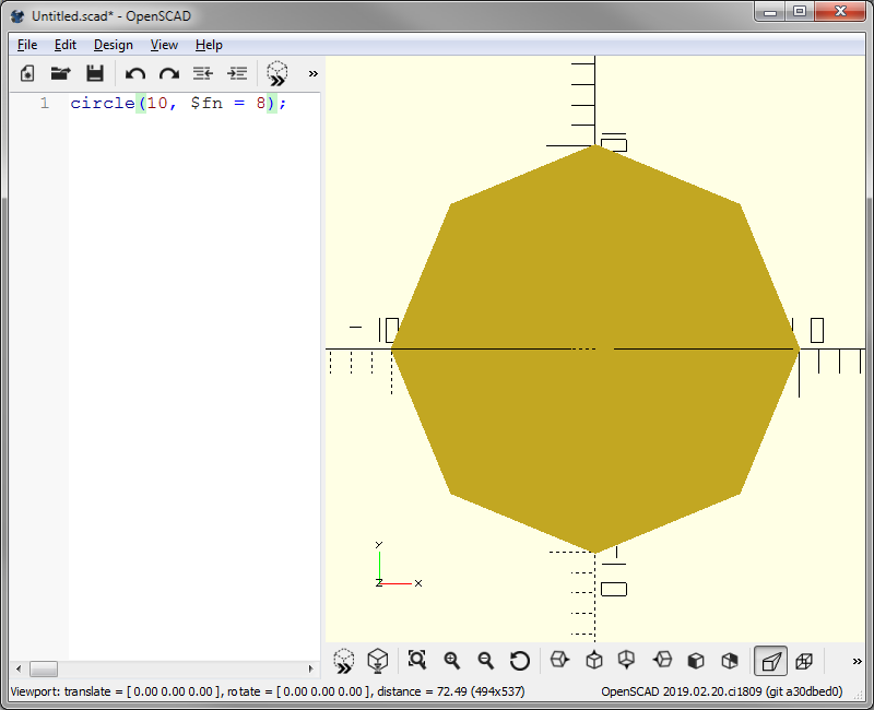

Oh yes, spheres are a bit broken. Here you can see that a circle of radius
10 has its vertices exactly on 10.
But sphere doesn't get the poles and the equator correct as it starts the
latitude circles half an angle out.  So yes dividing the cos(180 / $fn)
fixes it.
Alternatively, writing ones own with polyhedron is probably better.
resulted
Actually all I can tell from that picture is that the circle is close to 10.
I can't tell that it's exactly ten.  Could be 10.1 maybe.  Could it be 10.2?
Maybe.
I went ahead and looked at the STL for
linear_extrude(height=1)circle(r=1,$fn=8); and found that it looks like
this:
solid OpenSCAD_Model
facet normal 0 0 -1
outer loop
vertex 0.707107 0.707107 0
vertex 1 0 0
vertex 0.707107 -0.707107 0
endloop
endfacet
facet normal -0 -0 -1
outer loop
vertex -0.707107 0.707107 0
endloop
endfacet
facet normal 0 0 -1
outer loop
vertex 6.12323e-17 1 0
endloop
endfacet
facet normal 0 -0 -1
outer loop
vertex -1.83697e-16 -1 0
vertex -1 1.22465e-16 0
endloop
endfacet
etc, etc, etc
I loaded the data into octave and checked that the x and y range from -1 to
1 and that furthermore, all values above 0.9 are equal to 1 and all values
below -0.9 are less than 1.  So that's confirmation that nothing surprising
has happened.  I suppose I ought to do the same thing for my boundcube()
module.
