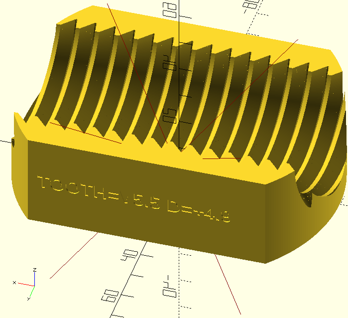

When I make nut for this screw, I have a routine that engraves some text
of a side of the nut the size being trimmed by a variable named diatrim.
So first I setup a var:
ver="TOOTH=V5.5 D=+diatrim";
then converted into text by:
module ver_txt(s,t)
linear_extrude(height=t)text(ver,font = "Liberation
Sans:style=Bold",size=s,halign="center" );
}; //places poor text on mating faces of nuts to indicate tooth version
and size of nut
and later its differenced by this:
translate([.96,29,25])rotate([0,90,180]) ver_txt(); // place text of
tooth ver(sion) & size trim
unfortunately, that gets me the var's name, diatrim, in the engraving
How do I get it to use the value of the var named diatrim as text?
Thanks all. Take care & stay well.
Cheers, Gene Heskett.

I don't see a variable named "diatrim" anywhere in that - I see a string
that includes that word, but no variables.
You probably want the str() function.  It will do two things for you:
it will turn non-strings (like numbers) into strings, and it will
concatenate one string with another.
So for instance you might want
ver = "V5.5";
diatrim = 10;
label = str(ver, " ", diatrim);
linear_extrude(height=1) text(label);
to produce a label that said "V5.5 10".
Unfortunately, there is currently no way to control the formatting when
a number is converted into a string.  You cannot, for instance, easily
make it be one digit after the decimal point.

The str dumps the rest to /dev/null on finding the decimal point?
Maybe there is a good reason for it but IMO it should continue till it
finds the terminator char.
if it can be made into two pieces, each only one char.
Or even using the echo(diatrim) return as it makes a proper string out
of a number even if its an f.p number. It will never be more than 2
digits with a . between them
something like text=echo(diatrim); ??
Thanks Jordan. Take care & stay well.

But I did get it, had to play with ver_text() rather heavily. which
slows things boringly as it takes around 3 minutes to render this, per
retry. With the latest AppImage yet. See attached.  It complex as all
get out as it right renders the bolt to the selected size, then diffs it
from the pivoting block that is a half nut. LARGE woodworkers bench vise
screw. No one has made any new ones in 100+ years and no one has ever
made one with buttress threads.  Screw is nominally 50mm in diameter and
about 500mm long. Carved on my customized 6040 milling machine from a
2x2x23" stick of hard maple. I wrote that g-code too.

My error in copy/paste, its 3 lines above the start of the paste. in the
form of:
diatrim=4.9; in this case.
     text?
     for you:
     will
     ver = "V5.5";
     diatrim = 10;
     formatting when
     instance, easily
     till it
     string out
What I actually had to do, was treat it as two separate linear_extrudes:
module ver_txt(s,t)
translate([-8,0,0])linear_extrude(height=t)text(ver,font =
"Liberation Sans:style=Bold",size=s,halign="center" );
translate([22,0,0])linear_extrude(height=t)text(tdia,font="Liberation
Sans:style=Bold",size=s,halign="center");
and size of nut
Adding the translates in front of each to make it look like one single
printout. Is also old comment, not enough room there, so it was moved to
both sides. See the png I posted. This way, in the unlikely case of a
stripped/broken nut, the buyer can advise me of the text, and I can then
make another exact replacement. (If my printer is well calibrated.)
