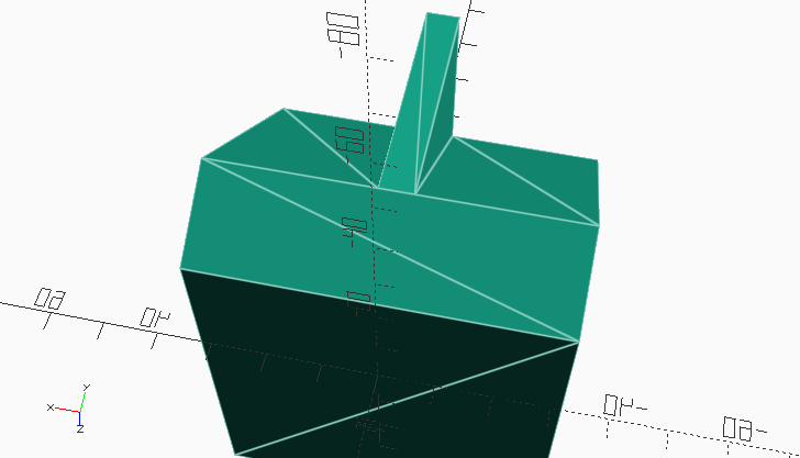

This view shows there are T junctions in the mesh.
The top ridge line needs to be broken where the vane meets it. If it was
there would be three more triangles in the face we are looking down on here.

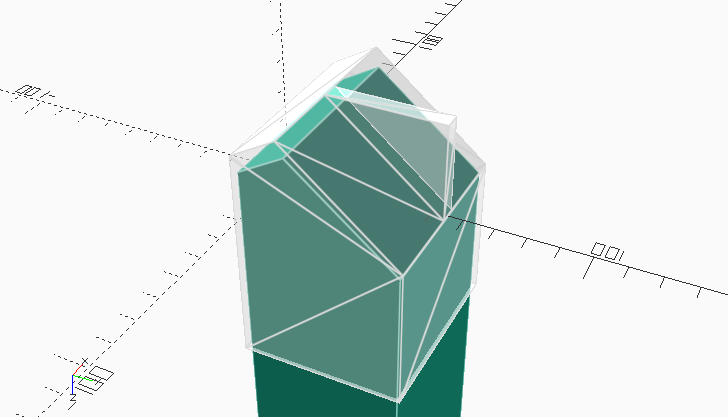

Or maybe not. This transparent view shows there are no shared faces.
On Thu, 20 Jan 2022 at 12:10, nop head nop.head@gmail.com wrote:
My best guess is there are coincident faces in the triangle at the top
when you subtract the two versions of the polyhedron.

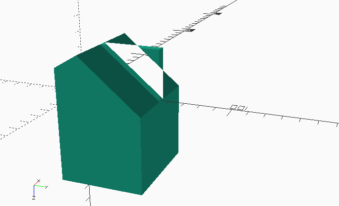

That gives me this, which is clearly broken, even in the preview. Is
that what you see?

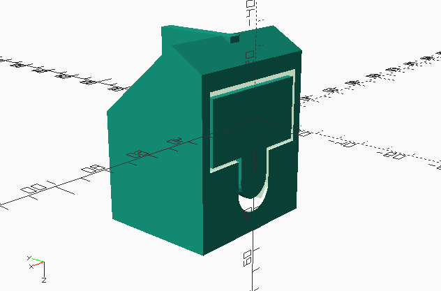

Hello!
thought i should try a smart solution, turns out to be a time hog
:D
a trivial problem, i need a new capsule holder for my
coffeemachine, and i was tinkering around on how to achieve this....
code looks to big to be posted, so i put it up on git:
https://github.com/nohkumado/openscad-nespresso
i added the (hand drawing) of the polyhedron i try to achieve,
the pre-render is perfectly fine, but as soon as i compile it it says:
CGAL_Nef_Polyhedron.
Geometries in cache: 4
so i am puzzled, first of all there should be only 1 geometry,
and that error message is not really help full, since i don't know how to
find out what's going wrong? and i would like to know how to debug
something like that?
if we consider the failing thing:
schachtel(typ=typ, xcenter = true, wd= wd, renfort=true, h=50);
color("red")
translate([0,0,wd]) schachtel(typ=typ, xcenter = true, wd=
0, renfort=false);
each of the subelements compiles fine, the upper box is bigger
than the diff i try to achieve, but as soon as i do the diff some spourious
polygon appears in the preview at the back of the thing, and it doesn't
compile anymore.... invalidating the standing fin, solves it, and i could
use a cube to emulate it (as done in halter2), but that's unsatisfactory :D
i would really like to know why or how this goes wrong and how to find out
what is going wrong (in order to stop bothering all of you)?
thanks in advance for any insight!
ciao
Bruno

This view shows there are T junctions in the mesh. [image: image.png] The top ridge line needs to be broken where the vane meets it. If it was there would be three more triangles in the face we are looking down on here. On Thu, 20 Jan 2022 at 12:34, nop head <nop.head@gmail.com> wrote: > Does the triangular vane on the top share edges with the face it sits on? > > On Thu, 20 Jan 2022 at 12:21, nop head <nop.head@gmail.com> wrote: > >> Or maybe not. This transparent view shows there are no shared faces. >> >> [image: image.png] >> >> On Thu, 20 Jan 2022 at 12:10, nop head <nop.head@gmail.com> wrote: >> >>> My best guess is there are coincident faces in the triangle at the top >>> when you subtract the two versions of the polyhedron. >>> >>> On Thu, 20 Jan 2022 at 12:03, nop head <nop.head@gmail.com> wrote: >>> >>>> That gives me this, which is clearly broken, even in the preview. Is >>>> that what you see? >>>> >>>> [image: image.png] >>>> >>>> On Thu, 20 Jan 2022 at 12:00, Bruno Boettcher <bboett@gmail.com> wrote: >>>> >>>>> ah yes... didn't want something failing in the git, was late last >>>>> night.... >>>>> please also comment line 6 and uncomment line 5..... >>>>> >>>>> Am Do., 20. Jan. 2022 um 12:58 Uhr schrieb Bruno Boettcher < >>>>> bboett@gmail.com>: >>>>> >>>>>> ah yeah..... >>>>>> in the git there's the "working" version, please set on line 26 >>>>>> renfort=true! >>>>>> ciao >>>>>> Bruno >>>>>> >>>>>> Am Do., 20. Jan. 2022 um 12:56 Uhr schrieb nop head < >>>>>> nop.head@gmail.com>: >>>>>> >>>>>>> I don't get any errors. I get >>>>>>> >>>>>>> Top level object is a 3D object: >>>>>>> Simple: yes >>>>>>> Vertices: 118 >>>>>>> Halfedges: 358 >>>>>>> Edges: 179 >>>>>>> Halffacets: 132 >>>>>>> Facets: 66 >>>>>>> Volumes: 3 >>>>>>> >>>>>>> [image: image.png] >>>>>>> >>>>>>> On Thu, 20 Jan 2022 at 11:47, Bruno Boettcher <bboett@gmail.com> >>>>>>> wrote: >>>>>>> >>>>>>>> Yes did that, can't find any purple face nor any hole, but then my >>>>>>>> vision is not the best... >>>>>>>> >>>>>>>> Am Do., 20. Jan. 2022 um 12:44 Uhr schrieb nop head < >>>>>>>> nop.head@gmail.com>: >>>>>>>> >>>>>>>>> Have you tried View / Thrown Together mode and looked for purple >>>>>>>>> faces? You should not be able to see any purple on a closed polygon. If it >>>>>>>>> has a hole, or any faces are inside out, you will see purple. >>>>>>>>> >>>>>>>>> On Thu, 20 Jan 2022 at 11:40, Bruno Boettcher <bboett@gmail.com> >>>>>>>>> wrote: >>>>>>>>> >>>>>>>>>> Hello! >>>>>>>>>> >>>>>>>>>> thought i should try a smart solution, turns out to be a time hog >>>>>>>>>> :D >>>>>>>>>> a trivial problem, i need a new capsule holder for my >>>>>>>>>> coffeemachine, and i was tinkering around on how to achieve this.... >>>>>>>>>> >>>>>>>>>> code looks to big to be posted, so i put it up on git: >>>>>>>>>> https://github.com/nohkumado/openscad-nespresso >>>>>>>>>> >>>>>>>>>> i added the (hand drawing) of the polyhedron i try to achieve, >>>>>>>>>> the pre-render is perfectly fine, but as soon as i compile it it says: >>>>>>>>>> >>>>>>>>>> ERROR: The given mesh is not closed! Unable to convert to >>>>>>>>>> CGAL_Nef_Polyhedron. >>>>>>>>>> Geometries in cache: 4 >>>>>>>>>> >>>>>>>>>> so i am puzzled, first of all there should be only 1 geometry, >>>>>>>>>> and that error message is not really help full, since i don't know how to >>>>>>>>>> find out what's going wrong? and i would like to know how to debug >>>>>>>>>> something like that? >>>>>>>>>> >>>>>>>>>> if we consider the failing thing: >>>>>>>>>> difference() >>>>>>>>>> { >>>>>>>>>> schachtel(typ=typ, xcenter = true, wd= wd, renfort=true, h=50); >>>>>>>>>> color("red") >>>>>>>>>> translate([0,0,wd]) schachtel(typ=typ, xcenter = true, wd= >>>>>>>>>> 0, renfort=false); >>>>>>>>>> } >>>>>>>>>> >>>>>>>>>> each of the subelements compiles fine, the upper box is bigger >>>>>>>>>> than the diff i try to achieve, but as soon as i do the diff some spourious >>>>>>>>>> polygon appears in the preview at the back of the thing, and it doesn't >>>>>>>>>> compile anymore.... invalidating the standing fin, solves it, and i could >>>>>>>>>> use a cube to emulate it (as done in halter2), but that's unsatisfactory :D >>>>>>>>>> i would really like to know why or how this goes wrong and how to find out >>>>>>>>>> what is going wrong (in order to stop bothering all of you)? >>>>>>>>>> >>>>>>>>>> thanks in advance for any insight! >>>>>>>>>> >>>>>>>>>> -- >>>>>>>>>> ciao >>>>>>>>>> Bruno >>>>>>>>>> >>>>>>>>>> =========================================== >>>>>>>>>> http://nohkumado.eu/, <http://bboett.free.fr>http://aikido.nohkumado.eu/, >>>>>>>>>> <http://bboett.free.fr> >>>>>>>>>> http://aikido.zorn.free.fr >>>>>>>>>> _______________________________________________ >>>>>>>>>> OpenSCAD mailing list >>>>>>>>>> To unsubscribe send an email to discuss-leave@lists.openscad.org >>>>>>>>>> >>>>>>>>> _______________________________________________ >>>>>>>>> OpenSCAD mailing list >>>>>>>>> To unsubscribe send an email to discuss-leave@lists.openscad.org >>>>>>>>> >>>>>>>> >>>>>>>> >>>>>>>> -- >>>>>>>> ciao >>>>>>>> Bruno >>>>>>>> >>>>>>>> =========================================== >>>>>>>> http://nohkumado.eu/, <http://bboett.free.fr>http://aikido.nohkumado.eu/, >>>>>>>> <http://bboett.free.fr> >>>>>>>> http://aikido.zorn.free.fr >>>>>>>> _______________________________________________ >>>>>>>> OpenSCAD mailing list >>>>>>>> To unsubscribe send an email to discuss-leave@lists.openscad.org >>>>>>>> >>>>>>> _______________________________________________ >>>>>>> OpenSCAD mailing list >>>>>>> To unsubscribe send an email to discuss-leave@lists.openscad.org >>>>>>> >>>>>> >>>>>> >>>>>> -- >>>>>> ciao >>>>>> Bruno >>>>>> >>>>>> =========================================== >>>>>> http://nohkumado.eu/, <http://bboett.free.fr>http://aikido.nohkumado.eu/, >>>>>> <http://bboett.free.fr> >>>>>> http://aikido.zorn.free.fr >>>>>> >>>>> >>>>> >>>>> -- >>>>> ciao >>>>> Bruno >>>>> >>>>> =========================================== >>>>> http://nohkumado.eu/, <http://bboett.free.fr>http://aikido.nohkumado.eu/, >>>>> <http://bboett.free.fr> >>>>> http://aikido.zorn.free.fr >>>>> _______________________________________________ >>>>> OpenSCAD mailing list >>>>> To unsubscribe send an email to discuss-leave@lists.openscad.org >>>>> >>>>
Thu, Jan 20, 2022 12:41 PM
It seems that some of the polyhedron vertices are on other edges. The
following image shows the polyhedron faces randomly colored. Vertices of
the purple triangular faces fall on edges of green faces which is not legal.
[image: nespresso.PNG]
color("red")
0, renfort=false);

Thu, Jan 20, 2022 1:16 PM
:D ok, i get it why i went to bed with headaches last night :D
at least, i am happy that its a problem, that openscad doesn't show
outright....
and indeed, would be nice if it did! Rogiers idea seems clever enough?
the stuff with the t-junction is not completely clear to me, and taking
into account Ronaldos view, i don't know how the vertices of the vane
couldn't
touch the other faces?
so do i have to split up also the bottom plane? but that would only push
that t-junction problem further to the sides?
split the whole thing on the plane of the vane? a bit overkill, no? is
there a simpler solution?
here.
top

An easier way to make that shape is to linear_extrude polygons, i.e. a pentagon and a triangle. I rarely use polyhedron() unless it is generated by a sweep. On Thu, 20 Jan 2022 at 13:18, Bruno Boettcher <bboett@gmail.com> wrote: > very clever idea! thanks for that one BTW > > Am Do., 20. Jan. 2022 um 13:38 Uhr schrieb nop head <nop.head@gmail.com>: > >> Or maybe not. This transparent view shows there are no shared faces. >> >> [image: image.png] >> >> On Thu, 20 Jan 2022 at 12:10, nop head <nop.head@gmail.com> wrote: >> >>> My best guess is there are coincident faces in the triangle at the top >>> when you subtract the two versions of the polyhedron. >>> >>> On Thu, 20 Jan 2022 at 12:03, nop head <nop.head@gmail.com> wrote: >>> >>>> That gives me this, which is clearly broken, even in the preview. Is >>>> that what you see? >>>> >>>> [image: image.png] >>>> >>>> On Thu, 20 Jan 2022 at 12:00, Bruno Boettcher <bboett@gmail.com> wrote: >>>> >>>>> ah yes... didn't want something failing in the git, was late last >>>>> night.... >>>>> please also comment line 6 and uncomment line 5..... >>>>> >>>>> Am Do., 20. Jan. 2022 um 12:58 Uhr schrieb Bruno Boettcher < >>>>> bboett@gmail.com>: >>>>> >>>>>> ah yeah..... >>>>>> in the git there's the "working" version, please set on line 26 >>>>>> renfort=true! >>>>>> ciao >>>>>> Bruno >>>>>> >>>>>> Am Do., 20. Jan. 2022 um 12:56 Uhr schrieb nop head < >>>>>> nop.head@gmail.com>: >>>>>> >>>>>>> I don't get any errors. I get >>>>>>> >>>>>>> Top level object is a 3D object: >>>>>>> Simple: yes >>>>>>> Vertices: 118 >>>>>>> Halfedges: 358 >>>>>>> Edges: 179 >>>>>>> Halffacets: 132 >>>>>>> Facets: 66 >>>>>>> Volumes: 3 >>>>>>> >>>>>>> [image: image.png] >>>>>>> >>>>>>> On Thu, 20 Jan 2022 at 11:47, Bruno Boettcher <bboett@gmail.com> >>>>>>> wrote: >>>>>>> >>>>>>>> Yes did that, can't find any purple face nor any hole, but then my >>>>>>>> vision is not the best... >>>>>>>> >>>>>>>> Am Do., 20. Jan. 2022 um 12:44 Uhr schrieb nop head < >>>>>>>> nop.head@gmail.com>: >>>>>>>> >>>>>>>>> Have you tried View / Thrown Together mode and looked for purple >>>>>>>>> faces? You should not be able to see any purple on a closed polygon. If it >>>>>>>>> has a hole, or any faces are inside out, you will see purple. >>>>>>>>> >>>>>>>>> On Thu, 20 Jan 2022 at 11:40, Bruno Boettcher <bboett@gmail.com> >>>>>>>>> wrote: >>>>>>>>> >>>>>>>>>> Hello! >>>>>>>>>> >>>>>>>>>> thought i should try a smart solution, turns out to be a time hog >>>>>>>>>> :D >>>>>>>>>> a trivial problem, i need a new capsule holder for my >>>>>>>>>> coffeemachine, and i was tinkering around on how to achieve this.... >>>>>>>>>> >>>>>>>>>> code looks to big to be posted, so i put it up on git: >>>>>>>>>> https://github.com/nohkumado/openscad-nespresso >>>>>>>>>> >>>>>>>>>> i added the (hand drawing) of the polyhedron i try to achieve, >>>>>>>>>> the pre-render is perfectly fine, but as soon as i compile it it says: >>>>>>>>>> >>>>>>>>>> ERROR: The given mesh is not closed! Unable to convert to >>>>>>>>>> CGAL_Nef_Polyhedron. >>>>>>>>>> Geometries in cache: 4 >>>>>>>>>> >>>>>>>>>> so i am puzzled, first of all there should be only 1 geometry, >>>>>>>>>> and that error message is not really help full, since i don't know how to >>>>>>>>>> find out what's going wrong? and i would like to know how to debug >>>>>>>>>> something like that? >>>>>>>>>> >>>>>>>>>> if we consider the failing thing: >>>>>>>>>> difference() >>>>>>>>>> { >>>>>>>>>> schachtel(typ=typ, xcenter = true, wd= wd, renfort=true, h=50); >>>>>>>>>> color("red") >>>>>>>>>> translate([0,0,wd]) schachtel(typ=typ, xcenter = true, wd= >>>>>>>>>> 0, renfort=false); >>>>>>>>>> } >>>>>>>>>> >>>>>>>>>> each of the subelements compiles fine, the upper box is bigger >>>>>>>>>> than the diff i try to achieve, but as soon as i do the diff some spourious >>>>>>>>>> polygon appears in the preview at the back of the thing, and it doesn't >>>>>>>>>> compile anymore.... invalidating the standing fin, solves it, and i could >>>>>>>>>> use a cube to emulate it (as done in halter2), but that's unsatisfactory :D >>>>>>>>>> i would really like to know why or how this goes wrong and how to find out >>>>>>>>>> what is going wrong (in order to stop bothering all of you)? >>>>>>>>>> >>>>>>>>>> thanks in advance for any insight! >>>>>>>>>> >>>>>>>>>> -- >>>>>>>>>> ciao >>>>>>>>>> Bruno >>>>>>>>>> >>>>>>>>>> =========================================== >>>>>>>>>> http://nohkumado.eu/, <http://bboett.free.fr>http://aikido.nohkumado.eu/, >>>>>>>>>> <http://bboett.free.fr> >>>>>>>>>> http://aikido.zorn.free.fr >>>>>>>>>> _______________________________________________ >>>>>>>>>> OpenSCAD mailing list >>>>>>>>>> To unsubscribe send an email to discuss-leave@lists.openscad.org >>>>>>>>>> >>>>>>>>> _______________________________________________ >>>>>>>>> OpenSCAD mailing list >>>>>>>>> To unsubscribe send an email to discuss-leave@lists.openscad.org >>>>>>>>> >>>>>>>> >>>>>>>> >>>>>>>> -- >>>>>>>> ciao >>>>>>>> Bruno >>>>>>>> >>>>>>>> =========================================== >>>>>>>> http://nohkumado.eu/, <http://bboett.free.fr>http://aikido.nohkumado.eu/, >>>>>>>> <http://bboett.free.fr> >>>>>>>> http://aikido.zorn.free.fr >>>>>>>> _______________________________________________ >>>>>>>> OpenSCAD mailing list >>>>>>>> To unsubscribe send an email to discuss-leave@lists.openscad.org >>>>>>>> >>>>>>> _______________________________________________ >>>>>>> OpenSCAD mailing list >>>>>>> To unsubscribe send an email to discuss-leave@lists.openscad.org >>>>>>> >>>>>> >>>>>> >>>>>> -- >>>>>> ciao >>>>>> Bruno >>>>>> >>>>>> =========================================== >>>>>> http://nohkumado.eu/, <http://bboett.free.fr>http://aikido.nohkumado.eu/, >>>>>> <http://bboett.free.fr> >>>>>> http://aikido.zorn.free.fr >>>>>> >>>>> >>>>> >>>>> -- >>>>> ciao >>>>> Bruno >>>>> >>>>> =========================================== >>>>> http://nohkumado.eu/, <http://bboett.free.fr>http://aikido.nohkumado.eu/, >>>>> <http://bboett.free.fr> >>>>> http://aikido.zorn.free.fr >>>>> _______________________________________________ >>>>> OpenSCAD mailing list >>>>> To unsubscribe send an email to discuss-leave@lists.openscad.org >>>>> >>>> _______________________________________________ >> OpenSCAD mailing list >> To unsubscribe send an email to discuss-leave@lists.openscad.org >> > > > -- > ciao > Bruno > > =========================================== > http://nohkumado.eu/, <http://bboett.free.fr>http://aikido.nohkumado.eu/, > <http://bboett.free.fr> > http://aikido.zorn.free.fr > _______________________________________________ > OpenSCAD mailing list > To unsubscribe send an email to discuss-leave@lists.openscad.org >
by a sweep.
h=50);
color("red")
0, renfort=false);

Following nophead's suggestion, module schachtel() might use the following
instead of the polyhedron:
left_face = [ [y0,z0], [y0,z2+lh], [y0+22cos(45),z2+22 ], [y1, z1], [y1,
z0] ];
translate([-x1,0,0])
rotate([0,90,0])
rotate(90)
linear_extrude(2
x1) polygon(left_face);
tri_face = [ [y1, z1], [y1, z2+22], [y0+22*cos(45), z2+22 ] ];
translate([-wd,0,0])
rotate([0,90,0])
rotate(90)
linear_extrude(2*wd) polygon(tri_face);

yes! Ronaldo's writing is eleganter, but i managed in the same time (well
30 min more as is seems) the same type of solution,
and yes, had some trouble with the different angles in the bottom part, but
works ok enough
for what's worth new version also in the git :D
thanks!
