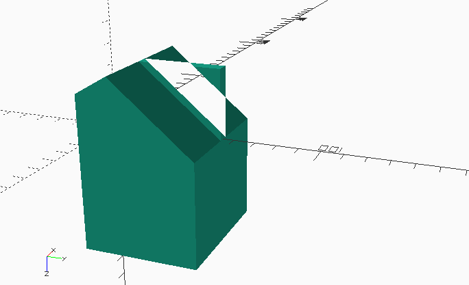

On 1/20/2022 4:03 AM, nop head wrote:
That gives me this, which is clearly broken, even in the preview. Is
that what you see?
Places where from some angles you can see through the model are a dead
giveaway for convexity problems.  Setting convexity=2 in the
polyhedron() call fixes this.
I still think that we should set the default convexity to 10, to make
the vast majority of these problems go away with only a very small
performance hit.
performance hit.
