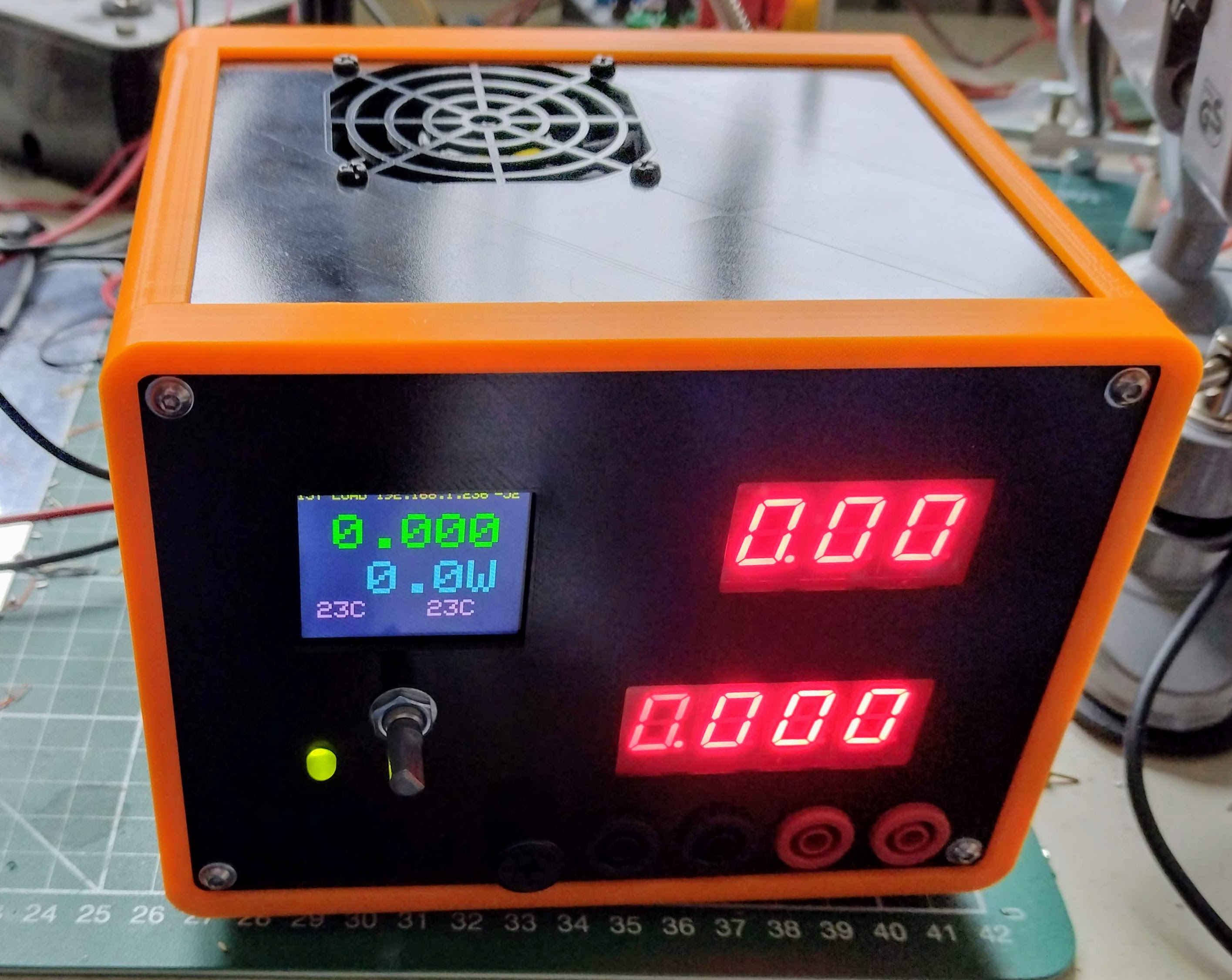

I have disassembled a couple of Chinese solder stations that had dual
potentiometers to set the temperature of the iron and the hot air gun. One
track of the pots simply drove 3 digit voltmeters to display the target
temperature and the other track was an analogue temperature controller.
Crazy.
I repurposed one as an IOT dummy load with autoranging ammeter and
voltmeters.
[image: IMG_20211005_095515156_HDR.jpg]
I used a rotary encoder to change the current setting or I can set it via a
web page or a Python script.
