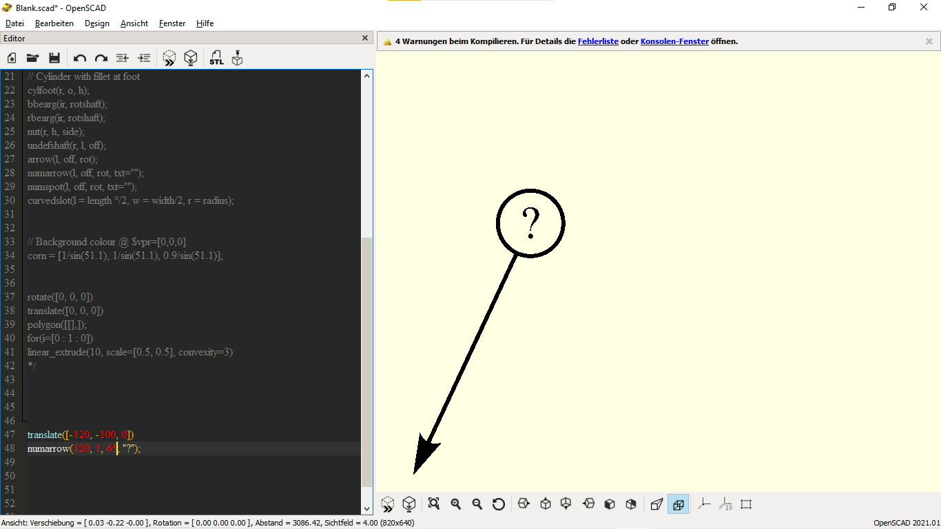

It’s horribly fiddly to open the viewport to a specific width with the mouse/cursor, especially with complicated code. Is there some parameter like $vpr, $vpt, $vpd etc. with which the width can be set in the code window?

Your question is underspecified. What is the thing you want to be a
specific width?
The viewport is a single point camera with adjustable field of view. So
the camera itself has no width. It can look at things which have width.

The viewport is the picture I see.
Sometimes i want it to be 820 pixels wide, sometimes 620.

It’s about the cream-coloured rectangle on the right and the numbers at the bottom below the two cubes.

Sounds to me like Mike wants to be able to dynamically (and
automatically) adjust the size of the viewport based on the size of the
modeled object.

Ah. I'd be surprised if it got added in a way which you could control
from a program, though I could see someone adding a menu entry for it.
You can make feature requests at
https://github.com/openscad/openscad/issues/new/choose but I doubt
anyone else would want to do it.

Done. Let’s see what happens.
