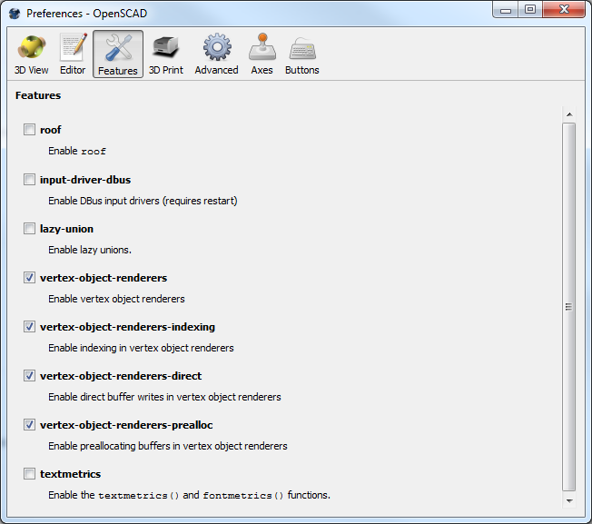

Fri, Jan 14, 2022 10:40 PM
You turn on vbo in Edit/Preferences/Features
Getting fast previews of complex scenes is an art. Union in preview is
free. 3D difference () and intersection() are slow. I tend to wrap those in
render() to get a one off hit.

Fri, Jan 14, 2022 10:57 PM
Yes all experimental features are after the last release, so you need a
more recent development snapshot.
