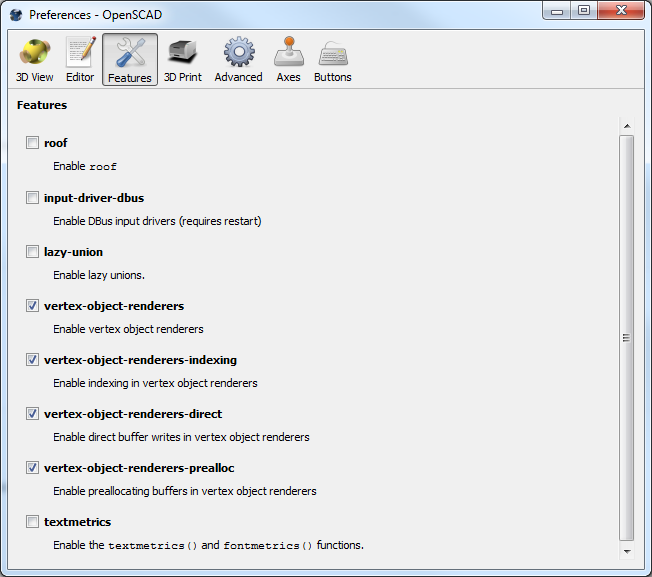

On Fri, Jan 14, 2022 at 4:58 PM nop head nop.head@gmail.com wrote:
Yes all experimental features are after the last release, so you need a
more recent development snapshot.
On Fri, 14 Jan 2022 at 22:55, david vanhorn kc6ete@gmail.com wrote:
That explains why I couldn't find it.
I don't HAVE a "features" tab.
Running 2021.01 here.
On Fri, Jan 14, 2022 at 3:41 PM nop head nop.head@gmail.com wrote:
You turn on vbo in Edit/Preferences/Features
Getting fast previews of complex scenes is an art. Union in preview is
free. 3D difference () and intersection() are slow. I tend to wrap those in
render() to get a one off hit.
