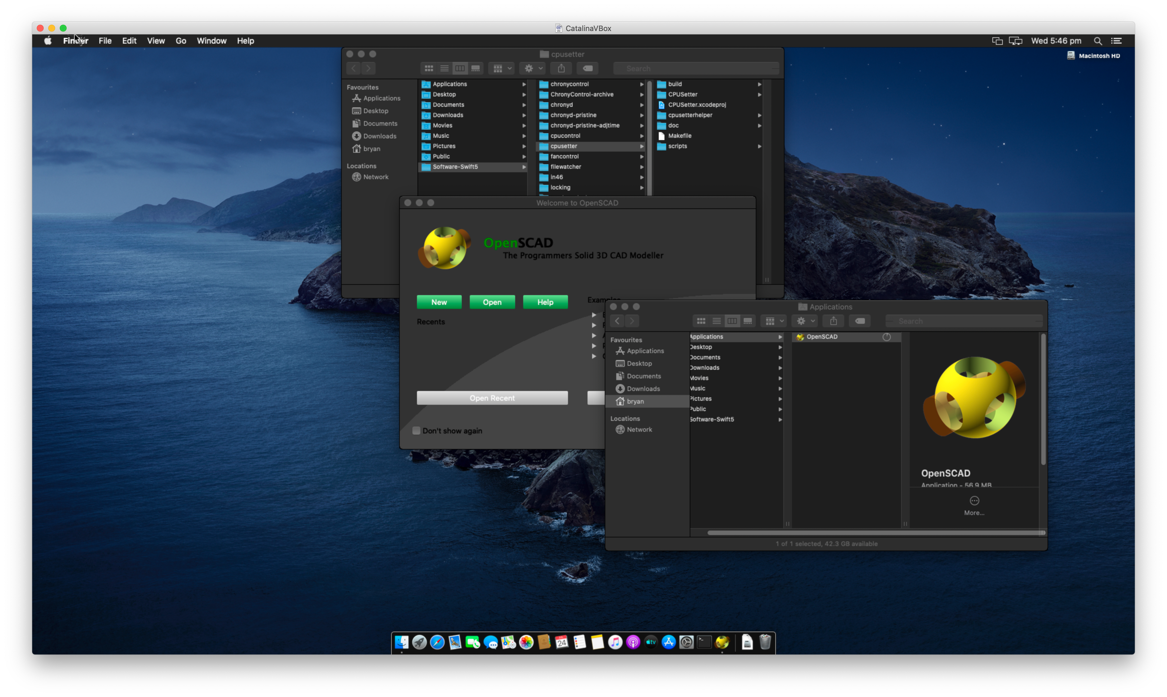

Oh, btw., are you the same Paul Haeberli who used to work at SGI?
I used a font with that name as a terminal font for the longest time in my IRIX and early post-IRIX life :)
-Marius

How to install
  1. Get hold of the Catalina installer
  2. get this app -
    https://www.whatroute.net/installerapp2iso.html https://www.whatroute.net/installerapp2iso.html
  3. Use it to generate an ISO and a VBox disk image (its needs fancy stuff in its EFI partition - the app takes care of that)
    Make the virtual disk at least 60GB
    Create a new VM in Virtual box - but use the disk virtual disk previously created - and the ISO image.
    Run the VM and install Catalina onto your new virtual disk
    when it’s up and running, you’ll find you cant use the mouse to drag windows.
    a) Use screensharing to connect to the VM
    b - alternatively, have the VM capture a USB mouse.
it sounds tricky but is not actually that hard to do
The Virtual Box forum is good for further assistance.
https://forums.virtualbox.org/viewforum.php?f=22&sid=6c8731bdf5fbb8437f6bdacb49ba9f29 <https://forums.virtualbox.org/viewforum.php?f=22&sid=6c8731bdf5fbb8437f6bdacb49ba9f29>
There are instructions for Mojave/Mojave here:
https://www.whatroute.net/installerapp2iso.html <https://www.whatroute.net/installerapp2iso.html>
Apart from the mouse stuff, Catalina is not much different

Holding down the ctrl key while clicking on OpenSCAD should launch and bring up an “open” dialog.
Here’s a screen cap of the successful launch of OpenSCAD on Catalina….
Code signing and notarization is going to be an ongoing issue and we’ll probably need to pop for the $100 annual developer account if we want this to ever go away.
