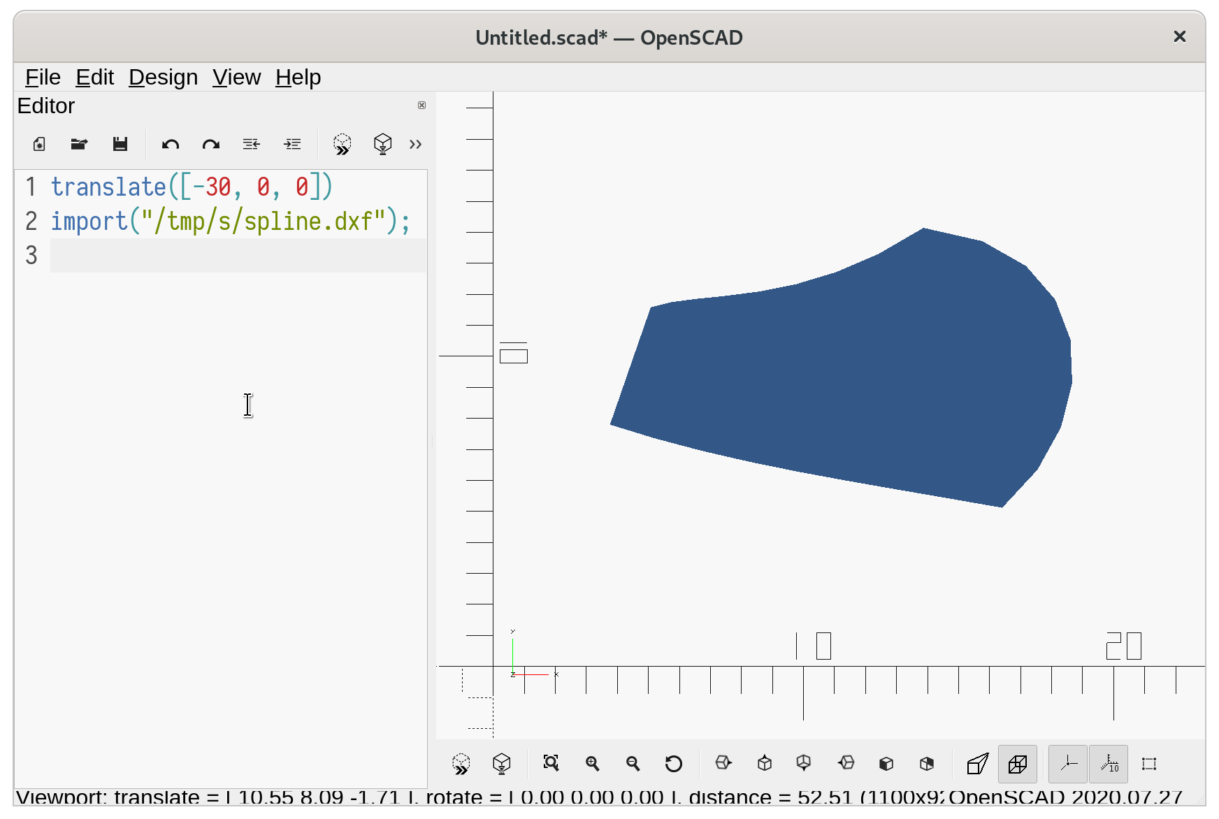

Tue, Jul 28, 2020 10:58 PM
On 29.07.20 00:43, cbernhardt wrote:
Here is a ZIP file with spline.dxf, spline.jpg, and spline.txt with
coordinates and explanation.
Thanks, that might help clarifying some details. It's currently
trying but not quite getting the correct result for this file.
So far the only test was a simple spline created in LibreCAD
and that looked ok.
On 29.07.20 00:43, cbernhardt wrote: > Here is a ZIP file with spline.dxf, spline.jpg, and spline.txt with > coordinates and explanation. Thanks, that might help clarifying some details. It's currently trying but not quite getting the correct result for this file. So far the only test was a simple spline created in LibreCAD and that looked ok. ciao, Torsten.
