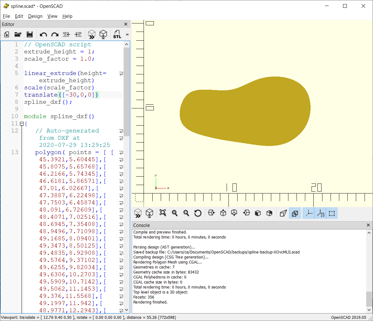

Here is my effort today trying to implement SPLINE in dxfread and
converting it to OpenSCAD.
It sort of works, but splines are far from well defined in DXF, it is
not at all clear how the "control points" are supposed to help, and the
same goes for the "knot values". I used the "fit points" to get the best
result matching the green spline in the original drawing provided by
cbernhardt.
Also, getting the boundary conditions right is not easy (and again the
DXF definition is not clear) so I applied a little work-around based on
the "periodic" setting for the spline to get something that looks right.
See attached PNG and generated .scad file.
P.S: This feature is not available in yesterday's released version of
dxfread, I implemented the feature based on today's example.

Here is a comparison of your spline to the original in the spline.dxf file.
http://forum.openscad.org/file/t1309/spline2.jpg
cacb wrote > Here is my effort today trying to implement SPLINE in dxfread and > converting it to OpenSCAD. > > It sort of works, but splines are *far* from well defined in DXF, it is > not at all clear how the "control points" are supposed to help, and the > same goes for the "knot values". I used the "fit points" to get the best > result matching the green spline in the original drawing provided by > cbernhardt. > > Also, getting the boundary conditions right is not easy (and again the > DXF definition is not clear) so I applied a little work-around based on > the "periodic" setting for the spline to get something that looks right. > > See attached PNG and generated .scad file. > > P.S: This feature is not available in yesterday's released version of > dxfread, I implemented the feature based on today's example. > > Carsten Arnholm Here is a comparison of your spline to the original in the spline.dxf file. <http://forum.openscad.org/file/t1309/spline2.jpg> -- Sent from: http://forum.openscad.org/
CA
Wed, Jul 29, 2020 1:22 PM
The difference is probably due to my difficulty applying the boundary
conditions correctly, whatever the correct procedure is. Oh well, such
things happen when the definition is unclear.
Regards
Carsten Arholm
Discuss@lists.openscad.org <mailto:Discuss@lists.openscad.org> <mailto:Discuss@lists.openscad.org <mailto:Discuss@lists.openscad.org>>
http://lists.openscad.org/mailman/listinfo/discuss_lists.openscad.org <http://lists.openscad.org/mailman/listinfo/discuss_lists.openscad.org>
If splines in DXF have knots, then it’s definitely using the more complex NURBS type splines, as Bezier’s of any degree don’t need knots. https://en.wikipedia.org/wiki/Non-uniform_rational_B-spline <https://en.wikipedia.org/wiki/Non-uniform_rational_B-spline> One nice thing about NURBS is that you can exactly model circular arcs, with the right knot vector. - Revar > On Jul 29, 2020, at 5:41 AM, Tim V. Shaporev <tim.shaporev@auriga.ru> wrote: > > If my memory serves me right, AutoCAD splines are arbitrary order NURBS i.e. the curve order is specified and (in theory) may be bigger than 3. > > On 7/29/2020 3:06 PM, A. Craig West wrote: >> I would expect that if it has control points and knot points, the expected implementation is a cubic bezier, which is very well defined, and quite easy to implement in OpenScad >> On Wed, 29 Jul 2020, 07:48 Carsten Arnholm, <arnholm@arnholm.org <mailto:arnholm@arnholm.org> <mailto:arnholm@arnholm.org <mailto:arnholm@arnholm.org>>> wrote: >> On 29.07.2020 00:58, Torsten Paul wrote: >> > On 29.07.20 00:43, cbernhardt wrote: >> >> Here is a ZIP file with spline.dxf, spline.jpg, and spline.txt with >> >> coordinates and explanation. >> > >> > Thanks, that might help clarifying some details. It's currently >> > trying but not quite getting the correct result for this file. >> > >> Here is my effort today trying to implement SPLINE in dxfread and >> converting it to OpenSCAD. >> It sort of works, but splines are *far* from well defined in DXF, it is >> not at all clear how the "control points" are supposed to help, and the >> same goes for the "knot values". I used the "fit points" to get the >> best >> result matching the green spline in the original drawing provided by >> cbernhardt. >> Also, getting the boundary conditions right is not easy (and again the >> DXF definition is not clear) so I applied a little work-around based on >> the "periodic" setting for the spline to get something that looks right. >> See attached PNG and generated .scad file. >> P.S: This feature is not available in yesterday's released version of >> dxfread, I implemented the feature based on today's example. >> Carsten Arnholm >> _______________________________________________ >> OpenSCAD mailing list >> Discuss@lists.openscad.org <mailto:Discuss@lists.openscad.org> <mailto:Discuss@lists.openscad.org <mailto:Discuss@lists.openscad.org>> >> http://lists.openscad.org/mailman/listinfo/discuss_lists.openscad.org <http://lists.openscad.org/mailman/listinfo/discuss_lists.openscad.org> >> _______________________________________________ >> OpenSCAD mailing list >> Discuss@lists.openscad.org <mailto:Discuss@lists.openscad.org> >> http://lists.openscad.org/mailman/listinfo/discuss_lists.openscad.org <http://lists.openscad.org/mailman/listinfo/discuss_lists.openscad.org> > > > _______________________________________________ > OpenSCAD mailing list > Discuss@lists.openscad.org <mailto:Discuss@lists.openscad.org> > http://lists.openscad.org/mailman/listinfo/discuss_lists.openscad.org <http://lists.openscad.org/mailman/listinfo/discuss_lists.openscad.org>
