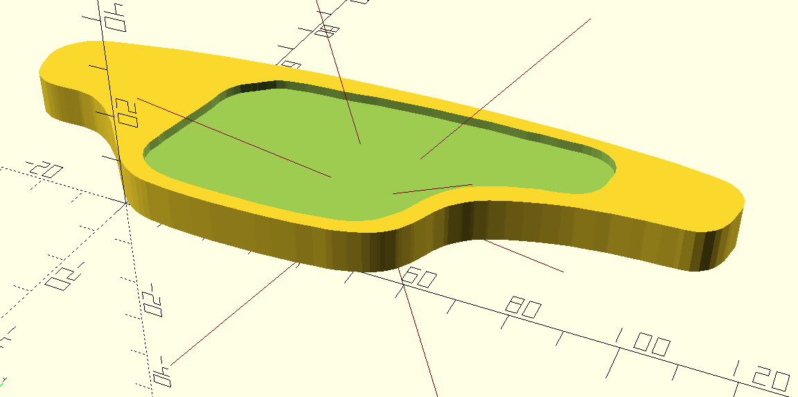

I have a car with paddle shifters (thin, flat metal plates with a curved
periphery).  The car came with some paddle shifter "extensions" which
sit behind the paddles (towards the front of the car, but "behind" the
paddles from where I sit to drive). Think of the extensions as flat
parts which are larger than the actual paddles, with a paddle-shaped
indentation into which the paddles sit.  They are only attached with
glue, and one came off the day I bought the car (used).  I tried to
re-attach it with double-sided sticky tape, but that failed after a few
weeks, so I am done with glue.
What I want to do is 1) design a part that is identical to the original
extension and then 2) add flexible "lips" to go around the paddle
shifter to hold the extension in place.
I can do (1) by photographing it and determining a series of points to
specify the outer and inner shapes (1A).  This is easy to do
approximately (and I have done so), but doing it accurately would take
some time fiddling with the point list.
I could also do (1) by scanning the part (also done) (1B).
Although the above for (1) is a little challenging, the real challenge
is how to create (2), the "lips" that wrap around the edge of the
paddles to keep the extension in place.  The lips must curve around the
inner shape (the one that defines the outside of the indentation).
I imagine that scanning (1B) will solve (1) but not help at all with
(2).  If I use the hand-crafted points approach (1B), then at least I
have a defined curve around which I can sweep the lip cross-section.
Any thoughts or comments?

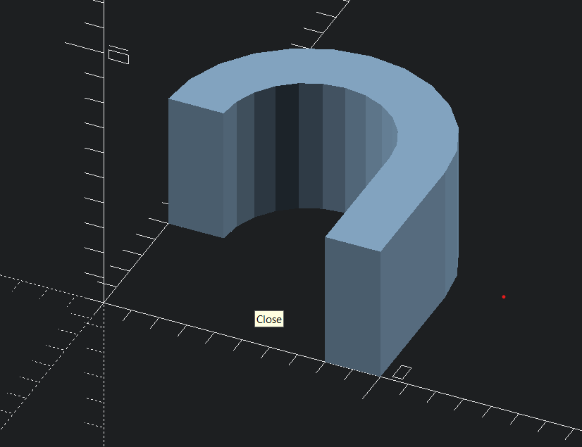

Modeling the lips should be fairly straightforward using linear_extrude of
a J shaped 2D shape.  If I get time today I'll try to make an example.

This is not elegant, just stream-of-consciousness coding.
$fn=24;
lipInnerRadius = 3;
lipThickness = 2;
lipWidth = 5;
lipBaseLength = 5;
linear_extrude(lipWidth)
translate([lipInnerRadius+lipThickness,0])
union()
translate([0, lipBaseLength])
intersection()
translate([-lipInnerRadius-lipThickness,0])
square([ 20,20]);
  circle(r = lipInnerRadius+lipThickness);
  circle(r = lipInnerRadius);
translate([lipInnerRadius,0])
square([lipThickness,lipBaseLength]);

This is not elegant, just stream-of-consciousness coding. [image: image.png] $fn=24; lipInnerRadius = 3; lipThickness = 2; lipWidth = 5; lipBaseLength = 5; linear_extrude(lipWidth) translate([lipInnerRadius+lipThickness,0]) union() { translate([0, lipBaseLength]) intersection() { translate([-lipInnerRadius-lipThickness,0]) square([ 20,20]); difference() { circle(r = lipInnerRadius+lipThickness); circle(r = lipInnerRadius); } } translate([lipInnerRadius,0]) square([lipThickness,lipBaseLength]); } On Sat, May 11, 2024 at 7:51 AM gene heskett via Discuss < discuss@lists.openscad.org> wrote: > On 5/11/24 08:24, Jon Bondy via Discuss wrote: > > Brainstorming, here... > > > > I have a car with paddle shifters (thin, flat metal plates with a curved > > periphery). The car came with some paddle shifter "extensions" which > > sit behind the paddles (towards the front of the car, but "behind" the > > paddles from where I sit to drive). Think of the extensions as flat > > parts which are larger than the actual paddles, with a paddle-shaped > > indentation into which the paddles sit. They are only attached with > > glue, and one came off the day I bought the car (used). I tried to > > re-attach it with double-sided sticky tape, but that failed after a few > > weeks, so I am done with glue. > > > > What I want to do is 1) design a part that is identical to the original > > extension and then 2) add flexible "lips" to go around the paddle > > shifter to hold the extension in place. > > > > I can do (1) by photographing it and determining a series of points to > > specify the outer and inner shapes (1A). This is easy to do > > approximately (and I have done so), but doing it accurately would take > > some time fiddling with the point list. > > > > I could also do (1) by scanning the part (also done) (1B). > > > > Although the above for (1) is a little challenging, the real challenge > > is how to create (2), the "lips" that wrap around the edge of the > > paddles to keep the extension in place. The lips must curve around the > > inner shape (the one that defines the outside of the indentation). > > > > I imagine that scanning (1B) will solve (1) but not help at all with > > (2). If I use the hand-crafted points approach (1B), then at least I > > have a defined curve around which I can sweep the lip cross-section. > > > > Any thoughts or comments? > W/o seeing examples 1A and 1B, this is a hard thing to > visualize/analyze. Did you forget to attach those files or pix? > > > > Thanks! > > > > Jon > > > > > > Cheers, Gene Heskett, CET. > -- > "There are four boxes to be used in defense of liberty: > soap, ballot, jury, and ammo. Please use in that order." > -Ed Howdershelt (Author, 1940) > If we desire respect for the law, we must first make the law respectable. > - Louis D. Brandeis > _______________________________________________ > OpenSCAD mailing list > To unsubscribe send an email to discuss-leave@lists.openscad.org >
Sat, May 11, 2024 2:21 PM
Yep.  That was where I was heading for the cross-section of the "lips"!
$fn=24;
lipInnerRadius = 3;
lipThickness = 2;
lipWidth = 5;
lipBaseLength = 5;
union()
intersection()
square([ 20,20]);

Yep.  That was where I was heading for the cross-section of the "lips"! On 5/11/2024 9:44 AM, Leonard Martin Struttmann via Discuss wrote: > This is not elegant, just stream-of-consciousness coding. > > > image.png > > $fn=24; > lipInnerRadius = 3; > lipThickness = 2; > lipWidth = 5; > lipBaseLength = 5; > linear_extrude(lipWidth) > translate([lipInnerRadius+lipThickness,0]) > union() > { > translate([0, lipBaseLength]) > intersection() >   { > translate([-lipInnerRadius-lipThickness,0]) > square([ 20,20]); > difference() >     { > circle(r = lipInnerRadius+lipThickness); > circle(r = lipInnerRadius); >     } >   } > translate([lipInnerRadius,0]) > square([lipThickness,lipBaseLength]); > } > > On Sat, May 11, 2024 at 7:51 AM gene heskett via Discuss > <discuss@lists.openscad.org> wrote: > > On 5/11/24 08:24, Jon Bondy via Discuss wrote: > > Brainstorming, here... > > > > I have a car with paddle shifters (thin, flat metal plates with > a curved > > periphery).  The car came with some paddle shifter "extensions" > which > > sit behind the paddles (towards the front of the car, but > "behind" the > > paddles from where I sit to drive). Think of the extensions as flat > > parts which are larger than the actual paddles, with a > paddle-shaped > > indentation into which the paddles sit.  They are only attached > with > > glue, and one came off the day I bought the car (used). I tried to > > re-attach it with double-sided sticky tape, but that failed > after a few > > weeks, so I am done with glue. > > > > What I want to do is 1) design a part that is identical to the > original > > extension and then 2) add flexible "lips" to go around the paddle > > shifter to hold the extension in place. > > > > I can do (1) by photographing it and determining a series of > points to > > specify the outer and inner shapes (1A).  This is easy to do > > approximately (and I have done so), but doing it accurately > would take > > some time fiddling with the point list. > > > > I could also do (1) by scanning the part (also done) (1B). > > > > Although the above for (1) is a little challenging, the real > challenge > > is how to create (2), the "lips" that wrap around the edge of the > > paddles to keep the extension in place.  The lips must curve > around the > > inner shape (the one that defines the outside of the indentation). > > > > I imagine that scanning (1B) will solve (1) but not help at all > with > > (2).  If I use the hand-crafted points approach (1B), then at > least I > > have a defined curve around which I can sweep the lip cross-section. > > > > Any thoughts or comments? > W/o seeing examples 1A and 1B, this is a hard thing to > visualize/analyze. Did you forget to attach those files or pix? > > > > Thanks! > > > > Jon > > > > > > Cheers, Gene Heskett, CET. > -- > "There are four boxes to be used in defense of liberty: >   soap, ballot, jury, and ammo. Please use in that order." > -Ed Howdershelt (Author, 1940) > If we desire respect for the law, we must first make the law > respectable. >   - Louis D. Brandeis > _______________________________________________ > OpenSCAD mailing list > To unsubscribe send an email to discuss-leave@lists.openscad.org > > > _______________________________________________ > OpenSCAD mailing list > To unsubscribe send an email todiscuss-leave@lists.openscad.org -- This email has been checked for viruses by AVG antivirus software. www.avg.com
Sat, May 11, 2024 2:29 PM
Maybe this non-manifold STL will help everyone envision the shape better.

Maybe this non-manifold STL will help everyone envision the shape better. On 5/11/2024 8:42 AM, Adrian Mariano via Discuss wrote: > Perhaps a better choice of glue could work? > > I don't understand your problem at all from the description.  To me it > sounds like your challenge is creating the "lips", but I don't > understand enough about the geometry to know how hard this is.  Like > would sweeping a lip cross section along a planar curve work?  Or is > the curve not planar (which creates twist issues)?  Or does the lip > need to change across the sweep because the shape it's mating to changes? > > On Sat, May 11, 2024 at 8:24 AM Jon Bondy via Discuss > <discuss@lists.openscad.org> wrote: > > Brainstorming, here... > > I have a car with paddle shifters (thin, flat metal plates with a > curved > periphery).  The car came with some paddle shifter "extensions" which > sit behind the paddles (towards the front of the car, but "behind" > the > paddles from where I sit to drive). Think of the extensions as flat > parts which are larger than the actual paddles, with a paddle-shaped > indentation into which the paddles sit.  They are only attached with > glue, and one came off the day I bought the car (used).  I tried to > re-attach it with double-sided sticky tape, but that failed after > a few > weeks, so I am done with glue. > > What I want to do is 1) design a part that is identical to the > original > extension and then 2) add flexible "lips" to go around the paddle > shifter to hold the extension in place. > > I can do (1) by photographing it and determining a series of > points to > specify the outer and inner shapes (1A).  This is easy to do > approximately (and I have done so), but doing it accurately would > take > some time fiddling with the point list. > > I could also do (1) by scanning the part (also done) (1B). > > Although the above for (1) is a little challenging, the real > challenge > is how to create (2), the "lips" that wrap around the edge of the > paddles to keep the extension in place.  The lips must curve > around the > inner shape (the one that defines the outside of the indentation). > > I imagine that scanning (1B) will solve (1) but not help at all with > (2).  If I use the hand-crafted points approach (1B), then at least I > have a defined curve around which I can sweep the lip cross-section. > > Any thoughts or comments? > > Thanks! > > Jon > > > -- > This email has been checked for viruses by AVG antivirus software. > www.avg.com <http://www.avg.com> > _______________________________________________ > OpenSCAD mailing list > To unsubscribe send an email to discuss-leave@lists.openscad.org > > > _______________________________________________ > OpenSCAD mailing list > To unsubscribe send an email todiscuss-leave@lists.openscad.org
JJ
jon jonbondy.com
Sat, May 11, 2024 2:40 PM
You will notice that the object in the STL in the previous message is actually not flat: it appears to be wrapped around the surface of a fairly large sphere (diameter 10" or 20"?).
Are there any BOSL2 facilities that would take an object and warp it in this manner?  Since I have explicit 2D points lists, all I would really need to do is add a 3rd dimension I suppose.
This is what I have at the moment:
[cid:part1.LNY9rd0t.X04SRW9X@jonbondy.com]
Then there is the question of how to make a shape with rounded edges that is also curved in this way (onto the sphere).
On 5/11/2024 10:29 AM, Jon Bondy via Discuss wrote:

You will notice that the object in the STL in the previous message is actually not flat: it appears to be wrapped around the surface of a fairly large sphere (diameter 10" or 20"?). Are there any BOSL2 facilities that would take an object and warp it in this manner? Since I have explicit 2D points lists, all I would really need to do is add a 3rd dimension I suppose. This is what I have at the moment: [cid:part1.LNY9rd0t.X04SRW9X@jonbondy.com] Then there is the question of how to make a shape with rounded edges that is also curved in this way (onto the sphere). Jon On 5/11/2024 10:29 AM, Jon Bondy via Discuss wrote: Maybe this non-manifold STL will help everyone envision the shape better. On 5/11/2024 8:42 AM, Adrian Mariano via Discuss wrote: Perhaps a better choice of glue could work? I don't understand your problem at all from the description. To me it sounds like your challenge is creating the "lips", but I don't understand enough about the geometry to know how hard this is. Like would sweeping a lip cross section along a planar curve work? Or is the curve not planar (which creates twist issues)? Or does the lip need to change across the sweep because the shape it's mating to changes? On Sat, May 11, 2024 at 8:24 AM Jon Bondy via Discuss <discuss@lists.openscad.org<mailto:discuss@lists.openscad.org>> wrote: Brainstorming, here... I have a car with paddle shifters (thin, flat metal plates with a curved periphery). The car came with some paddle shifter "extensions" which sit behind the paddles (towards the front of the car, but "behind" the paddles from where I sit to drive). Think of the extensions as flat parts which are larger than the actual paddles, with a paddle-shaped indentation into which the paddles sit. They are only attached with glue, and one came off the day I bought the car (used). I tried to re-attach it with double-sided sticky tape, but that failed after a few weeks, so I am done with glue. What I want to do is 1) design a part that is identical to the original extension and then 2) add flexible "lips" to go around the paddle shifter to hold the extension in place. I can do (1) by photographing it and determining a series of points to specify the outer and inner shapes (1A). This is easy to do approximately (and I have done so), but doing it accurately would take some time fiddling with the point list. I could also do (1) by scanning the part (also done) (1B). Although the above for (1) is a little challenging, the real challenge is how to create (2), the "lips" that wrap around the edge of the paddles to keep the extension in place. The lips must curve around the inner shape (the one that defines the outside of the indentation). I imagine that scanning (1B) will solve (1) but not help at all with (2). If I use the hand-crafted points approach (1B), then at least I have a defined curve around which I can sweep the lip cross-section. Any thoughts or comments? Thanks! Jon -- This email has been checked for viruses by AVG antivirus software. www.avg.com<http://www.avg.com> _______________________________________________ OpenSCAD mailing list To unsubscribe send an email to discuss-leave@lists.openscad.org<mailto:discuss-leave@lists.openscad.org> _______________________________________________ OpenSCAD mailing list To unsubscribe send an email to discuss-leave@lists.openscad.org<mailto:discuss-leave@lists.openscad.org> [https://s-install.avcdn.net/ipm/preview/icons/icon-envelope-tick-green-avg-v1.png]<http://www.avg.com/email-signature?utm_medium=email&utm_source=link&utm_campaign=sig-email&utm_content=emailclient> Virus-free.www.avg.com<http://www.avg.com/email-signature?utm_medium=email&utm_source=link&utm_campaign=sig-email&utm_content=emailclient> _______________________________________________ OpenSCAD mailing list To unsubscribe send an email to discuss-leave@lists.openscad.org<mailto:discuss-leave@lists.openscad.org>

Sat, May 11, 2024 4:17 PM
Taking a flat object and mapping it to a sphere is not a well-defined
operation.  BOSL2 does not provide a feature like this.  It can wrap things
around cylinders, but that is a well-defined process.  Think about the
problem of map projections.  If you want to map an object to there sphere
there will be multiple ways to do it depending on how you distort your
object in the mapping.
But if you want to try the easiest thing and if you have your data as
points you can put it onto a sphere directly by computing z coordinates
that are on the sphere.  The simplest scheme would be to just project it
along the z axis onto a sphere, e.g. using the formula z_warped =
sqrt(r^2-x^2-y^2)+z.
You can probably warp the lip this way if you make it using path_sweep and
get the VNF out and then warp the points component of the VNF.  (The faces
won't change.)
On Sat, May 11, 2024 at 10:41 AM jon jonbondy.com via Discuss <
