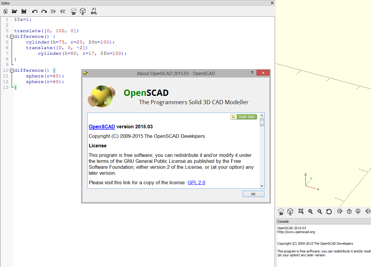

Mon, Mar 16, 2015 3:13 PM
The following code crashed F6 after perhaps 45 minutes, consuming 1.7 GB
of RAM.  It renders in under 1 second using F5. I realize that it is a
bizarre case.  I only submit it because it demonstrates a way to have F5
work but F6 crash on my machine.  I look forward to others trying it.
$fa=1;
translate([0, 100, 0])
cylinder(h=75, r=20, $fn=100);
translate([0, 0, -2])
cylinder(h=80, r=17, $fn=100);
sphere(r=45);
sphere(r=40);
On 3/16/2015 9:36 AM, jon wrote:

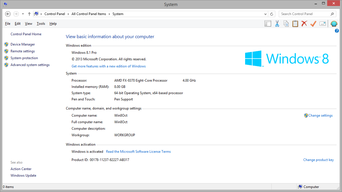

Mon, Mar 16, 2015 3:33 PM
See screen shot of Help, About for OpenSCAD release I am running, and
screen shot of Windows info about my computer (OS, 64-bit, RAM, etc).
Not sure how to prove that the OpenSCAD I'm running is the 64-bit
version; it installed in Program Files (rather than Program Files
(x86)).  Note that previous crashes occurred around 300 MB of RAM (but,
of course, this crash could be due to something else going on).
If you can render this using F6 in 2 seconds, and it takes 45 minutes
here before it crashes, then something very strange is going on.  I know
that at one point I considered the new code to be MUCH faster than the
old.  That seems to have changed here.  I have NO idea why.
Thanks for your help!

On 3/16/2015 11:20 AM, Marius Kintel wrote:
On Mar 16, 2015, at 11:13 AM, jon jon@jonbondy.com wrote:
The following code crashed F6 after perhaps 45 minutes, consuming 1.7 GB of RAM.  It renders in under 1 second using F5. I realize that it is a bizarre case.  I only submit it because it demonstrates a way to have F5 work but F6 crash on my machine.  I look forward to others trying it.
That’s bizarre indeed. It renders in 1m5s here.
Just to recap: Is this the 64-bit official 2015.03 binary, running on 64-bit Win 8.1 in Win 8 compatibility mode?
Could just paste the output of Help->Library Info just so we have all the details?
-Marius

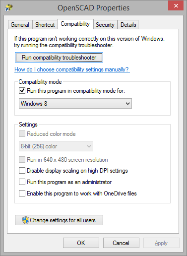

I'm not clear about the Windows 8 compatibility mode that's noted above.
Is that something you're setting in the properties of the openscad.exe file?
--tim
screen shot of Windows info about my computer (OS, 64-bit, RAM, etc).  Not
sure how to prove that the OpenSCAD I'm running is the 64-bit version; it
installed in Program Files (rather than Program Files (x86)).  Note that
previous crashes occurred around 300 MB of RAM (but, of course, this crash

Mon, Mar 16, 2015 6:05 PM
I hope the attached screen shot helps.  Right click, select Properties,
go to the Compatibility tab.  Not at all sure this is necessary, but I
thought it was necessary a few weeks ago.
 and screen shot of Windows info about my computer (OS, 64-bit,
 RAM, etc).  Not sure how to prove that the OpenSCAD I'm running is
 the 64-bit version; it installed in Program Files (rather than
 Program Files (x86)).  Note that previous crashes occurred around
 300 MB of RAM (but, of course, this crash could be due to

 Here is Help, Library Info:
 OpenSCAD Version: 2015.03
 System information: Windows 8.1 (v6.3.0.0) 8 CPUs 7.90 GB RAM
 Compiler, build date: GCC "4.9.2" 64bit, Mar 10 2015
