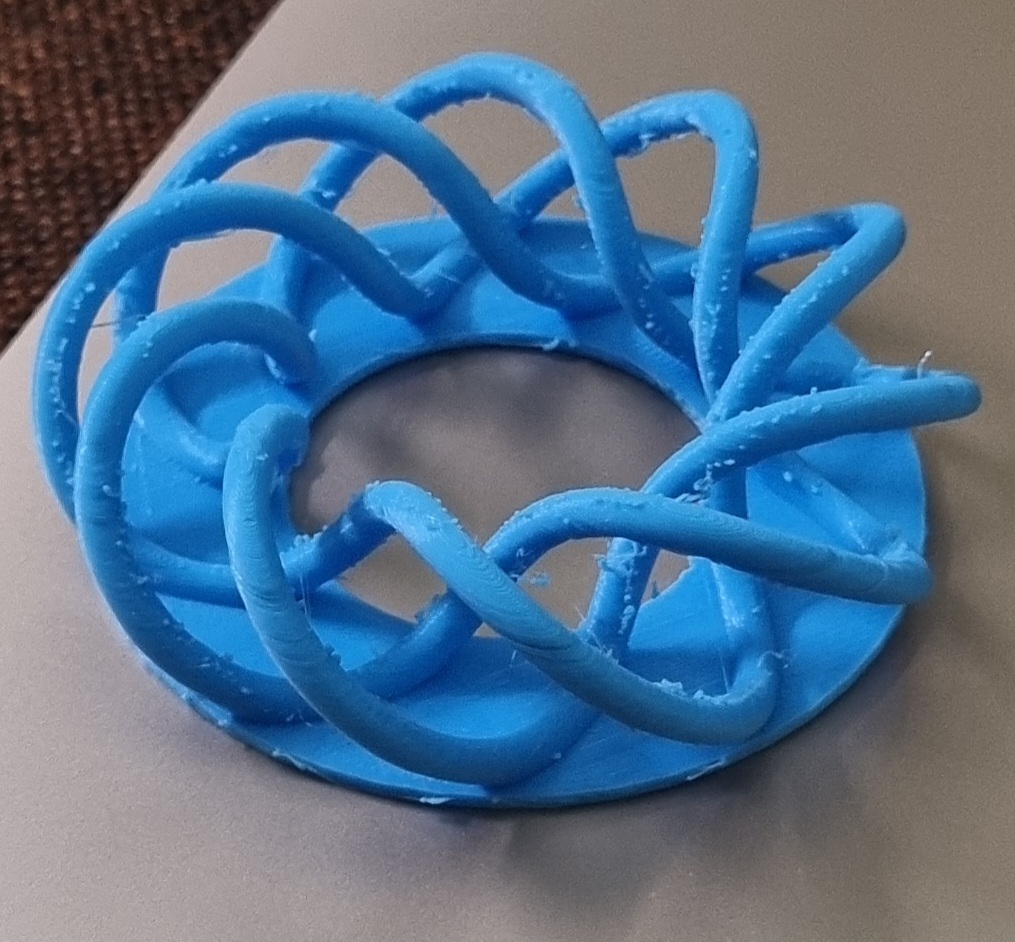

Sat, Sep 23, 2023 4:38 PM
Meanwhile, I printed this 3d knot which I made with the support of my
openscad1 python library.
It is not very neat, but still great to see this :)

On Sat, Sep 23, 2023 at 11:38 AM Sanjeev Prabhakar <
