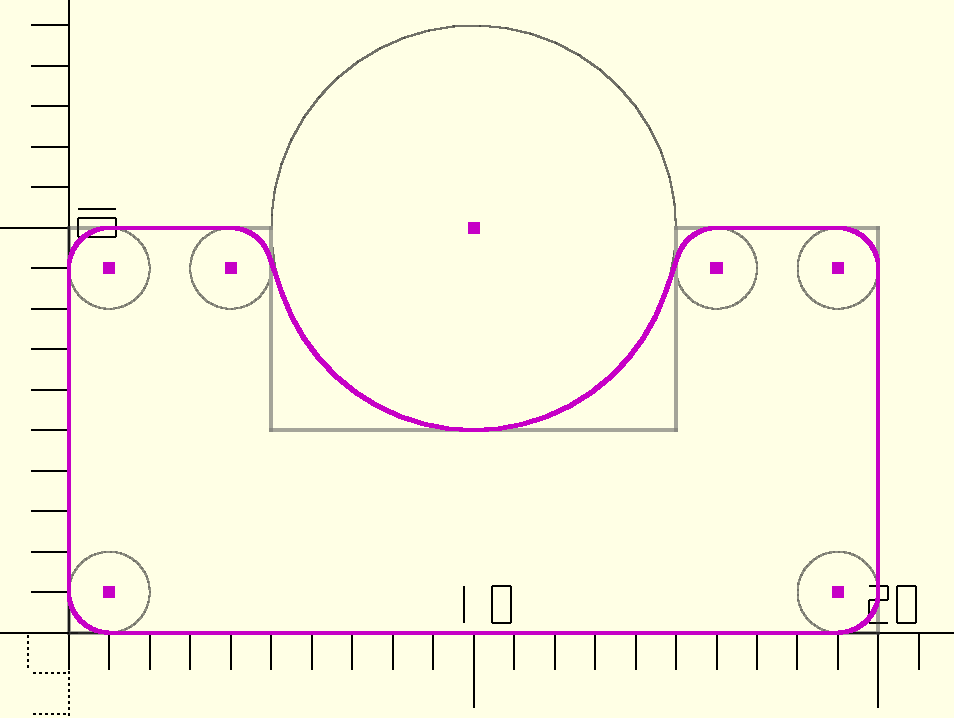

Fri, Sep 29, 2023 12:39 AM
created a file to visualise the logic for creating a closed loop section.
here is the link of jupyter notebook file:
https://github.com/sprabhakar2006/openSCAD/blob/main/visualise%20section%20logic.ipynb
[image: Screenshot 2023-09-29 at 6.07.32 AM.png]
created a file to visualise the logic for creating a closed loop section. here is the link of jupyter notebook file: https://github.com/sprabhakar2006/openSCAD/blob/main/visualise%20section%20logic.ipynb [image: Screenshot 2023-09-29 at 6.07.32 AM.png]
