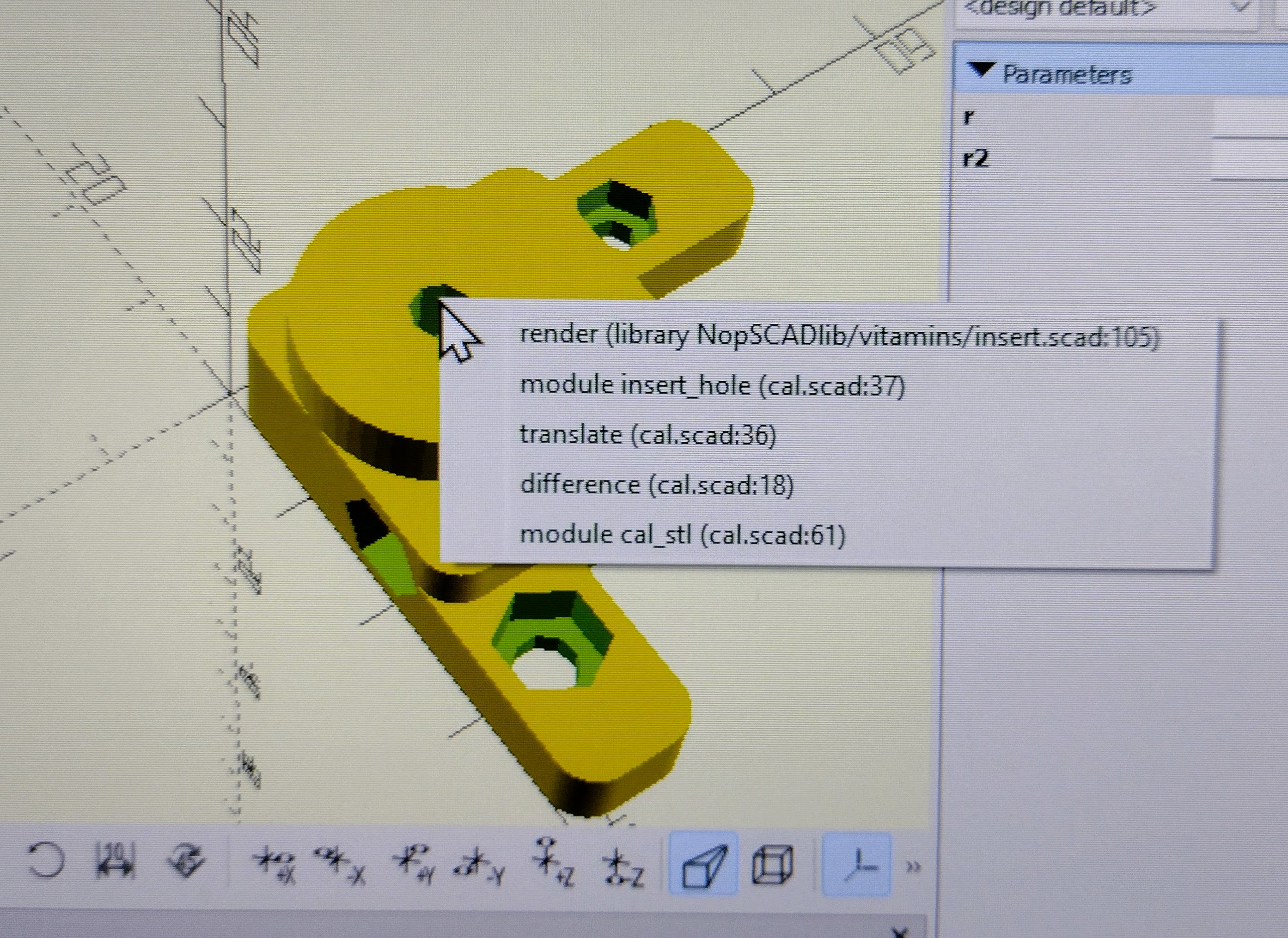

I would think the right click on the hole to show the stack trace of the
code would be better for that.
[image: IMG_20240806_081822679.jpg]
the code would be better for that.
Not at all. I agree that it's handy if I have forgotten where in the
code I generated that particular hole, but that's not the use case I
speak of.
All I get when I right click on something I want to modify is
"import (:1), which I have already guessed which line of source it is
on. :)
I modify a LOT of STLs for which I do not have source, so as I say, the
measurement features will save me a LOT of time.

Sorry I thought you were searching for the source of the shimmering with
coincident faces
On Tue, 6 Aug 2024, 15:28 larry via Discuss, discuss@lists.openscad.org
