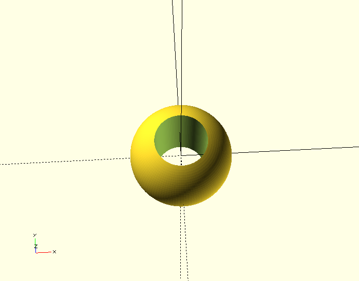

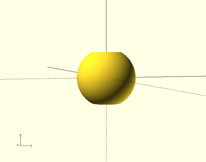

This brings to mind a puzzle I read when I was a teenager.
If you bore a hole through the center of a sphere such that the length
of the hole is 6", what is the volume of the remaining material?
To avoid any quibbles, here is an unlabelled picture of the result.
The 6" is the Z height of the figure.
There is a mathematical way to determine the answer, but there's a
logical way to do it.
And yes, the question has all the information required.
If you know the answer from having seen the puzzle before, don't give
it out too soon.

I get 36 PI

Do not read if you are still pondering the puzzle...
It is the volume of a sphere that is the same diameter as the height of the
drilled cylinder.
For a 6 inch height, it is 36(pi) inches.
I found the answer by considering the limit whereby the diameter of the
cylinder approaches zero.
of the drilled cylinder.
The diameter of the sphere is not the height of the drilled cylinder.
The diameter of the sphere is the 'diagonal' of the cylinder.
