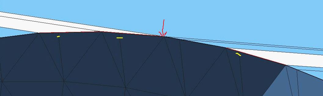

Thu, Sep 2, 2021 11:17 PM
For simple models, aligned to the axis, with simple measurements it tends to work.
When you introduce rotations, cones, disparate radii (which are really lots of lines at different angles) it will bite you in the arse.
You may get a 'CGAL ERROR: assertion violation!' and then you will remember this discussion.
At some stage you will try to export something and you will get an error saying the object is not manifold.
It may also not be apparent that there is a problem until you use the STL in some circumstances.
You may want to import() the STL to do a CSG operation, then you get a CGAL https://en.wikibooks.org/wiki/OpenSCAD_User_Manual/Importing_Geometry#Notes  Error.
You may upload it to Shapeways and it tells you it has self-intersections.
Other software may tell you there are degenerate faces.
Then you will post your STL here, and I will send you something like this:
and tell you that you should embed the cylinder into the other object.
Browse:
https://www.google.com/search?q=OpenSCAD+%22self+intersection%22
https://www.google.com/search?q=OpenSCAD+%22degenerate%22
https://www.google.com/search?q=openscad+%22non+manifold%22
https://www.google.com/search?q=openscad+%22CGAL+ERROR%22
Not all of those issues will be due to breaking the rule of thumb, but a good majority will.
As a bonus, if you follow the rule of thumb, you will not get z-fighting https://en.wikibooks.org/wiki/OpenSCAD_User_Manual/FAQ#What_are_those_strange_flickering_artifacts_in_the_preview?  on preview.
Everyone who thinks they may get serious about 3D modelling should start to learn about manifoldness https://www.google.com/search?q=shared+face+manifold&source=lnms&tbm=isch&sa=X .
