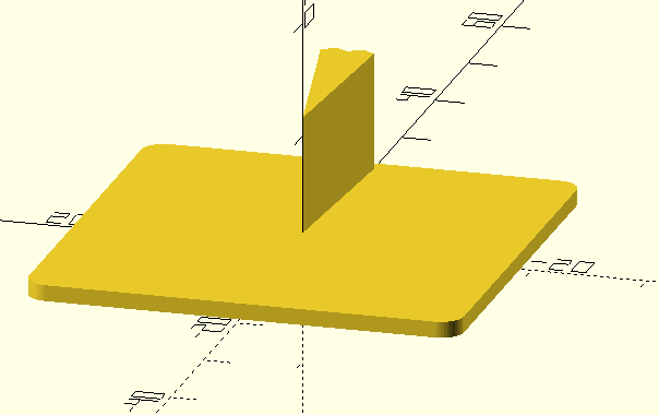

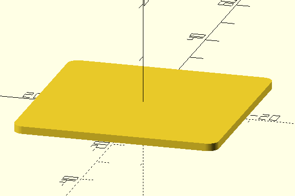

Ok, this one has me stumped.  This is an excerpt from a larger model, I've
simplified it as much as I can.
When I Preview, both modules, board() and outerRing(), are shown. [See
attached]
When I Render, only board() is displayed. [See attached]
Obviously, I'm missing something simple here, but what?
Thanks!
Len

The multiple polygons are sharing an edge which is not manifold.
Use rotate( (7.5-0.1)*i ) which moves the second polygons face inside the first polygons face.

Thanks, but I do not think that is the ultimate solution.  What if I wanted
the polygons to be separated and put
rotate( 10*i )
?  Then I'm back to the same problem.
Additional info:  When done individually, both board() and outerRing()
render fine.  It's only when I have both of them that the problem occurs.

When you have one object, you do not get a implicit union, so there is no conflict, try adding cube(1) or square(1) and you will see.
What if I wanted the polygons to be separated
Fine. As long as they do not share a face/line.
Your original code had the right face of one polygon, identical to the left face of the next one. Either trust me that they can't coexist, or research 'nonmanifold'.

Wed, Sep 1, 2021 3:18 PM
Thanks!  So, merely separating the polygons with rotate( 10*i ) did NOT
solve the problem, since all of the polygons started at [0,0].
Two solutions:
  1. Move the center point ever so slightly:
p = [ [0.001,0], for (a=[-15:15]) let (
r = a/4,
theta = 90+(a * 180/15) )
[ (outerRingOuterR+outerRingPetalHeight*sin(theta))cos(r),

My only questions, then, are: Why did outerRing(), by itself, render
successfully and produce an STL that Cura is happy with?  That is, why did
the problem only occur when another module is introduced?  Also, why are
there no warnings or errors?
On Wed, Sep 1, 2021 at 9:12 AM MichaelAtOz oz.at.michael@gmail.com wrote:
When done individually, both board() and outerRing() render fine.  It's

wanted the polygons to be separated and put
rotate( 10*i )
On Tue, Aug 31, 2021 at 11:03 PM MichaelAtOz oz.at.michael@gmail.com
From: Leonard Martin Struttmann [mailto:lenstruttmann@gmail.com]
Sent: Wed, 1 Sep 2021 11:53
Subject: [OpenSCAD] Module Disappears In Render
attached]
Thanks!
Len

Thanks! So, merely separating the polygons with rotate( 10*i ) did NOT solve the problem, since all of the polygons started at [0,0]. Two solutions: 1) Move the center point ever so slightly: p = [ [0.001,0], for (a=[-15:15]) let ( r = a/4, theta = 90+(a * 180/15) ) [ (outerRingOuterR+outerRingPetalHeight*sin(theta))*cos(r), (outerRingOuterR+outerRingPetalHeight*sin(theta))*sin(r)] ]; module outerRing() { translate( [ 0, 0, boardExtentZ] ) linear_extrude( outerRingZ, convexity=100 ) for ( i=[0:47] ) { rotate( 7.5*i ) polygon( p ); } } 2) Just make one polygon: p = [ for (a=[-180*4:180*4]) let ( r = a/4, theta = 90+(a * 180/15) ) [ (outerRingOuterR+outerRingPetalHeight*sin(theta))*cos(r), (outerRingOuterR+outerRingPetalHeight*sin(theta))*sin(r)] ]; module outerRing() { translate( [ 0, 0, boardExtentZ] ) linear_extrude( outerRingZ, convexity=100 ) polygon( p ); } My only questions, then, are: Why did outerRing(), by itself, render successfully and produce an STL that Cura is happy with? That is, why did the problem only occur when another module is introduced? Also, why are there no warnings or errors? On Wed, Sep 1, 2021 at 9:12 AM MichaelAtOz <oz.at.michael@gmail.com> wrote: > > When done individually, both board() and outerRing() render fine. It's > only when I have both of them that the problem occurs. > > When you have one object, you do not get a implicit union, so there is no > conflict, try adding cube(1) or square(1) and you will see. > > > > > What if I wanted the polygons to be separated > > > > Fine. As long as they do not share a face/line. > > Your original code had the right face of one polygon, identical to the > left face of the next one. Either trust me that they can't coexist, or > research 'nonmanifold'. > > > > > ------------------------------ > > *From:* Leonard Martin Struttmann [mailto:lenstruttmann@gmail.com] > *Sent:* Wed, 1 Sep 2021 23:48 > *To:* OpenSCAD general discussion > *Subject:* [OpenSCAD] Re: Module Disappears In Render > > > > *"**The multiple polygons are sharing an edge which is not manifold.* > > > > *Use rotate( (7.5-0.1)*i ) which moves the second polygons face inside the > first polygons face.**"* > > > > Thanks, but I do not think that is the ultimate solution. What if I > wanted the polygons to be separated and put > > > > rotate( 10*i ) > > > > ? Then I'm back to the same problem. > > > > Additional info: When done individually, both board() and outerRing() > render fine. It's only when I have both of them that the problem occurs. > > > > > > > > On Tue, Aug 31, 2021 at 11:03 PM MichaelAtOz <oz.at.michael@gmail.com> > wrote: > > The multiple polygons are sharing an edge which is not manifold. > > > > Use rotate( (7.5-0.1)*i ) which moves the second polygons face inside the > first polygons face. > > > > > ------------------------------ > > *From:* Leonard Martin Struttmann [mailto:lenstruttmann@gmail.com] > *Sent:* Wed, 1 Sep 2021 11:53 > *To:* OpenSCAD general discussion > *Subject:* [OpenSCAD] Module Disappears In Render > > > > Ok, this one has me stumped. This is an excerpt from a larger model, I've > simplified it as much as I can. > > > > When I Preview, both modules, board() and outerRing(), are shown. [See > attached] > > > > When I Render, only board() is displayed. [See attached] > > > > Obviously, I'm missing something simple here, but what? > > > > Thanks! > > Len > > > > ------------------------------------------------------- > > $fn = 48; > > RPiHQcamera(); > > boardXYZ = [ 38, 38, 1.4 ]; > boardCornerR = 2; > boardExtentZ = boardXYZ.z; > > outerRingPetalCount = 48; > outerRingPetalWidth = 360 / outerRingPetalCount; > > outerRingOuterR = 36/2; > outerRingInnerR = 35.4/2; > outerRingPetalHeight = outerRingOuterR - outerRingInnerR; > outerRingZ = 10.2; > > p = [ [0,0], for (a=[-15:15]) let ( > r = a/4, > theta = 90+(a * 180/15) ) > [ (outerRingOuterR+outerRingPetalHeight*sin(theta))*cos(r), > (outerRingOuterR+outerRingPetalHeight*sin(theta))*sin(r)] ]; > > > module outerRing() > { > translate( [ 0, 0, boardExtentZ] ) > linear_extrude( outerRingZ ) > // for ( i=[0:47] ) > // for ( i=[0:0] ) > for ( i=[0:1] ) > { > rotate( 7.5*i ) > polygon( p ); > } > } > > > module board() > { > linear_extrude( boardXYZ.z ) > hull() > for (i=[-1:2:1], j=[-1:2:1] ) > { > translate( [ i*(0.5*boardXYZ.x-boardCornerR), > j*(0.5*boardXYZ.y-boardCornerR) ] ) > circle( r=boardCornerR ); > } > } > > > //****************************** > module RPiHQcamera() > //****************************** > { > board(); > outerRing(); > } > //****************************** > > > > > > <http://www.avg.com/email-signature?utm_medium=email&utm_source=link&utm_campaign=sig-email&utm_content=emailclient> > > Virus-free. www.avg.com > <http://www.avg.com/email-signature?utm_medium=email&utm_source=link&utm_campaign=sig-email&utm_content=emailclient> > > <#m_-8402297447628402683_m_-6044723767729359281_DAB4FAD8-2DD7-40> > > _______________________________________________ > OpenSCAD mailing list > To unsubscribe send an email to discuss-leave@lists.openscad.org > > _______________________________________________ > OpenSCAD mailing list > To unsubscribe send an email to discuss-leave@lists.openscad.org >
CGAL is what really dislikes objects that aren't perfectly formed, and
doesn't get involved unless there's more than one object.

Yes, as that node was evaluated (and got an error) the node was then cached, so subsequent F6 don't get evaluated again, so no error.
If you think something is strange, it is always worth doing Design/Flush-cache.
Sharing a point (2D) is also non-manifold, as is sharing a single edge (3D).
