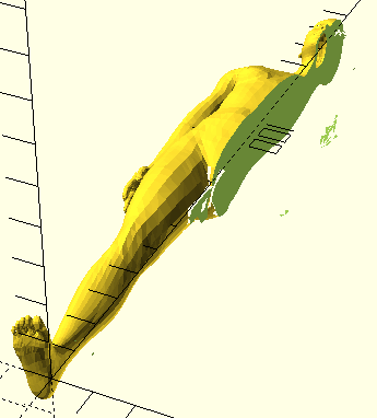

Hi, I'm new (but reading along for the last few days), so I apologize if
I violate some cultural norm or ask a question that I'm supposed to know.
That said, here's the short version:  Might anybody know how to use an
object from another application (Makehuman
http://www.makehumancommunity.org/, in my case) in a way that works
more or less like OpenSCAD's native objects?
For example, if I export an STL file from Makehuman, I can import() it
into OpenSCAD, yes.  However, if I apply an intersection() or
difference() operation to take just the head or an arm, the surface-mesh
aspect of STL files gets exposed, with a gaping hole along the
separation plane and parts of the remaining surface looking see-through
like what happens when taking the difference between two native objects
of similar sizes.
Overall, I want something like action figure or doll parts.  For
example, I might want to take the character's head as a separate object
and add a peg to the bottom so that a printed version can rotate in a
neck socket.  I can do that with loose geometric approximations of the
human form
(https://codeberg.org/jcolag/lights-edge-toys/src/branch/main/LLL-1/lll-1.scad
as my hacky proof-of-concept), but can't figure out how to get OpenSCAD
to treat the imported object as a solid thing.
I tried checking with Makehuman, Blender, and FreeCAD people, thinking
that I could do something upstream before import, but they only
understood that printing a closed mesh will give a solid pile of
plastic.  Or they had voxel things that required such high computational
loads that my laptop couldn't complete the task.
Thanks!

You're already on the right track with import().  import() is more or
less equivalent to polyhedron(), except that the data comes from a file.
surface-mesh aspect of STL files gets exposed, with a gaping hole
along the separation plane and parts of the remaining surface looking
see-through like what happens when taking the difference between two
native objects of similar sizes.
Mostly, OpenSCAD only works with solids.
If you're seeing gaping meshes, it suggests one of two things:
  • What you gave it wasn't a valid mesh to begin with.  Unfortunately,
    OpenSCAD is pickier than a lot of other consumers.  It may also have
    issues with very small (~10^-6) details.
  • The previewer has trouble when the camera is inside the model,
    notably including when it is inside invisible parts of the model.  A
    common issue is differencing away a large cube and then having
    trouble when you position the camera inside that invisible cube.
    Similarly, there can be issues if you intersect with a large cube
    and then put the camera inside that cube.
One simple check for whether OpenSCAD is unhappy with your mesh is to
attempt to union it with anything, typically a small cube, and render.
import("myfile.stl");
cube();
then press F6 to render.  If you end up with something that looks like
your mesh, you're golden.  If you end up with nothing and error messages
in the OpenSCAD console, not so good.
If you supply a sample mesh, somebody can experiment with it a bit.
Some of us have tools for identifying problems... but I'm not one of them.

It took me forever to run some tests and revisit this, but I did want to
check back in to thank everyone for their thoughts on this.  While I
haven't tried an actual print, yet, it looks like repairing the mesh -
FreeCAD's Evaluate & Repair Mesh tool, here; I've tried Blender's plugin
before, and it looks similar (but no Meshmixer on Linux) - PLUS the
convexity parameter comes pretty close for the default Makehuman model.
That's just bisecting (difference with a cube) the default model with no
proportions/identity elements set or accessories added, but good enough
for a proof of concept.  The floating bits on the image's right, and the
white/transparent areas make me a /little/ suspicious, but they're now
tiny, localized spots instead of the entire model like that.
Again, thanks, everyone!

How big is the cube that you're subtracting?  The obvious reason for
bits on the right side is that the cube isn't quite big enough.
Putting a # in front of the cube may make this more obvious.

the intersecting objects.  The cube is huge, though, and the bits just
float around well inside the boundaries.  I still call it a success,
considering the mess that I had in the first iterations.  Presumably,
the worst that'll happen is that the printer will eventually try to
dribble a couple of blobs in open space.
