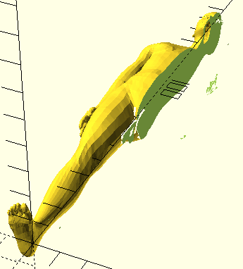

How big is the cube that you're subtracting?  The obvious reason for
bits on the right side is that the cube isn't quite big enough.
Putting a # in front of the cube may make this more obvious.
That's a neat trick!  Much better than my usual debugging of
reproducing the intersecting objects.  The cube is huge, though, and
the bits just float around well inside the boundaries.  I still call
it a success, considering the mess that I had in the first
iterations.  Presumably, the worst that'll happen is that the printer
will eventually try to dribble a couple of blobs in open space.

On 2/16/25 16:14, Jordan Brown wrote:
The cube is huge, though, and the bits just float around well inside the boundaries.
Hmm.  Do you mind privately shooting me a copy of the STL and your OpenSCAD program?
Sure!  It's nothing secret, so I'll leave it here for anybody who might
want to investigate.
https://upload.disroot.org/r/sgAMFbFe#MIQ3c4Yo2dSdd8DefqkCQsZRb8YbavAyA6YuYS0CK28=
For reference, I got to that point by:
  • Opening Makehuman (http://www.makehumancommunity.org/)
  • Exporting the character as-is.
  • Opening the STL in FreeCAD
  • Running the Mesh Design/Analyze and Repair Mesh tool repeatedly.
  • Saving.
(The Mesh Design mode seems to have vanished from my FreeCAD
installation since the weekend, but that's another bizarre problem for
another day...)
And the program is this boring.
    import("default-human.stl", convexity=20);
    translate([0, -25, -25])
        cube([50, 200, 50]);

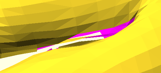

Tue, Feb 18, 2025 12:05 AM
[ chopping a Makehuman model in half ]
Yeah, those are preview artifacts almost certainly caused by flaws in
the mesh.
Note the transparent parts toward the left and up around the eyes.
And when we remove the difference and turn on View/Thrown Together, note
the magenta on the inside of the arms and the inside of the legs.
Magenta indicates faces that are "backwards", that have their vertexes
in the wrong order and so in some sense face the other way.
When you look closely, you see holes where there shouldn't be holes, e.g.
And when I try to render the differenced model with F6 I get...
WARNING: PolySet -> Manifold conversion failed: NotManifold
Trying to repair and reconstruct mesh..
ERROR: [manifold] Input mesh is not closed!
ERROR: [manifold] Surface_mesh -> Manifold conversion failed:
NotManifold
Note:  When you're looking for errors like that, make sure you
Design/Flush Caches before each attempt, because unfortunately OpenSCAD
will cache the erroneous result and so won't give the message on the
second attempt.
> [ chopping a Makehuman model in half ] Yeah, those are preview artifacts almost certainly caused by flaws in the mesh. Note the transparent parts toward the left and up around the eyes. And when we remove the difference and turn on View/Thrown Together, note the magenta on the inside of the arms and the inside of the legs. Magenta indicates faces that are "backwards", that have their vertexes in the wrong order and so in some sense face the other way. When you look closely, you see holes where there shouldn't be holes, e.g. And when I try to render the differenced model with F6 I get... WARNING: PolySet -> Manifold conversion failed: NotManifold Trying to repair and reconstruct mesh.. ERROR: [manifold] Input mesh is not closed! ERROR: [manifold] Surface_mesh -> Manifold conversion failed: NotManifold WARNING: No top level geometry to render Note:  When you're looking for errors like that, make sure you Design/Flush Caches before each attempt, because unfortunately OpenSCAD will cache the erroneous result and so won't give the message on the second attempt.
