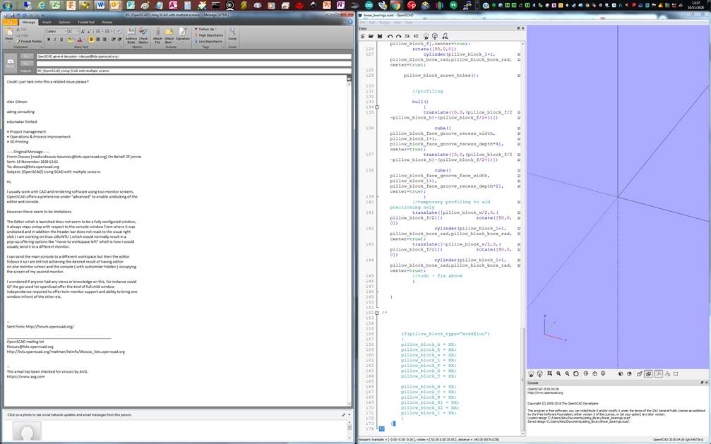

Could I just tack onto this a related issue please?
Under Windows 10 64-bit, OpenSCAD doesn't seem to respect the taskbar being
at the top of the screen (as it should always have been and was originally
intended, fight me J !)
Here you can see it behaving correctly under Windows 7 (but not always) but
sometimes when maximised the title bar disappears behind the taskbar, often
leaving a taskbar sized gap at the bottom of the screen.  No doubt this is
not OpenSCAD specific but may be a bug in QT or whatever is used for the
window manager. any hints and tips to force the correct behaviour, I'd be
grateful!!
