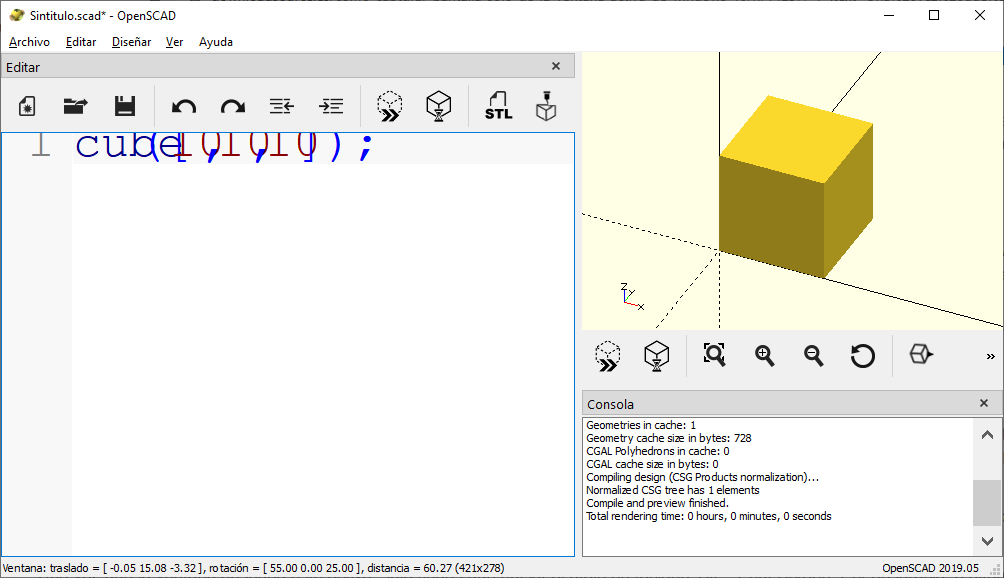

This is my first post in this forum. Please, excuse me if this is not the
right place to write this.
I have been using OpenSCAD since 2008, as a tool to teach Geometry concepts
in my Mathematics courses (Industrial Design). The OpenSCAD window is
projected onto a screen from a Windows machine, configured with extended
desktop. I have to use version 2014.03 because it is the last one that
works correctly in that environment. Newer versions have some issues with
correct scaling of fonts and zooming, on the extended desktop screen (the
projected one). The text becomes illegible. It seems to have to do with the
zoom scale factor and the fact that both displays have different
resolutions.
Of course, in version 2014.03 there is no color coding nor automatic
formatting....  :o)

Tue, Nov 17, 2020 2:40 PM
It probably depends on the graphics driver because I always use OpenSCAD on
two screens on Windows and it works fine for me. At the moment I have my
main screen on a Laptop at 1920x1080 and the second screen on a TV at 1600
x 900 with overscan. Apart from the fact I can't maximise it on the second
screen because of the overscan it works OK and the text is legible. It is
just a bit bigger on the TV because it is larger but has lower resolution.
I did try a slightly more modern, larger TV but the text was blurred
because it also had overscan which meant it was stretching the image. I
have a much larger brand new TV and that works as a monitor without
overscan.

Álvaro Deibe Díaz
Tue, Nov 17, 2020 10:00 PM
Good point. I also think it has something to do with the graphics driver.
But, since 2015 I have tried different computers (Thinkpad T420s, Surface
Pro 3, Thinkpad X1 Tablet), different OS (Windows 7, Windows 10), with
different chipset and of course different graphics hardware, with the same
result.
Watching the corrupted text, it appears that the text renderer draws, on
the secondary screen, a font of a size that is correct for the resolution
of the main screen but this font is spaced with the correct spacing from
the secondary screen. The letters are rendered correctly but are misplaced,
so they are stepping on each other.
I'm attaching an image showing a simple example of this behaviour, but I'm
not sure the image will get through.

Tue, Nov 17, 2020 10:48 PM
That is odd. I tried changing the Windows text size setting to get big
fonts but that also works fine for me.
The only obvious difference is you are using a different language, Spanish?
(I should know because I am living in Spain at the moment!) but I have only
ever used English.
I know it shouldn't make any difference but there must be something
different if you have problems on all those platforms.
I'm not sure the image will get through.

Oh, I see. Looked for that error before, but missed the right words to find
it.
The problems I see are the same as reported. Only, in my case, the error
appears with OpenSCAD at any window position and size, not only maximized.
Only in the secondary screen. In the primary screen always looks ok.
