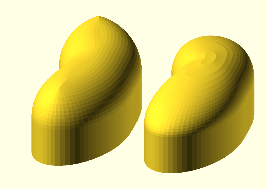

Sat, Jan 8, 2022 9:19 PM
What exactly does "rounded top" mean?  There are some ugly hacks
involving a massive union of offset or scaled parts forming a
stairstep model.  I think the best way to do this is to construct
your shape as a polyhedron with the desired rounded top.  To do this
easily, you can make your shape as a point list and then use a
library.  For example:
include <BOSL2/rounding.scad>
shape = supershape(step=2,m1=2, n1=1, n2=4, n3=8);
offset_sweep(shape, top = os_circle(r=1), height=2);
tlist = [ident(4),
for(i=[0:15]) let(z=i/15) up(1+z)scale(sqrt(1-(z.99)^2))
right(3)
sweep(shape, tlist);
The first method shown here (offset_sweep) makes a circular rounded
top.  But weird shapes don't have well behaved circular rounded tops.
That is, you get creases and degenerate behavior.  So you might need
to think about what you mean, exactly, when asking for a rounded top.
If you scale instead of offsetting you'll get something with a
rounded top that varies in its curvature and amount of rounding, but
avoids degeneracy.  And it probably involves more experimentation with
parameters to get the curve you want for the top.  But maybe that's
what you want?  That's the second version.  Both can be seen here:

The example I posted does what you said, using BOSL2 to perform the offsets and linking the layers together, which is better done with offset_sweep, because it is smart about how it connects adjacent layers. You'll probably get an inferior result with skin, and it will be more work, since you'll have to compute the layers yourself. But note that we don't know what "the right thing" is without more information from the original poster. Perhaps scaled layers are preferred---they avoid degeneracies in the layers that are likely to arise with offset. If you use offset you'll have edges appear, so the "rounded top" will have corners. The smoother top resulting from scale operations might be "best" in the eyes of the original poster. On Sat, Jan 8, 2022 at 5:22 PM Michael McCool <michael.d.mccool@gmail.com> wrote: > > Let’s assume the outline we want to use is in fact a 2D contour. The “right” way to do this is probably to generate a series of offsets, then “skin” between each one. > > The offset part is easy, there is an “offset” function. For skinning the two curves, “hull” will not do the right thing if there are concavities. The scale parameter to linear offset will also not do the right thing. A bit of googling though did turn up some libraries, for instance this one: https://github-wiki-see.page/m/revarbat/BOSL2/wiki/skin.scad > > Also, you want to have the right offsets and z values for a set of slices, but that’s something to play with (could start with a quarter circle schedule). There are also two variants of offset that might give different results. > > (From: Michael McCool) > > On Jan 8, 2022, at 18:09, Raymond West <raywest@raywest.com> wrote: > > Well, you can always split it on the inclusion, and fiddle it until it looks the way you want. > > //odd shape > module shape(){ //with inclusion > linear_extrude(20,convexity =10){ > polygon(points=[[-10,-10],[0,5],[-10,15],[15,18],[9,-1]]); > > }} > > module shape2(){ > shape(); > translate([5,6,20]) sphere(6); //locate maybe by trial and error > } > > module part1(){ > intersection(){ > translate ([-20,5,0]) > cube(50); > shape2(); > } > } > module part2(){ > difference(){ > shape2(); > part1(); > } > } > > $fn=80; > hull() part2(); > hull() part1(); > > On 08/01/2022 21:24, Adrian Mariano wrote: > > Both of his proposed shapes, a heart, and a kidney, are concave. So > > hull() is not going to do the job at all. > > > On Sat, Jan 8, 2022 at 4:17 PM Raymond West <raywest@raywest.com> wrote: > > use hull - > > > //odd shape > > module shape(){ > > linear_extrude(20,convexity =10){ > > polygon(points=[[-10,-10],[-10,15],[15,18],[9,-1]]); > > }} > > > $fn=80; > > hull(){ > > shape(); > > translate([0,6,20]) sphere(10); //locate maybe by trial and error > > } > > > On 08/01/2022 20:48, Joe Weinpert wrote: > > > > What is the best way to add a solid dome top to an odd shaped solid object? > > > For example: take a kidney or a heart shaped solid object with vertical sides an add a rounded top to it. > > > > > > > _______________________________________________ > > OpenSCAD mailing list > > To unsubscribe send an email to discuss-leave@lists.openscad.org > > > _______________________________________________ > > OpenSCAD mailing list > > To unsubscribe send an email to discuss-leave@lists.openscad.org > > _______________________________________________ > > OpenSCAD mailing list > > To unsubscribe send an email to discuss-leave@lists.openscad.org > > _______________________________________________ > OpenSCAD mailing list > To unsubscribe send an email to discuss-leave@lists.openscad.org > > _______________________________________________ > OpenSCAD mailing list > To unsubscribe send an email to discuss-leave@lists.openscad.org
