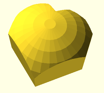

On 08.01.2022 21:48, Joe Weinpert wrote:
What is the best way to add a solid dome top to an odd shaped solid object?
For example: take a kidney or a heart shaped solid object with
vertical sides an add a rounded top to it.
The problem is not completely defined, but you could
  1. project the original heart shaped object to the XY plane and obtain a
    2d shape, which would be typically concave.
  2. Linear extrude the 2d shape to some height that is higher than the
    "dome" you envisage. Then you have a concave 3d cylinder.
  3. Intersect the 3d cylinder with e.g. a sphere with center at the base
    of the cylinder. You now have a 3d "dome".
  4. Translate the "dome" to union it with the original heart.

Based on Carsten Arnholm's suggestion, here is some code from which Joe
Weinpert might start.
intersection(){
linear_extrude(90)
polygon(points=[[0,0],[70,60],[70,110],[50,130],[20,130],[0,110],[-20,130],[-50,130],[-70,110],[-70,60]]);
// blocky heart shape
translate([0,80,0])
    sphere(90);

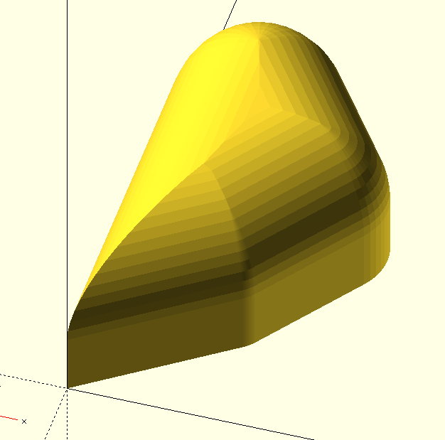

Sun, Jan 9, 2022 7:45 PM
I think you will find that most offset strategies remove
points---usually people are not interested in retaining extra points.
When I talk about robustness I mean getting the right answer at all,
not getting the right answer and tracking the point mapping between
the original and offset curves.
I do not know what the content of your dependencies.scad is, but I
tried your example in BOSL2.  In order to get a correct result with an
offset of -5 I had to select quality=4.  I think this is because you
have excessively fine sampling, with lots of points very close
together.  The BOSL2 offset function removes points, but it also has
the option to provide the map between original points and removed
points so that you can link the points together.  This is how
offset_sweep works.  There are two reasons I haven't pursued the
winding number scheme from the paper for a more robust offset.  One of
them is that it only works on polygons, not on paths with endpoints.
The other is that it won't give the mapping I need for offset_sweep,
and I use offset_sweep in almost every model.
The result of offset sweep on your shape with a radius 5 "dome"
appears below.  Note also that even if points are removed, all is not
lost.  You can link points "intelligently" and perhaps get a decent
result.  The BOSL2 skin() function does NOT require that the layers
linked together have the same number of points and if you use the
"distance" method you can perhaps get a good result on an example like
this, though it may be slow with many points, since the algorithm for
linking points is O(N^3).

Your code for computing the polygon relied on something inside
dependencies.scad that conflicted with BOSL2, so I just printed out
the contents of that path to use with BOSL2.  To create a domed shape
based on an input pointlist:
include<BOSL2/std.scad>
include<BOSL2/rounding.scad>
offset_sweep(pointlist, height=10, top=os_circle(r=5));
You need height to be larger than the radius given for the top, or you
can omit height entirely and you'll just get the dome.  The
offset_sweep() function is pretty complicated, with lots of options.
To learn how to use it, go here:
https://github.com/revarbat/BOSL2/wiki/rounding.scad#functionmodule-offset_sweep

please see the attached scad file "example of heart".
Not able to figure out why so many warnings, but it renders ok.
Is there a way to suppress these warnings
