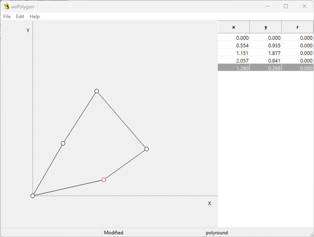

The one thing in using OpenCAD I've found challenging is defining point
arrays for extrusion profiles. Reading this thread, if I'd have realized
Inkscape works to do this I probably wouldn't have done this, but I
ended up writing a little program to "draw" polygons. Called wxPolygon,
it Looks like this:
You just click in the window and it defines points, collecting them in
the table to the right. Move 'em around by dragging, or edit the value
in the table. It does either two-element points for feeding to
polygon(), or three-element points where the third is a radius for
feeding to Round-Anything's polyround() function or (i suspect) the
BOSL2 equivalent.
Once defined, you can either save it to a file that contains an OpenSCAD
point array, or copy-paste them into your script. Going the other way,
you can select and copy the points in a script and paste them into
wxPolygon. I tend to use the latter, personal preference, but saving to
a file will kick off OpenSCAD's preview render if the file is included
our used in the open script.
Anyway, there's a Windows installer available, or you can download the
source code and compile it yourself here:
https://github.com/butcherg/wxpolygon
Open source, no charge...

the table. It does either two-element points for feeding to polygon(), or
three-element points where the third is a radius for feeding to
Round-Anything's polyround() function or (i suspect) the BOSL2 equivalent.
point array, or copy-paste them into your script. Going the other way, you
can select and copy the points in a script and paste them into wxPolygon. I
tend to use the latter, personal preference, but saving to a file will kick
off OpenSCAD's preview render if the file is included our used in the open
script.
