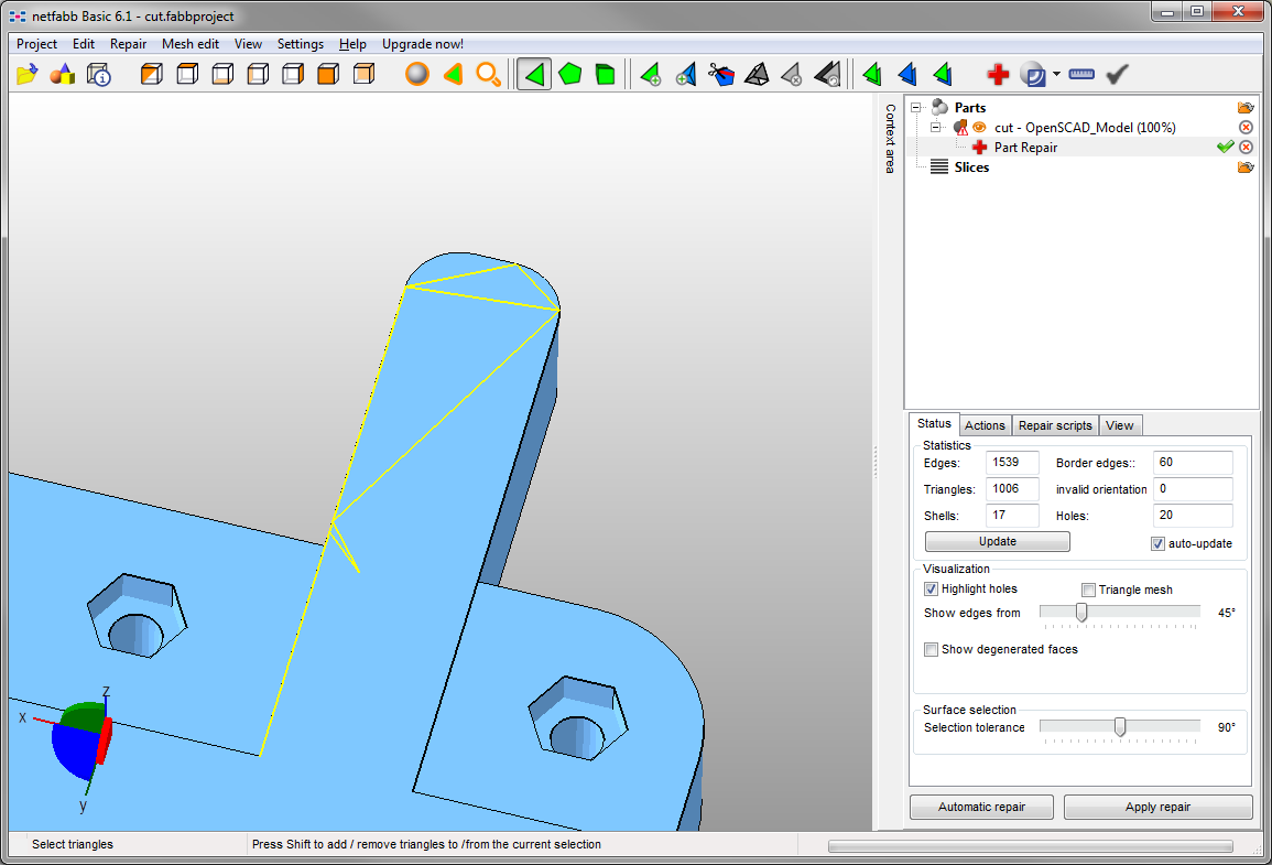

I used OpenScad 2015.05.16 (git e673fff).
Yes it came from your td17440_Cycl_XleftFrame-base_cut_fixed.stl. Netfabb
doesn't show any errors in that but once it has passed through OpenScad /
CGAL it shows 20 holes and 17 shells.

Nophead loaded that STL saying  above "This repaired version seems to work.
With Michael's version [aka the ...fixed.stl] I got the error message but
instead of an empty object I got something that looked like the original. I
exported that and repaired it in Netfabb. That version will then cut with
Michael's test.".
I just loaded his STL after his post got held up, as I'm an Admin.
I just tried to reproduce what he did and can't get the same result (tho not
using his exact version). The STL still gets the error, and Netfabb doesn't
show any issues.
So sorry, not solved...

Does the version I upload work with the original code?
I think the root problem is the old bug that OpenScad cannot import STL
files with vertices that are close together because it snaps them to a grid
and breaks the topology. Until OpenScad can import STL files properly there
will be an endless stream of these reports.
With the puzzle cut code, yes.
grid
there
Meshlab shows lots of self intersecting vertices. Fewer in the _fixed.stl.
But when ticking the 'unify' box on load there are none.
However, when exporting that (from meshlab), that STL still gets the CGAL
error.
With your hint, I changed it to;
module cutInTwo()
scale(0.5)
translate([0,-20,0])
xMaleCut()
rotate ([0,-90,90])
scale(2)
translate([55,-35,-16])
import("td17440 Cycl_XleftFrame-base_cut_fixed.stl"
, convexity=8);;
Which works. Seems the up scaled vertices are ok, so presumably it is the
NefPoly which has issues with the close vertices (if my vague understanding
is anywhere close). ?? clue
@ForthDr you will/may need to fiddle with the translate()'s as the scale(2)
moves the object.
The scale() change did not fix the degenerate issue, so you will need to run
the STL thru Netfabb online if you get that error.
