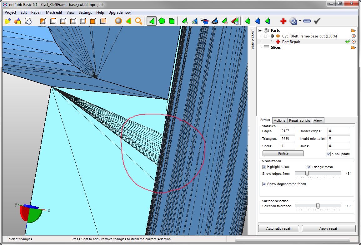

If the original STL is generated by OpenScad then you can remove the close
vertices. If you post the code I can have a look at it. If you look at the
triangulation there seem to be far too many triangles to tessellate such a
simple shape. In particular these look very suspicious.
Another solution would be to apply the puzzle cut directly to the OpenScad
object to avoid exporting it to STL and reading it back in again, which in
general doesn't work with OpenScad.

I can see where the crazy tessellation comes from now. There is a fan of
triangles for the simicircular cutout in the tall part that you have
removed. Netfabb is a mesh editor so it just truncates the fan of triangles
leaving some very close vertices. OpenScad can't handle close vertices.
Does it work if you puzzlecut the whole part rather than a section of it
made with Netfabb?

Unfortunately those original files have the problem. They are degenerate.
Unfortunately when run thru Netfabb online they then get the other CGAL
error. I can't see a way to fix them.

Well, I got the file manually repaired in Sketchup. It is now disgestible by CGAL. Cycl_XleftFrame-base_cut-repaired.stl <http://forum.openscad.org/file/n17520/Cycl_XleftFrame-base_cut-repaired.stl> <http://forum.openscad.org/file/n17520/Cycl_XleftFrame.png> <http://forum.openscad.org/file/n17520/Cycl_XleftFrame2.png> -- View this message in context: http://forum.openscad.org/puzzlecutlib-rendering-problem-STL-export-error-Current-top-level-object-is-empty-tp17440p17520.html Sent from the OpenSCAD mailing list archive at Nabble.com.
