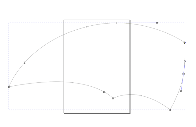

Fri, Feb 5, 2021 11:01 PM
Here’s a screen cap of path I manually constructed in inkscape…

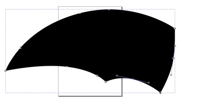

It’s supposed to be filled in with no outline and after lots of pulling my hair out I finally discovered that the ‘problem’ is that i created the points in the ‘wrong’ order and the ‘solution' was to “reverse” the direction of the path (Menu: Path/Reverse). That gave me what I was looking for…

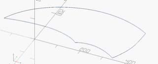

However when I import the SVG file into OpenSCAD (RC6) all I’m able to get is the outline and not the filled object. I’ve tried a variety of solutions (importing the original non-reversed path), saving in another format, loading that format, then saving in svg, etc. etc. But no luck, OpenSCAD still gives me this:
Anyone have any ideas, suggestions, thoughts on how to get OpenSCAD to preview/render this properly?
I’ve attached the SVG file as well.
