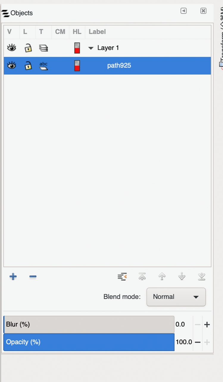

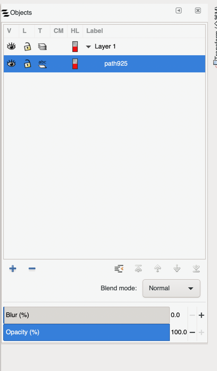

Thanks for taking a look. I’ve gone over my steps and even looked at the list of objects that inkscape thinks it has in the file and it’s only one path, so I don’t know where that coincident path may be coming from. very odd.

Thanks for taking a look. I’ve gone over my steps and even looked at the list of objects that inkscape thinks it has in the file and it’s only one path, so I don’t know where that coincident path may be coming from. very odd. > On Feb 5, 2021, at 3:14 PM, fred via Discuss <discuss@lists.openscad.org> wrote: > > Because LightBurn laser cutting software supports SVG files, I imported the blade into it and discovered there are two paths coincidental. That may be a factor in your problem? > > On Friday, February 5, 2021, 6:02:25 PM EST, Hugo Jackson <hugo@apres.net> wrote: > > > Here’s a screen cap of path I manually constructed in inkscape… > > > > It’s supposed to be filled in with no outline and after lots of pulling my hair out I finally discovered that the ‘problem’ is that i created the points in the ‘wrong’ order and the ‘solution' was to “reverse” the direction of the path (Menu: Path/Reverse). That gave me what I was looking for… > > > > However when I import the SVG file into OpenSCAD (RC6) all I’m able to get is the outline and not the filled object. I’ve tried a variety of solutions (importing the original non-reversed path), saving in another format, loading that format, then saving in svg, etc. etc. But no luck, OpenSCAD still gives me this: > > > > > Anyone have any ideas, suggestions, thoughts on how to get OpenSCAD to preview/render this properly? > > I’ve attached the SVG file as well. > > > _______________________________________________ > OpenSCAD mailing list > Discuss@lists.openscad.org <mailto:Discuss@lists.openscad.org> > http://lists.openscad.org/mailman/listinfo/discuss_lists.openscad.org <http://lists.openscad.org/mailman/listinfo/discuss_lists.openscad.org> > _______________________________________________ > OpenSCAD mailing list > Discuss@lists.openscad.org > http://lists.openscad.org/mailman/listinfo/discuss_lists.openscad.org

<Screen Shot 2021-02-05 at 3.34.12 PM.png>
