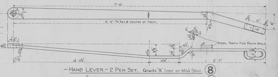

I have a tapered straight lever, given by
module st_lever(){
    pl= [
      [2,0,-2],[92,0,-1],[92,0,1],[2,0,2],
      [2,-1,-2],[92,-1,-1],[92,-1,1],[2,-1,2]];
    fl=[
     [0,1,2,3],
     [4,5,1,0],
     [7,6,5,4],
     [5,6,2,1],
     [6,7,3,2],
     [7,4,0,3]];
  polyhedron(pl,fl);
it has to be bent in a number of places.
  • It starts off as rotate ([0,0,-5]) st_lever() -
It then has to be bent // to the x axis at x=48.5 for a distance of
10.5, then back at 45 deg for 4 or 5 inches, then // to x axis again at
a -y distance of 1.25 from axis. (then a bit further on it is bent down).
Is there another way of doing this, other than either calculating the
xyz values at each bend location and making the polygon more
complicated, or using difference or intersection with cubes, say, to
split the lever into sections and stitch them together in the desired
profile? The attached jpg is what I'm working from (I'm not worried
about the loop at the end, nor the exact dimensions, it has to 'look
right', however.)

Do a side view in 2D and linear extrude it. Do a top view in 2D and linear
extrude it. Then rotate one and take the intersection.

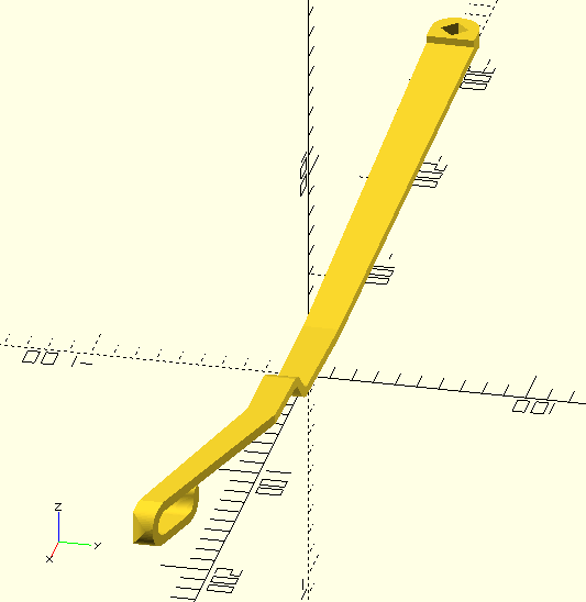

Wow! I have hardly ever used intersection, and never saw that much of a
use for it.
What you just said blew my mind!
So I decided to give it a try. Here's what I did, starting at 12:45 and
ending up with an OpenSCAD result.
  1. Loaded Ray's lever.jpg into Inkscape.
  2. made another layer, and locked layer 1.
  3. On layer 2, drew bezier straight lines for the top and front views.
  4. Used Edit path nodes to shape the curves.
  5. Deleted the image.
  6. Deleted the top view.
  7. Saved lever_side.svg.
  8. Restored the top view.
  9. Deleted the side view.
  10. Opened my favourite CAD program.
  11. Imported both files into it.
After much fiddling (because of rotate/translate orders, etc.), I came
up with the following script:
top();
front();
module top() {
linear_extrude(100)
scale([1,1,1])
import("/home/larry/handle_top.svg",center=true);
module front() {
rotate([90,0,0])
translate([-48.5,40,-50])
linear_extrude(100)
import("/home/larry/handle_side.svg");
And it produced attached result.
Did I say "WOW!"?
Thanks for the great tip.
top();
front();
module top() {
linear_extrude(100)
scale([1,1,1])
module front() {
rotate([90,0,0])
linear_extrude(100)
Did I say "WOW!"?
Ding! Achievment unlocked: OpenSCAD level III :-) Actually quite nice, levering (ha!) Inkscape into it Michael, fra mobilen tor. 15. jul. 2021 21.59 skrev larry <lar3ry@sasktel.net>: > On Thu, 2021-07-15 at 08:46 -0500, Father Horton wrote: > > Do a side view in 2D and linear extrude it. Do a top view in 2D and > > linear extrude it. Then rotate one and take the intersection. > > Wow! I have hardly ever used intersection, and never saw that much of a > use for it. > > What you just said blew my mind! > > So I decided to give it a try. Here's what I did, starting at 12:45 and > ending up with an OpenSCAD result. > > 1. Loaded Ray's lever.jpg into Inkscape. > 2. made another layer, and locked layer 1. > 3. On layer 2, drew bezier straight lines for the top and front views. > 3. Used Edit path nodes to shape the curves. > 4. Deleted the image. > 5. Deleted the top view. > 6. Saved lever_side.svg. > 7. Restored the top view. > 8. Deleted the side view. > 9. Opened my favourite CAD program. > 10. Imported both files into it. > > After much fiddling (because of rotate/translate orders, etc.), I came > up with the following script: > > intersection() { > top(); > front(); > } > > module top() { > linear_extrude(100) > scale([1,1,1]) > import("/home/larry/handle_top.svg",center=true); > } > > module front() { > rotate([90,0,0]) > translate([-48.5,40,-50]) > linear_extrude(100) > import("/home/larry/handle_side.svg"); > } > > And it produced attached result. > > Did I say "WOW!"? > Thanks for the great tip. > > > _______________________________________________ > OpenSCAD mailing list > To unsubscribe send an email to discuss-leave@lists.openscad.org >
I use Inkscape a lot when I am designing in 2D, unless it's simple
circles. rectangles, etc.
And I wouldn't even think about using OpenSCAD to draw something like
that lever. Especially if I already have a picture I can trace over.

Thanks for all your comments and suggestions. It is actually part of the
brakework for a rch standard 12 ton railway wagon (circa 1923). I am
trying to replicate the whole wagon as accurately as I can, using
openscad. My aim is to be able to 3d print either all, or parts, at
various scales, as required. I think it would be easier to build the
full size wagon. As it is fdm printing, then when scaled, parts have to
be thickened or deleted, depending on the scale and detail required. At
the smaller scales, (less than 7mm/ft) the brakes will not be operable,
and it is unlikely that at any larger scale that 3d printing would be
used for that detail.
would work good enough in this example, but generating two polygons
would be just as tedious as a single polyhedron, I guess, and it does
not work so well for twisted shapes, (i.e, bends, tubes,etc, not lining
up with the axis. ) I'm not sure if the drawing is to scale, but
possibly good enough to copy the jpg into some other drawing program and
produce a couple of dxf files.
I am struggling with producing a more generic bend/fold method, but I
think by putting on some restrictions e.g., number of bends, length of
shaft, etc, I may get something more or less useable. Any errors, tend
to disappear at a small scale, as does a lot of detail. The detail has
to be exaggerated, hopefully not the errors.
Of course, at the end of the day, it may look awful when printed, it
will need supports/whatever, since most likely it will be combined with
other components, so I may revert to folding etched or milled brass. Or,
most likely, once I've worked out how to do it, I'll go onto something
else - and save some plastic.
