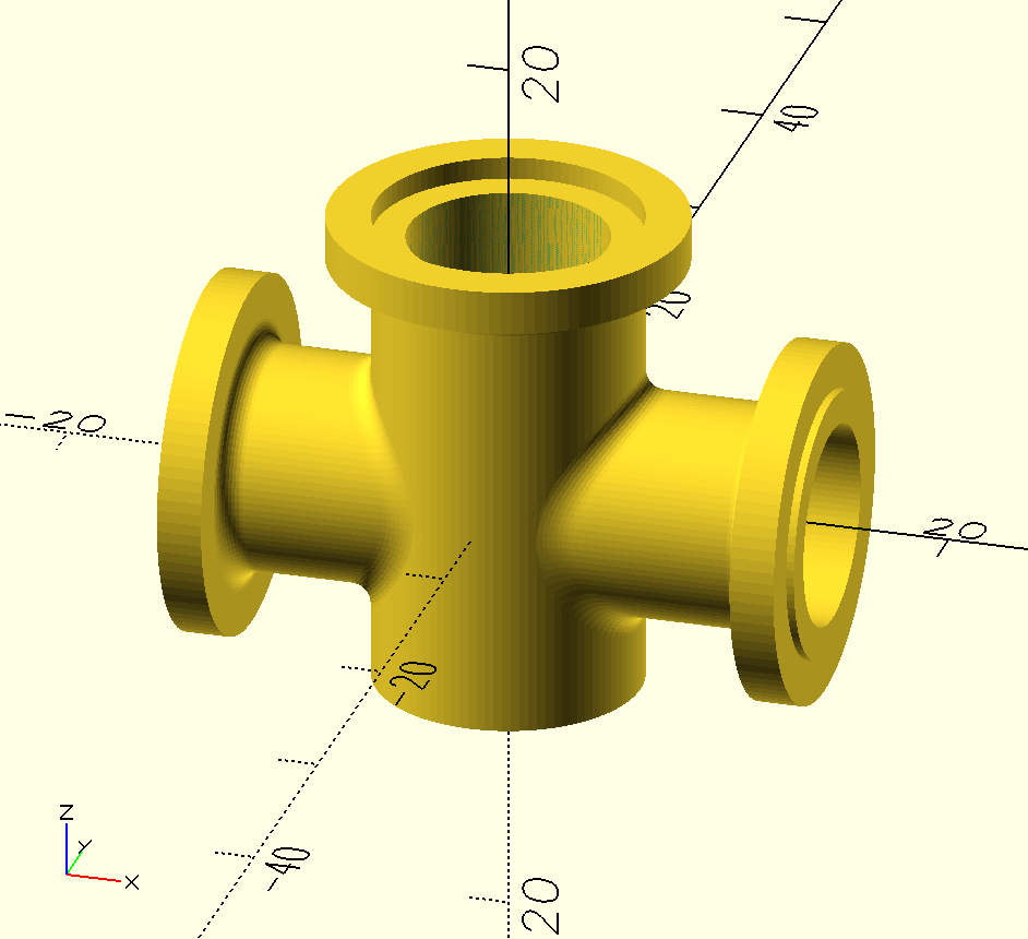

This is my python few lines of code for this:
from openscad2 import *
sec=circle(9/2,s=100)
path=corner_radius(pts1([[0,0],[1.5,0],[0,19+1,1],[2,0],[0,2],[-2,0],
[0,-1],[-1.5,0],[0,-19]]),10)
sol1=translate([0,0,-9],prism(sec,path))
path1=corner_radius(pts1([[0,0],[1.5,0],[0,.35],[2,0],[0,2],[-3,0,1],[0,24,1],
[3,0],[0,2],[-2,0],[0,.35],[-1.5,0],[0,-28.7]]),10)
sol2=translate([-14,0,0],rot('y90',prism(sec,path1)))
l1=ip_sol2sol(sol1,slice_sol(sol2[15:17],2))
l2=o_3d(l1,sol1,1)
l3=i_p_p(sol2,l1,-1)
f1=convert_3lines2fillet_closed(l3,l2,l1)
f2=mirror_surface(f1,[1,0,0],[0,0,0])
d1=o_solid([0,0,1],circle(9/2,s=100),20,-8)
d2=o_solid([1,0,0],circle(9/2,s=100),20,-10)
f.write(f'''
include<dependencies2.scad>
difference(){{
{swp(sol1)}
{swp(d2)}
difference(){{
{swp_c(sol2)}
{swp(d1)}
{swp_c(f1)}
{swp_c(f2)}
[image: Screenshot 2025-01-13 at 10.33.27 PM.png]
scad output file is attached, but this is all just points in space

You can get the path of the plain tube joints in raw openscad (thin
walls and intersection). You can then Minkowski that path, using an
extruded square with the corners cut away by circles, which almost gives
the required rounded fillet. However the fillet radius needs to change
as it follows the path, and the shape needs to rotate, and Minkowski is
too slow in this instance. A flat fillet would be simpler, I think,
since could get the path for the edges of the fillet on each tube. IIrc,
freecad can fillet openscad script generated files, but changes
everything to multi-matrix. If it wasn't a requirement for it to be
parametric, then I suppose a quarter of one joint fillet could be
manually or mathematically  generated in fine enough steps, and that
replicated 8 times.
l2=o_3d(l1,sol1,1)
l2=o_3d(l1,sol1,1)
f.write(f'''
difference(){{
{swp(sol1)}
{swp(d2)}
difference(){{
{swp_c(sol2)}
{swp(d1)}
{swp_c(f1)}
{swp_c(f2)}
     l2=o_3d(l1,sol1,1)
         f.write(f'''
         difference(){{
         {swp(sol1)}
         {swp(d2)}
         difference(){{
         {swp_c(sol2)}
         {swp(d1)}
         {swp_c(f1)}
         {swp_c(f2)}
     space

This gives a flat fillet (which I've called a bevel - depends if you
think it is internal or external, draughtsman or carpenter)
module tube(d){
       linear_extrude(100)
       circle(d=d);
       circle (d=d-0.0001);
 hull(){
  intersection(){
         tube(30);  //upright tube
       translate([-0,0,50])
       rotate([0,90,0])
         tube(20+bevel);
          intersection(){
         tube(30+bevel);  // side tube
       rotate([0,90,0])
         tube(20);
 $fn=100;
         cylinder(d=30,h=100);
       rotate([0,90,0])
       cylinder(d=20,h=50);
        bevel=6;  //  greater than 2.

This gives a flat fillet (which I've called a bevel - depends if you think it is internal or external, draughtsman or carpenter) module tube(d){        linear_extrude(100)       difference(){        circle(d=d);        circle (d=d-0.0001);      };  }  hull(){   intersection(){          tube(30);  //upright tube        translate([-0,0,50])        rotate([0,90,0])          tube(20+bevel);          }           intersection(){          tube(30+bevel);  // side tube        translate([-0,0,50])        rotate([0,90,0])          tube(20);          }  }  $fn=100;          cylinder(d=30,h=100);        translate([-0,0,50])        rotate([0,90,0])        cylinder(d=20,h=50);         bevel=6;  //  greater than 2. On 14/01/2025 11:59, Raymond West via Discuss wrote: > > I've used cadquery, which is sort of openscad with python. However it > constructs its solids differently, and some aspects do not work well, > giving distorted images. iirc, things like a sphere has a seam in it, > and if you try to take a scallop out of a surface of a cube, say, then > the sphere has to be rotated so the seam is not in the that region. > https://cadquery.readthedocs.io/en/latest/vis.html shows the seam in > the illustrations. I found the only sparse support was on Reddit,  I > couldn't find a forum/email list as helpful or responsive as this. > > But I thought that the idea in this 'puzzle' was to use openscad > script only, else you may as well use any other language/cad program. > My idea, although it failed in this case, gives a very good > representation of a beginner's welded joint... > > But I  agree that the points in space is important, I have in the past > resorted to exporting an SVG, and in python (or any other language > would suffice) calculated intermediate points and manipulated them, > saved, and reimported to openscad. It would be nice if openscad could > programmatically export and import plain text files, but in order to > keep the functional paradigm, I expect it would have  to be two > separate compiles. Finding work-arounds is interesting. > > On 14/01/2025 02:58, John David via Discuss wrote: >> re: python as an alternative language... >> >> You might want to take a look at https://pythonscad.org/ and >> https://github.com/SolidCode/SolidPython. I played with them a year >> or two ago when working on some 3D parametric optimization using >> genetic algorithms.  I have not finished that work, and it will be >> quite awhile before I can get back to it. >> >> On Mon, Jan 13, 2025 at 7:57 PM Sanjeev Prabhakar via Discuss >> <discuss@lists.openscad.org> wrote: >> >> Hi Ray, >> >> The point I want to make here is that if you learn to draw models >> with points in space instead of openSCAD primitives, it gives a >> lot of added flexibility to draw many complex models. >> >> I am sure there could be ways to generate the same thing someway >> in stock openscad. >> >> Like you mentioned minkowski but it might take a very long time >> to render. >> >> Finally, I wish python could be added in openscad as an alternate >> language, which can make things much easier. >> >> Regards >> >> >> On Tue, 14 Jan, 2025, 12:59 am Raymond West via Discuss, >> <discuss@lists.openscad.org> wrote: >> >> You can get the path of the plain tube joints in raw openscad >> (thin walls and intersection). You can then Minkowski that >> path, using an extruded square with the corners cut away by >> circles, which almost gives the required rounded fillet. >> However the fillet radius needs to change as it follows the >> path, and the shape needs to rotate, and Minkowski is too >> slow in this instance. A flat fillet would be simpler, I >> think, since could get the path for the edges of the fillet >> on each tube. IIrc, freecad can fillet openscad script >> generated files, but changes everything to multi-matrix. If >> it wasn't a requirement for it to be parametric, then I >> suppose a quarter of one joint fillet could be manually or >> mathematically  generated in fine enough steps, and that >> replicated 8 times. >> >> On 13/01/2025 17:10, Sanjeev Prabhakar via Discuss wrote: >>> This is my python few lines of code for this: >>> >>> ********************************************************************** >>> from openscad2 import * >>> sec=circle(9/2,s=100) >>> path=corner_radius(pts1([[0,0],[1.5,0],[0,19+1,1],[2,0],[0,2],[-2,0], >>> [0,-1],[-1.5,0],[0,-19]]),10) >>> >>> sol1=translate([0,0,-9],prism(sec,path)) >>> >>> path1=corner_radius(pts1([[0,0],[1.5,0],[0,.35],[2,0],[0,2],[-3,0,1],[0,24,1], >>>  [3,0],[0,2],[-2,0],[0,.35],[-1.5,0],[0,-28.7]]),10) >>> sol2=translate([-14,0,0],rot('y90',prism(sec,path1))) >>> l1=ip_sol2sol(sol1,slice_sol(sol2[15:17],2)) >>> l2=o_3d(l1,sol1,1) >>> l3=i_p_p(sol2,l1,-1) >>> f1=convert_3lines2fillet_closed(l3,l2,l1) >>> f2=mirror_surface(f1,[1,0,0],[0,0,0]) >>> >>> d1=o_solid([0,0,1],circle(9/2,s=100),20,-8) >>> d2=o_solid([1,0,0],circle(9/2,s=100),20,-10) >>> with open('trial.scad','w+') as f: >>>     f.write(f''' >>>     include<dependencies2.scad> >>>     difference(){{ >>>     {swp(sol1)} >>>     {swp(d2)} >>>     }} >>>     difference(){{ >>>     {swp_c(sol2)} >>>     {swp(d1)} >>>     }} >>>     {swp_c(f1)} >>>     {swp_c(f2)} >>> >>>     ''') >>> ***************************************************************************** >>> Screenshot 2025-01-13 at 10.33.27 PM.png >>> >>> scad output file is attached, but this is all just points in >>> space >>> >>> >>> On Mon, 13 Jan 2025 at 07:09, Sanjeev Prabhakar >>> <sprabhakar2006@gmail.com> wrote: >>> >>> Cube is just to explain the process. >>> Much complex shapes can be developed with a list of >>> points in a similar way. >>> >>> Once you create models with the list of points , there >>> are a lot of operations which can be done on them like >>> calculating the intersection between 2 solids. >>> >>> But this is only required if you need to do some complex >>> things like fillets. >>> >>> Otherwise stock openSCAD is good enough. >>> >>> >>> On Sun, 12 Jan, 2025, 11:52 pm Mark Erbaugh via Discuss, >>> <discuss@lists.openscad.org> wrote: >>> >>> I ran the code in OpenSCAD, but how is that >>> different from a simple cube(10); which is a lot >>> easier to type and understand? >>> >>> Is this what OpenSCAD’s cube() does under the hood? >>> Is that how more complex shapes are generated by BOSL2? >>> >>> I asked a question on this forum a while back about >>> using multmatrix to combine a series of rotate(), >>> scale() and  translate() calls into a single >>> transformation, thinking that it might be quicker if >>> those calls were done many times in a script and the >>> answer was that OpenSCAD combines those calls, and >>> computes one matrix and uses the matrix in its >>> calculations. So I’m thinking that if OpenSCAD has a >>>  module to do it, that module should be used. >>> >>> This raises a question: are the routines in OpenSCAD >>> written in a lower level OpenSCAD or do they go to a >>> lower level language, such as C(++). >>> >>> Mark >>> >>> >>>> On Jan 12, 2025, at 12:00 PM, Sanjeev Prabhakar >>>> <sprabhakar2006@gmail.com> wrote: >>>> >>>> p0=[[0,0,0],[10,0,0],[10,10,0],[0,10,0]]; >>>> p1=[[0,0,10],[10,0,10],[10,10,10],[0,10,10]]; >>>> >>>> cube_1=[p0,p1]; >>>> >>>> swp(cube_1); >>>> >>>> >>>> >>>> >>>> >>>> >>>> function faces(sol)= >>>> >>>> //    calculate the faces for the vertices with >>>> shape l x m with first and the last end closed >>>>     let( >>>>     l=len(sol), >>>>     m=len(sol[0]), >>>>     n1=[for(i=[0:m-1])i], >>>>     n2=[for(i=[0:l-2]) each ([ for(j=[0:m-1]) >>>>     each >>>> j<m-1?[[(j+1)+i*m,j+i*m,j+(i+1)*m],[(j+1)+i*m,j+(i+1)*m,(j+1)+(i+1)*m]]: >>>> [[0+i*m,j+i*m,j+(i+1)*m],[0+i*m,j+(i+1)*m,0+(i+1)*m]] >>>>     ])], >>>> n3=[for(i=[0:m-1])i+(l-1)*m], >>>> n4=[for(i=[len(n3)-1:-1:0])n3[i]], >>>>     n=[n1,each (n2),n4] >>>>     )n; >>>> >>>> >>>> function faces_1(sol)= >>>> >>>> //    calculate the faces for the vertices with >>>> shape l x m with first and the last end open >>>>     let( >>>>     l=len(sol), >>>>     m=len(sol[0]), >>>>     n2=[for(i=[0:l-2])each([ for(j=[0:m-1]) >>>>     each >>>> j<m-1?[[(j+1)+i*m,j+i*m,j+(i+1)*m],[(j+1)+i*m,j+(i+1)*m,(j+1)+(i+1)*m]]: >>>> [[0+i*m,j+i*m,j+(i+1)*m],[0+i*m,j+(i+1)*m,0+(i+1)*m]] >>>>     ])] >>>> >>>>     )n2; >>>> >>>>  function vertices(sol)= >>>> [each for (p=sol)p]; >>>> >>>> // module for rendering the polyhedron with ends closed >>>> module swp(sol){ >>>> let( >>>> v1=vertices(sol), >>>> f1=faces(sol) >>>> ) >>>> polyhedron(v1,f1,convexity=10); >>>> >>>> } >>>> >>> >>> _______________________________________________ >>> OpenSCAD mailing list >>> To unsubscribe send an email to >>> discuss-leave@lists.openscad.org >>> >>> >>> _______________________________________________ >>> OpenSCAD mailing list >>> To unsubscribe send an email todiscuss-leave@lists.openscad.org >> _______________________________________________ >> OpenSCAD mailing list >> To unsubscribe send an email to discuss-leave@lists.openscad.org >> >> _______________________________________________ >> OpenSCAD mailing list >> To unsubscribe send an email to discuss-leave@lists.openscad.org >> >> >> _______________________________________________ >> OpenSCAD mailing list >> To unsubscribe send an email todiscuss-leave@lists.openscad.org > > _______________________________________________ > OpenSCAD mailing list > To unsubscribe send an email todiscuss-leave@lists.openscad.org
module tube(d){
linear_extrude(100)
circle(d=d);
hull(){
intersection(){
rotate([0,90,0])
tube(20+bevel);
intersection(){
rotate([0,90,0])
tube(20);
$fn=100;
rotate([0,90,0])

You can get the path of the plain tube joints in raw openscad (thin walls and intersection). You can then Minkowski that path, using an extruded square with the corners cut away by circles, which almost gives the required rounded fillet. However the fillet radius needs to change as it follows the path, and the shape needs to rotate, and Minkowski is too slow in this instance. A flat fillet would be simpler, I think, since could get the path for the edges of the fillet on each tube. IIrc, freecad can fillet openscad script generated files, but changes everything to multi-matrix. If it wasn't a requirement for it to be parametric, then I suppose a quarter of one joint fillet could be manually or mathematically  generated in fine enough steps, and that replicated 8 times.
l2=o_3d(l1,sol1,1)
f.write(f'''
difference(){{
{swp(sol1)}
{swp(d2)}
difference(){{
{swp_c(sol2)}
{swp(d1)}
{swp_c(f1)}
{swp_c(f2)}
