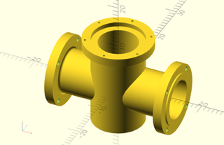

To enhance my OpenSCAD skills, I attempted on of the Reddit CAD challenges.
They provide a drawing and you need to model the part.
Here’s what I came up with
The only thing I haven’t figured out is how to place the fillet on the intersection of the vertical and horizontal tubes.
I would appreciate any comments on my design and in particular a solution to the fillet.
Mark

I would try Bosl2's join_prism() to do the fillet.

First,
Thanks for the replies.
The method I used was to do as much in 2D and then rotate_extruded that into 3D. In both modules top() (vertical piece) and side() (horizontal piece) the outline array and polygon() creates a 2D outline of one side of the cross-section of the pipe with flange. The fillet module adds a 2d fillet under the flange. The polygons are created in the XY plane with the flange on the X axis and will be translated and rotated into the final position. Since the horizontal piece is symmetrical around the Y axis (which is the X axis before rotation), the polygon only creates half and that is mirrored.
After the rotate extrude, the hole for the other pipe is added as are the bolt holes. The two pieces are then rotated and translated so that the intersection is at the origin and the two pieces are joined() with a union.
I’m not sure I fully understand the comment of creating meshes from polyhedra. I thought that was the purpose of OpenSCAD.

Taking Todd Allen's suggestion, here is amended .scad, adding the fillet in
BOSL2.  I've marked the additional source code lines with '// add' to make
them easier to see.

David,
Thanks.
I’ll put learning BOSL2 on my todo list. I already had it installed and your script worked fine.
Mark

OK, just for a simple example of creating a cube
consider the following code. 'swp' is a module which creates the mesh from
the points.
p0: is a square in x-y plane
p1: is a square translated to 10 units in z-direction.
you can play around with the coordinates in p0 and p1 to see different
shapes
p0=[[0,0,0],[10,0,0],[10,10,0],[0,10,0]];
p1=[[0,0,10],[10,0,10],[10,10,10],[0,10,10]];
cube_1=[p0,p1];
swp(cube_1);
that is mirrored.

I would suggest you learn to write models through points in space, create
meshes and use module polyhedron to render the final model.
The sooner you can do that the better.
For creating fillets, you need to to find intersection points between the
2 solids.That would need some work.
Getting the fillets from primitives in openSCAD is extremely difficult as
per my understanding.
Good luck

 First,
 mirrored.
 Mark
 On Jan 12, 2025, at 7:53 AM, Jon Bondy <jon@jonbondy.com> wrote:
 "learn to write models through points in space, create meshes ...
 The sooner you can do that the better."
 Our goals are opposite.  Languages like OpenSCAD are useful to me
 EXACTLY because I do not have to create meshes by hand.
 On 1/12/2025 4:32 AM, Sanjeev Prabhakar via Discuss wrote:
 It's a little difficult to go line by line and understand the
 code written by you (At Least for me).
 I appreciate the final outcome from your code though.
 space, create meshes and use module polyhedron to render the
 final model.
 between the 2 solids.That would need some work.
 extremely difficult as per my understanding.
 Good luck
 On Sat, 11 Jan 2025 at 07:33, Mark Erbaugh via Discuss
     CAD challenges.
