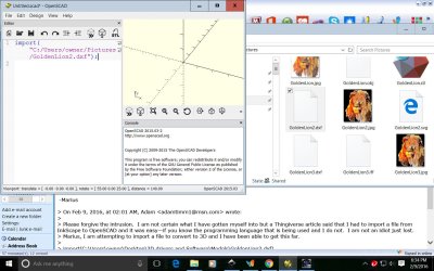

I am a photographer and an artist.  I want to create 3D images from my
photos and from artwork so that the blind can touch an image and "see it."
That is* all *I want to do. I did it once through another venue.
I did drop a "dxf" file onto the command line but I haven't the foggiest how
to implement it.  The first time I did it I got a message saying I had
dropped an invalid dxf file onto the command line.
I am told that I have to "correctly escape the string." How do I do that?  I
am totally overwhelmed with things I have to do at the moment and I do not
want more.  I am at a point where everything I do takes me further afield
from my goals.  I know that there is a manual but for the little thing I am
attempting to do I only need a couple of instructions.  I have no intention
of doing any greater things with SCAD.  It is a task I will repeat many
times until something better/easier comes along.
Could someone please tell me how to import the dxf file I want, extrude it
then save it as an STL?  I was thinking I would get an  "import" button, but
noooo!
Can/would someone please walk me through this?

The \ character is magic inside a "..." character string.
If you are using windows, change all occurrences of \ to / within the path
name, and your problem should go away.
Usually people who are getting error messages from OpenSCAD post the source
code and the error message, it makes it easier for us to see what is going
on.

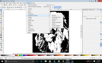

@adamtimm1 keep at it- you'll get there.
Not sure if you're trying to import a dxf (already a vector format) or
vectorise a 2D raster image like a jpg.
  1. to transform a 2D raster image like a jpg you need to convert it to
    vector form, then export it to .scad file
  • drop the jpg onto the inkscape canvas (or use File/Import)
  • select it and select Path/Trace_Bitmap
    • this will allow you to chose how to threshold it and create one or more
      vector layers.
    • I'm going to assume you want a simple, single level, outline.
      • Choose "Brightness Cutoff" = 0.5. Hit update to preview and OK to
        add to canvas.
    • You will now have an extra object which is a 2D threshholded vectored
      version of your jpg image.
    • You can scale it and position it manually.
      • Use the paper size as a guide and set Default units to mm in
        File/Document_Properties.
      • So you can see its actual size when you export to OPENscad
  • export it
    • select it and then choose Extensions/Generate_from_path/Paths to
      OPENscad
    • it will save into profile.scad in your home directory
      Double click it to open in openSCAD.
  • see more details on using it once its there in this thingiverse post
    where the latest version of the paths to openscad.py conversion tool is.
Note: To make a multilevel vectored version of your jpg artwork - check out
inkscape and trace bitmap online for help. basically the same but several
grouped layers.
Also the Lithopane idea mentioned by @fred_dot_u is very good one for many
layers but for touch you may need to scale the off-page axis quite a lot.
  1. Using a 2D dxf file as the source
  • just import it or drop it onto the canvas.
  • if it won't load and complains about the format in some way - then the dxf
    is crafted a bit special to the authoring program.
    • I suggest you load it into some kind of dxf converter and save as dxf
      again or svg if it can do it.
  • if it appers in inkscape then it should be ok.
  • select it and save to openscad as per 1.
Let us know how you get on...
good luck.

Thanks Doug,
 I think "usually" means that they weren't ambushed by a language they are not familiar with and know a little about what they are doing.
 I was able to paste the dxf file, but how do I implement?
noooo!

Marius the admin for OpenScad said that I could drag and drop the dxf file directly into OpenScad but then I am stuck with how the heck do I implement the import.  The line of code means nothing to me as much as I wish it meant more.  This is the only use I will ever have for this program, that plus adjusting the depth of the image to make it more tactile.
As for the Extensions > export, I have Guillotine, plot, and Win32 vector print.  Nothing else.  I do not have an "export to OpenScad." and believe me, I have looked.
But it's the "select it and then choose Extensions/Generate_from_path/Paths to OPENscad" that has been bugging me the most. It just is not there and I have been looking for two days.    I do not believe that the previous step was even mentioned in the "how to" on the Instructable.
I have attempted to install the extensions but they do not show up.  Path2openscad3 shows the inv and pyth extensions in file explorer but the extension does not work.
I have installed and uninstalled Inkscape and the extensions 4 times in different directories.  The program practically insisted on installing to my desk top and would not work at all unless I did.
      vector layers.
        add to canvas.
  • export it
      OPENscad
grouped layers.
good luck.
but
noooo!

  2. I'm sorry for your troubles with Inkscape.
    You need 0.91. You also need to download the extension (which what inkscape
    calls plugins) and put it in the right directory. If you're on windows
    that's %APPDATA% then go looking for the inkscape/extensions folder.
The instructable you reference is making a simple black and white one-layer
shape. Your image looks like its maybe > 8 layers.
When you split your image into 8 layers - using the Trace_Bitmap tool -
you'll need to have these settings:
  • choose colors,
  • 8 layers (or however many you need)
  • stack scans off
  • remove_background off (but you can play with this and the previous
    option)
  • smooth on (optional)
    http://forum.openscad.org/file/n16093/bitmap_001315.png
    Then export using the extension (must be v8). force line output must be off.
