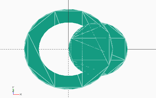

Tue, Feb 4, 2020 2:28 PM
The difference operation is fake: the edges of the hole are not highlighted
with edges on. It seems that the hole circle is just a mask and the
difference polygon is not really computed. Unions seem to be fake too and
some ghost edges may appear.
// linear_extrude(100)
translate([50,0,0]) circle(d=100);
circle(d=150);
circle(d=100);
[image: ghostLinesPNG.PNG]
The polygon is really computed when extruded.

Tue, Feb 4, 2020 2:45 PM
It only seems to be a problem in the orthogonal view.
I must admit I am surprised that 2D is faked in OpenCSG. I thought it was
always calculated and then drawn as a thin polyhedron but it appears that
is not the case. Adding render() fixes it and then the correct edges are
drawn.
