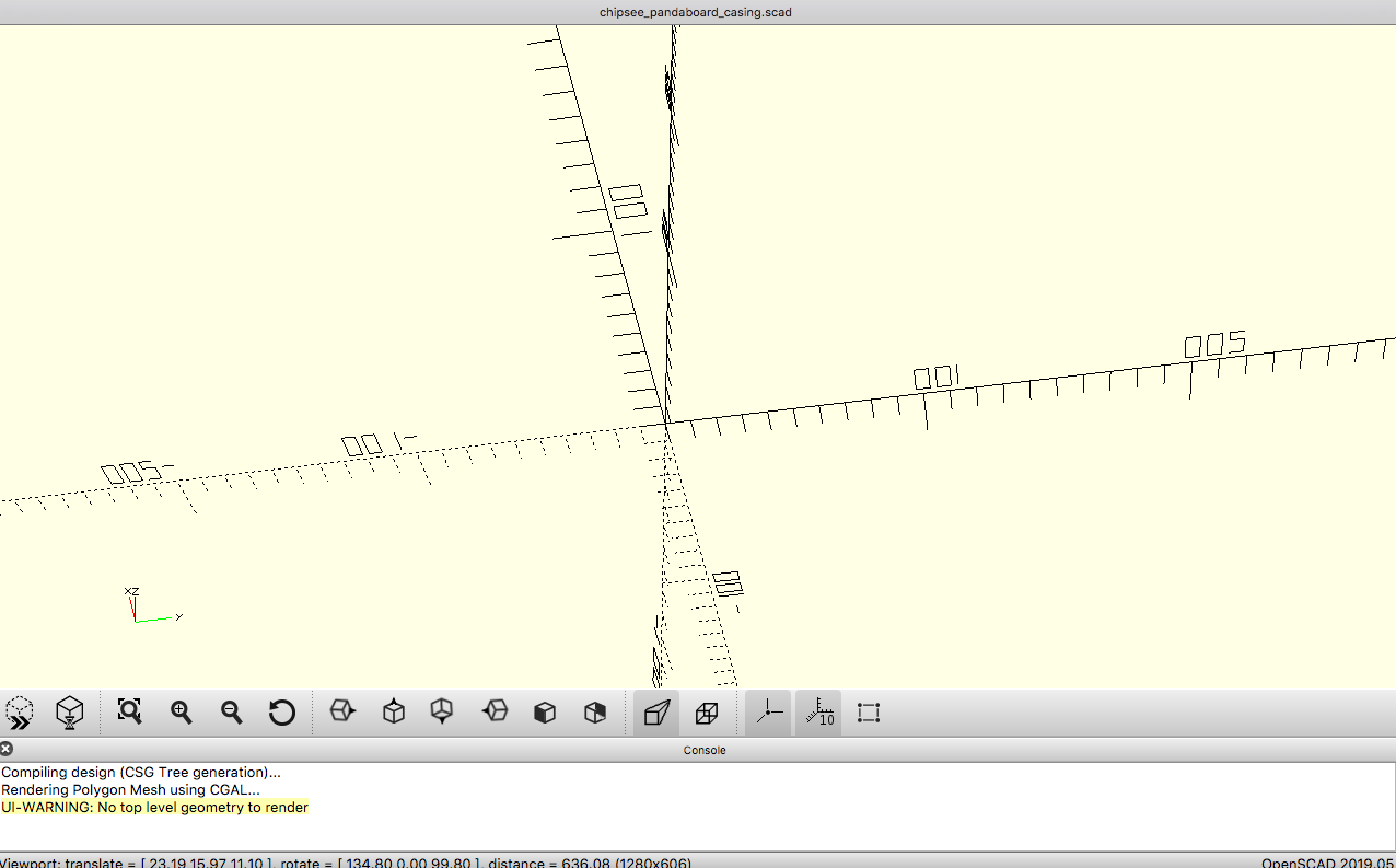

Conversion of .scad to .stl results in Blank output
U
user35b@gmail.com
Thu, Jan 6, 2022 3:00 PM
Please help. I cannot convert the above Openscad code to STL. On trying it, I received the above blank page with the notice/warning below it.
I read somewhere that it might be owing to the % I used, yet I don't know how to fix it. The keyboard dimension (top of source code) is the actual length for the artefact.
Here is the code in editable form - https://pastebin.mozilla.org/wjo2V2xj
Entire code and grahics can be downloaded from here - https://file.pizza/download/gt0tfawi

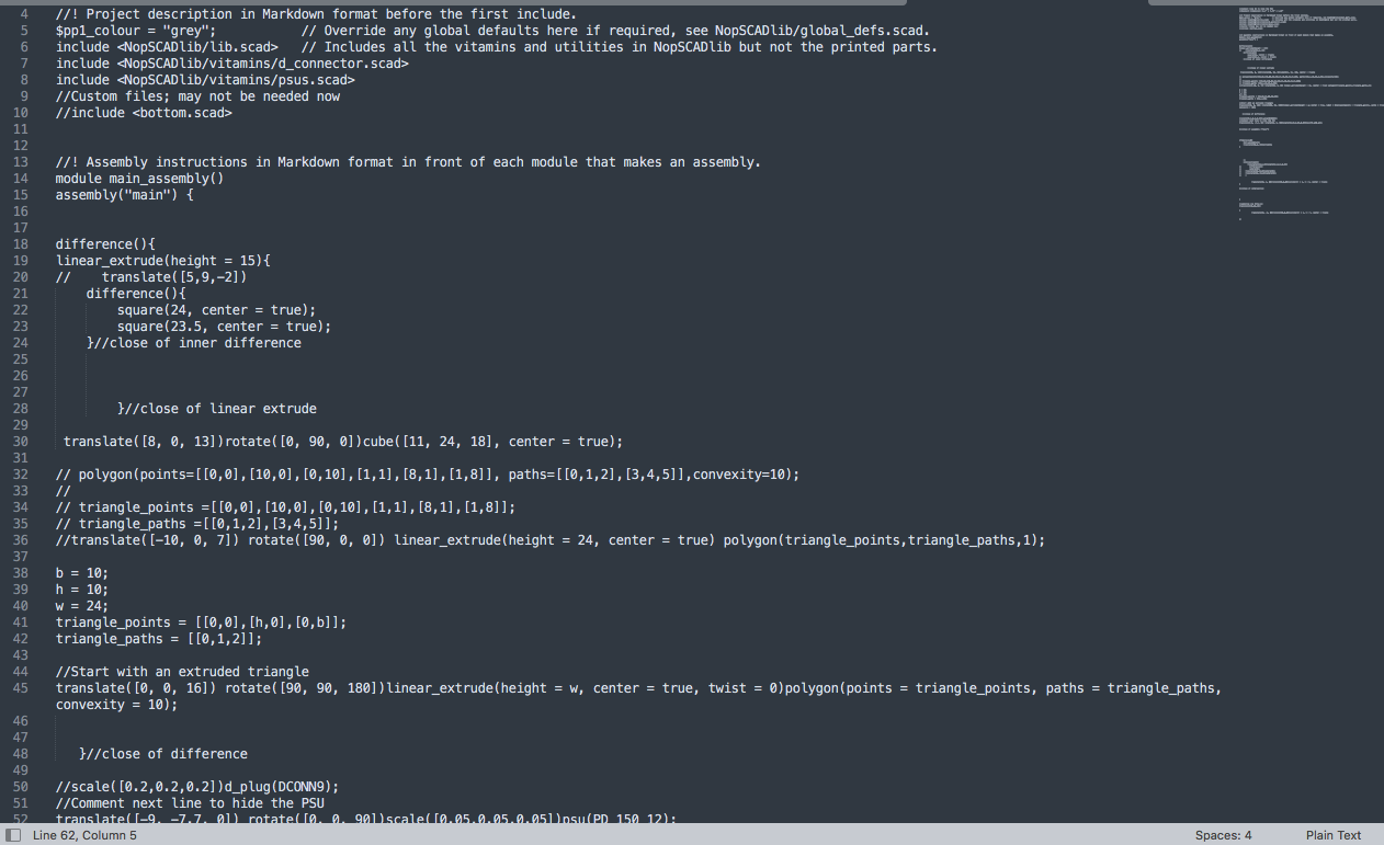

Main code here:
[code]

Error image, desired output and code screenshots are attached.
Kindly assist.

Line 60 is if($preview), so it only generates an assembly view with F5 and
nothing with F6.
Your main_assembly() has geometry in it, which is not how NopSCADlib works.
You put geometry in modules that make STLs and include those modules in
your assembly view. Then you normally export the STLs using the Python
framework but you could
add an else clause to the if($preview) to call one of your STL making
modules.

psu() is a module that draws a specified power supply in an assembly
diagram, so you can fit it into a project. It isn't something that can be
exported as an STL. I don't know why one would ever want to scale it down
by 20 as it is the actual size in mm.

$pp1_colour = "grey"; // Override any global defaults here if required,
see NopSCADlib/global_defs.scad.
include <NopSCADlib/lib.scad> // Includes all the vitamins and utilities
Kindly assist.
Thanks in advance.

Dear Sanjeev,
ou Tfor your assistance.  Your attachment throws an error as shown below:

All right, I shall get the version 2021. Thanks. I am wanting to learn from the resource you sent while putting some final touches to mine. On Fri, Jan 7, 2022 at 9:06 AM Sanjeev Prabhakar <sprabhakar2006@gmail.com> wrote: > Which version of openscad you are working with? > It needs 2021 version which supports x^2 system for squaring otherwise you > need to replace the syntax with pow(x,2) > > On Fri, 7 Jan 2022, 06:17 user user, <user35b@gmail.com> wrote: > >> Dear Sanjeev, >> >> ou Tfor your assistance. Your attachment throws an error as shown below: >> >> dependencies.scad", line 107: syntax error >> >> On Fri, Jan 7, 2022 at 12:34 AM Sanjeev Prabhakar < >> sprabhakar2006@gmail.com> wrote: >> >>> Hi >>> There is another way to do this. >>> not clear what is psu >>> regards >>> >>> On Thu, 6 Jan 2022 at 20:31, <user35b@gmail.com> wrote: >>> >>>> Please help. I cannot convert the above Openscad code to STL. On trying >>>> it, I received the above blank page with the notice/warning below it. >>>> >>>> >>>> >>>> I read somewhere that it might be owing to the % I used, yet I don't >>>> know how to fix it. The keyboard dimension (top of source code) is the >>>> actual length for the artefact. >>>> >>>> Here is the code in editable form - >>>> https://pastebin.mozilla.org/wjo2V2xj >>>> >>>> Entire code and grahics can be downloaded from here - >>>> https://file.pizza/download/gt0tfawi >>>> >>>> Main code here: >>>> >>>> [code] >>>> >>>> //Comment line 52 to hide the PSU >>>> >>>> //Keyboard dimension: 14.1” x 7.79” x 1.49” >>>> >>>> //! Project description in Markdown format before the first include. >>>> >>>> $pp1_colour = "grey"; // Override any global defaults here if required, >>>> see NopSCADlib/global_defs.scad. >>>> >>>> include <NopSCADlib/lib.scad> // Includes all the vitamins and >>>> utilities in NopSCADlib but not the printed parts. >>>> >>>> include <NopSCADlib/vitamins/d_connector.scad> >>>> >>>> include <NopSCADlib/vitamins/psus.scad> >>>> >>>> //Custom files; may not be needed now >>>> >>>> //include <bottom.scad> >>>> >>>> //! Assembly instructions in Markdown format in front of each module >>>> that makes an assembly. >>>> >>>> module main_assembly() >>>> >>>> assembly("main") { >>>> >>>> difference(){ >>>> >>>> linear_extrude(height = 15){ >>>> >>>> // translate([5,9,-2]) >>>> >>>> difference(){ >>>> >>>> square(24, center = true); >>>> >>>> square(23.5, center = true); >>>> >>>> }//close of inner difference >>>> >>>> }//close of linear extrude >>>> >>>> translate([8, 0, 13])rotate([0, 90, 0])cube([11, 24, 18], center = >>>> true); >>>> >>>> // polygon(points=[[0,0],[10,0],[0,10],[1,1],[8,1],[1,8]], >>>> paths=[[0,1,2],[3,4,5]],convexity=10); >>>> >>>> // >>>> >>>> // triangle_points =[[0,0],[10,0],[0,10],[1,1],[8,1],[1,8]]; >>>> >>>> // triangle_paths =[[0,1,2],[3,4,5]]; >>>> >>>> //translate([-10, 0, 7]) rotate([90, 0, 0]) linear_extrude(height = 24, >>>> center = true) polygon(triangle_points,triangle_paths,1); >>>> >>>> b = 10; >>>> >>>> h = 10; >>>> >>>> w = 24; >>>> >>>> triangle_points = [[0,0],[h,0],[0,b]]; >>>> >>>> triangle_paths = [[0,1,2]]; >>>> >>>> //Start with an extruded triangle >>>> >>>> translate([0, 0, 16]) rotate([90, 90, 180])linear_extrude(height = w, >>>> center = true, twist = 0)polygon(points = triangle_points, paths = >>>> triangle_paths, convexity = 10); >>>> >>>> }//close of difference >>>> >>>> //scale([0.2,0.2,0.2])d_plug(DCONN9); >>>> >>>> //Comment next line to hide the PSU >>>> >>>> translate([-9, -7.7, 0]) rotate([0, 0, >>>> 90])scale([0.05,0.05,0.05])psu(PD_150_12); >>>> >>>> }//close of assembly ("main") >>>> >>>> if($preview){ >>>> >>>> main_assembly(); >>>> >>>> translate([0,0,-5])bottom(); >>>> >>>> } >>>> >>>> /* >>>> >>>> intersection(){ >>>> >>>> translate([10,6,1]){scale(0.5,0.5,0.5){ >>>> >>>> // difference(){ >>>> >>>> // sphere(8); >>>> >>>> // translate([0,10,0])sphere(8); >>>> >>>> // translate([0,-10,0])sphere(8); >>>> >>>> // } >>>> >>>> translate([0, 2, 0])rotate([90,0,0])cylinder(r = 1, h = 9, center = >>>> true); >>>> >>>> } >>>> >>>> }//close of intersection >>>> >>>> } >>>> >>>> //updating via http-svn >>>> >>>> translate([10,36,1]){ >>>> >>>> } >>>> >>>> translate([0, -2, 0])rotate([90,0,0])cylinder(r = 1, h = 7, center = >>>> true); >>>> >>>> */ >>>> >>>> [/code] >>>> >>>> Error image, desired output and code screenshots are attached. >>>> >>>> Kindly assist. >>>> >>>> Thanks in advance. >>>> _______________________________________________ >>>> OpenSCAD mailing list >>>> To unsubscribe send an email to discuss-leave@lists.openscad.org >>>> >>> _______________________________________________ >>> OpenSCAD mailing list >>> To unsubscribe send an email to discuss-leave@lists.openscad.org >>> >> _______________________________________________ >> OpenSCAD mailing list >> To unsubscribe send an email to discuss-leave@lists.openscad.org >> > _______________________________________________ > OpenSCAD mailing list > To unsubscribe send an email to discuss-leave@lists.openscad.org >
you need to replace the syntax with  pow(x,2)

Great thanks On Fri, 7 Jan 2022, 06:43 user user, <user35b@gmail.com> wrote: > All right, I shall get the version 2021. > Thanks. I am wanting to learn from the resource you sent while putting > some final touches to mine. > > On Fri, Jan 7, 2022 at 9:06 AM Sanjeev Prabhakar <sprabhakar2006@gmail.com> > wrote: > >> Which version of openscad you are working with? >> It needs 2021 version which supports x^2 system for squaring otherwise >> you need to replace the syntax with pow(x,2) >> >> On Fri, 7 Jan 2022, 06:17 user user, <user35b@gmail.com> wrote: >> >>> Dear Sanjeev, >>> >>> ou Tfor your assistance. Your attachment throws an error as shown below: >>> >>> dependencies.scad", line 107: syntax error >>> >>> On Fri, Jan 7, 2022 at 12:34 AM Sanjeev Prabhakar < >>> sprabhakar2006@gmail.com> wrote: >>> >>>> Hi >>>> There is another way to do this. >>>> not clear what is psu >>>> regards >>>> >>>> On Thu, 6 Jan 2022 at 20:31, <user35b@gmail.com> wrote: >>>> >>>>> Please help. I cannot convert the above Openscad code to STL. On >>>>> trying it, I received the above blank page with the notice/warning below it. >>>>> >>>>> >>>>> >>>>> I read somewhere that it might be owing to the % I used, yet I don't >>>>> know how to fix it. The keyboard dimension (top of source code) is the >>>>> actual length for the artefact. >>>>> >>>>> Here is the code in editable form - >>>>> https://pastebin.mozilla.org/wjo2V2xj >>>>> >>>>> Entire code and grahics can be downloaded from here - >>>>> https://file.pizza/download/gt0tfawi >>>>> >>>>> Main code here: >>>>> >>>>> [code] >>>>> >>>>> //Comment line 52 to hide the PSU >>>>> >>>>> //Keyboard dimension: 14.1” x 7.79” x 1.49” >>>>> >>>>> //! Project description in Markdown format before the first include. >>>>> >>>>> $pp1_colour = "grey"; // Override any global defaults here if >>>>> required, see NopSCADlib/global_defs.scad. >>>>> >>>>> include <NopSCADlib/lib.scad> // Includes all the vitamins and >>>>> utilities in NopSCADlib but not the printed parts. >>>>> >>>>> include <NopSCADlib/vitamins/d_connector.scad> >>>>> >>>>> include <NopSCADlib/vitamins/psus.scad> >>>>> >>>>> //Custom files; may not be needed now >>>>> >>>>> //include <bottom.scad> >>>>> >>>>> //! Assembly instructions in Markdown format in front of each module >>>>> that makes an assembly. >>>>> >>>>> module main_assembly() >>>>> >>>>> assembly("main") { >>>>> >>>>> difference(){ >>>>> >>>>> linear_extrude(height = 15){ >>>>> >>>>> // translate([5,9,-2]) >>>>> >>>>> difference(){ >>>>> >>>>> square(24, center = true); >>>>> >>>>> square(23.5, center = true); >>>>> >>>>> }//close of inner difference >>>>> >>>>> }//close of linear extrude >>>>> >>>>> translate([8, 0, 13])rotate([0, 90, 0])cube([11, 24, 18], center = >>>>> true); >>>>> >>>>> // polygon(points=[[0,0],[10,0],[0,10],[1,1],[8,1],[1,8]], >>>>> paths=[[0,1,2],[3,4,5]],convexity=10); >>>>> >>>>> // >>>>> >>>>> // triangle_points =[[0,0],[10,0],[0,10],[1,1],[8,1],[1,8]]; >>>>> >>>>> // triangle_paths =[[0,1,2],[3,4,5]]; >>>>> >>>>> //translate([-10, 0, 7]) rotate([90, 0, 0]) linear_extrude(height = >>>>> 24, center = true) polygon(triangle_points,triangle_paths,1); >>>>> >>>>> b = 10; >>>>> >>>>> h = 10; >>>>> >>>>> w = 24; >>>>> >>>>> triangle_points = [[0,0],[h,0],[0,b]]; >>>>> >>>>> triangle_paths = [[0,1,2]]; >>>>> >>>>> //Start with an extruded triangle >>>>> >>>>> translate([0, 0, 16]) rotate([90, 90, 180])linear_extrude(height = w, >>>>> center = true, twist = 0)polygon(points = triangle_points, paths = >>>>> triangle_paths, convexity = 10); >>>>> >>>>> }//close of difference >>>>> >>>>> //scale([0.2,0.2,0.2])d_plug(DCONN9); >>>>> >>>>> //Comment next line to hide the PSU >>>>> >>>>> translate([-9, -7.7, 0]) rotate([0, 0, >>>>> 90])scale([0.05,0.05,0.05])psu(PD_150_12); >>>>> >>>>> }//close of assembly ("main") >>>>> >>>>> if($preview){ >>>>> >>>>> main_assembly(); >>>>> >>>>> translate([0,0,-5])bottom(); >>>>> >>>>> } >>>>> >>>>> /* >>>>> >>>>> intersection(){ >>>>> >>>>> translate([10,6,1]){scale(0.5,0.5,0.5){ >>>>> >>>>> // difference(){ >>>>> >>>>> // sphere(8); >>>>> >>>>> // translate([0,10,0])sphere(8); >>>>> >>>>> // translate([0,-10,0])sphere(8); >>>>> >>>>> // } >>>>> >>>>> translate([0, 2, 0])rotate([90,0,0])cylinder(r = 1, h = 9, center = >>>>> true); >>>>> >>>>> } >>>>> >>>>> }//close of intersection >>>>> >>>>> } >>>>> >>>>> //updating via http-svn >>>>> >>>>> translate([10,36,1]){ >>>>> >>>>> } >>>>> >>>>> translate([0, -2, 0])rotate([90,0,0])cylinder(r = 1, h = 7, center = >>>>> true); >>>>> >>>>> */ >>>>> >>>>> [/code] >>>>> >>>>> Error image, desired output and code screenshots are attached. >>>>> >>>>> Kindly assist. >>>>> >>>>> Thanks in advance. >>>>> _______________________________________________ >>>>> OpenSCAD mailing list >>>>> To unsubscribe send an email to discuss-leave@lists.openscad.org >>>>> >>>> _______________________________________________ >>>> OpenSCAD mailing list >>>> To unsubscribe send an email to discuss-leave@lists.openscad.org >>>> >>> _______________________________________________ >>> OpenSCAD mailing list >>> To unsubscribe send an email to discuss-leave@lists.openscad.org >>> >> _______________________________________________ >> OpenSCAD mailing list >> To unsubscribe send an email to discuss-leave@lists.openscad.org >> > _______________________________________________ > OpenSCAD mailing list > To unsubscribe send an email to discuss-leave@lists.openscad.org >
UU
user user
Fri, Jan 7, 2022 1:30 AM
Dear All,
Thank you for your comments. I can now convert to STL on commenting the
preview. I however now need properly scale the artefact. I am actually
nothing with F6.
works. You put geometry in modules that make STLs and include those modules
in your assembly view. Then you normally export the STLs using the Python
modules.
