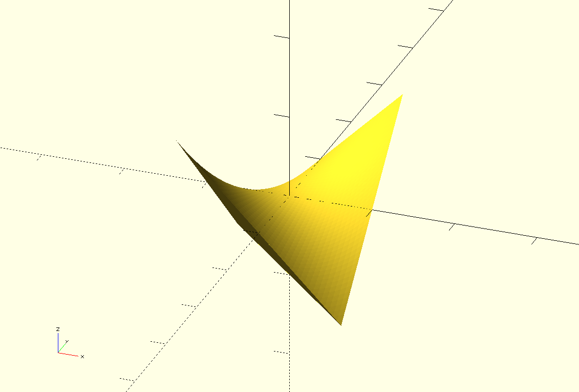

That is actually simpler as it can be closed by two triangles.
​xmin = -1;
xmax = 1;
ymin = -1;
ymax = 1;
step = 0.05;
xpoints = floor((xmax - xmin) / step) + 1;
ypoints = floor((ymax - ymin) / step) + 1;
function index(x,y) = x * ypoints + y;
function x(i) = xmin + i * step;
function y(i) = ymin + i * step;
points = [for(i = [0 : xpoints - 1]) for(j = [0 : ypoints - 1]) [x(i),
y(j), x(i) * y(j)]];
function flatten(l) = [for(a = l) for (b = a) b];
base = [
[index(0, 0), index(xpoints -1, 0), index(0, ypoints -1)],
[index(xpoints -1, ypoints -1), index(0, ypoints -1), index(xpoints
-1, 0)],
faces = flatten([for(i = [0 : xpoints - 2]) for(j = [0 : ypoints - 2])
[[index(i,j), index(i, j + 1), index(i + 1, j + 1)],
[index(i + 1, j + 1), index(i + 1, j ), index(i, j)]]
polyhedron(points, concat(base, faces));
On 23 December 2015 at 18:15, Mekko serve@perdix.org wrote:
Exactly right, nophead: a rotated 2D hyperbola != a 3D hyperbola.
Thanks for the code! I need the actual saddle area and when I put in -1 for
the minimum x and y values (instead of 0), it kind of "self-intersects"
through the origin as it ties the faces to [1,1,0] and [-1,-1,1].
I suppose I could whack "points = concat([[x(xpoints - 1), y(ypoints - 1),
0]], ..." and change the 0 to like -5 or something but it worries me that I
don't understand the code well enough to cover this case properly.  Can you
show me the correct way?

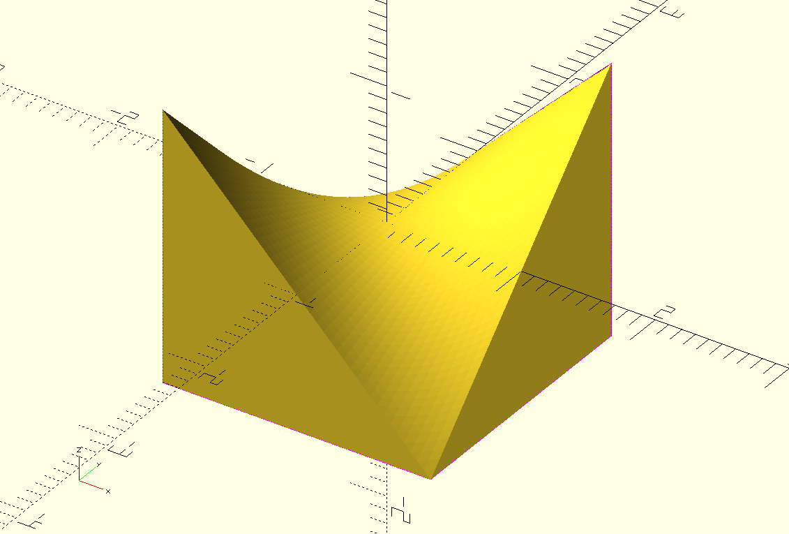

Or maybe this shape is more useful.
​xmin = -1;
xmax = 1;
ymin = -1;
ymax = 1;
step = 0.05;
zmin = min(xmin *ymax, xmax * ymin);
function index(x,y) = x * ypoints + y + 2;
points = concat([[xmin, ymin, zmin]],
[[xmax, ymax, zmin]],
y(j), x(i) * y(j)]]);
base = [
[1, 0, index(xpoints -1, 0)],
[0, 1, index(0, ypoints -1)],
[0, index(0, 0), index(xpoints - 1,0)],
[0, index(0, ypoints -1), index(0, 0)],
[1, index(xpoints - 1, ypoints - 1), index(0, ypoints -1)],
[1, index(xpoints -1, 0), index(xpoints - 1, ypoints - 1)],

Mekko
Wed, Dec 23, 2015 7:24 PM
That's exactly what I needed. Thank you!
Cutting a sphere with it throws an exception for some reason. This code:
sphere(r=.5, $fn=20);
generates this error:
violation! Expr: e->incident_sface() != SFace_const_handle() File:
/data/OpenSCAD/libraries-mingw32-master/mxe/usr/i686-w64-mingw32.static/include/CGAL/Nef_S2/SM_const_decorator.h
Line: 326
Suggestions?
View this message in context: http://forum.openscad.org/intersecting-with-an-hyperbola-tp15280p15291.html
That's exactly what I needed. Thank you! Cutting a sphere with it throws an exception for some reason. This code: difference() { sphere(r=.5, $fn=20); polyhedron(points, concat(base, faces)); } generates this error: ERROR: CGAL error in CGAL_Nef_polyhedron3(): CGAL ERROR: assertion violation! Expr: e->incident_sface() != SFace_const_handle() File: /data/OpenSCAD/libraries-mingw32-master/mxe/usr/i686-w64-mingw32.static/include/CGAL/Nef_S2/SM_const_decorator.h Line: 326 Suggestions? -- View this message in context: http://forum.openscad.org/intersecting-with-an-hyperbola-tp15280p15291.html Sent from the OpenSCAD mailing list archive at Nabble.com.
Wed, Dec 23, 2015 7:37 PM
It is because I closed the faces with single triangles creating lots of t
junctions where the small triangles meet. It needs to be closed with
triangle fans, my mistake.
polyhedron(points, concat(base, faces), convexity = 2);

Actually it still doesn't work. I found one bug but I am stuck now. The error as gone away but it still doesn't render: xmin = -1; xmax = 1; ymin = -1; ymax = 1; step = 0.1; zmin = min(xmin *ymax, xmax * ymin); xpoints = floor((xmax - xmin) / step) + 1; ypoints = floor((ymax - ymin) / step) + 1; function index(x,y) = x * ypoints + y + 2; function x(i) = xmin + i * step; function y(i) = ymin + i * step; points = concat([[xmin, ymin, zmin]], [[xmax, ymax, zmin]], [for(i = [0 : xpoints - 1]) for(j = [0 : ypoints - 1]) [x(i), y(j), x(i) * y(j)]]); function flatten(l) = [for(a = l) for (b = a) b]; base = [ [1, 0, index(xpoints -1, 0)], [0, 1, index(0, ypoints -1)], flatten([for(i = [0 : xpoints - 2]) [0, index(i, 0), index(i + 1, 0)]]), flatten([for(j = [0 : ypoints - 2]) [0, index(0, j + 1), index(0, j)]]), flatten([for(i = [0 : xpoints - 2]) [1, index(i + 1, ypoints - 1), index(i, ypoints - 1)]]), flatten([for(j = [0 : ypoints - 2]) [1, index(xpoints - 1, j), index(xpoints - 1, j + 1)]]), ]; faces = flatten([for(i = [0 : xpoints - 2]) for(j = [0 : ypoints - 2]) [[index(i,j), index(i, j + 1), index(i + 1, j + 1)], [index(i + 1, j + 1), index(i + 1, j ), index(i, j)]] ]); difference() { sphere(r=.5, $fn=20); polyhedron(points, concat(base, faces), convexity = 2); } On 23 December 2015 at 20:04, nop head <nop.head@gmail.com> wrote: > Here is one that works: - > xmin = -1; > xmax = 1; > ymin = -1; > ymax = 1; > step = 0.1; > zmin = min(xmin *ymax, xmax * ymin); > > xpoints = floor((xmax - xmin) / step) + 1; > ypoints = floor((ymax - ymin) / step) + 1; > function index(x,y) = x * ypoints + y + 2; > function x(i) = xmin + i * step; > function y(i) = ymin + i * step; > > points = concat([[xmin, ymin, zmin]], > [[xmax, ymax, zmin]], > [for(i = [0 : xpoints - 1]) for(j = [0 : ypoints - 1]) [x(i), > y(j), x(i) * y(j)]]); > > function flatten(l) = [for(a = l) for (b = a) b]; > > base = [ > [1, 0, index(xpoints -1, 0)], > [0, 1, index(0, ypoints -1)], > flatten([for(i = [0 : xpoints - 2]) [0, index(i, 0), index(i + > 1,0)]]), > flatten([for(j = [0 : ypoints - 2]) [0, index(0, j), index(0, j + > 1)]]), > flatten([for(i = [0 : xpoints - 2]) [1, index(i + 1, ypoints - 1), > index(i, ypoints - 1)]]), > flatten([for(j = [0 : ypoints - 2]) [1, index(xpoints - 1, j), > index(xpoints - 1, j + 1)]]), > ]; > > faces = flatten([for(i = [0 : xpoints - 2]) for(j = [0 : ypoints - 2]) > [[index(i,j), index(i, j + 1), index(i + 1, j + 1)], > [index(i + 1, j + 1), index(i + 1, j ), index(i, j)]] > ]); > > > difference() { > sphere(r=.5, $fn=20); > polyhedron(points, concat(base, faces), convexity = 2); > } > > On 23 December 2015 at 19:37, nop head <nop.head@gmail.com> wrote: > >> It is because I closed the faces with single triangles creating lots of t >> junctions where the small triangles meet. It needs to be closed with >> triangle fans, my mistake. >> >> On 23 December 2015 at 19:24, Mekko <serve@perdix.org> wrote: >> >>> That's exactly what I needed. Thank you! >>> >>> Cutting a sphere with it throws an exception for some reason. This code: >>> >>> difference() { >>> sphere(r=.5, $fn=20); >>> polyhedron(points, concat(base, faces)); >>> } >>> >>> generates this error: >>> >>> ERROR: CGAL error in CGAL_Nef_polyhedron3(): CGAL ERROR: assertion >>> violation! Expr: e->incident_sface() != SFace_const_handle() File: >>> >>> /data/OpenSCAD/libraries-mingw32-master/mxe/usr/i686-w64-mingw32.static/include/CGAL/Nef_S2/SM_const_decorator.h >>> Line: 326 >>> >>> Suggestions? >>> >>> >>> >>> >>> >>> -- >>> View this message in context: >>> http://forum.openscad.org/intersecting-with-an-hyperbola-tp15280p15291.html >>> Sent from the OpenSCAD mailing list archive at Nabble.com. >>> >>> _______________________________________________ >>> OpenSCAD mailing list >>> Discuss@lists.openscad.org >>> http://lists.openscad.org/mailman/listinfo/discuss_lists.openscad.org >>> >> >> >
Wed, Dec 23, 2015 8:40 PM
In fact the error is still there when I flush the caches.
xmin = -1;
xmax = 1;
ymin = -1;
ymax = 1;
step = 0.1;
base = [
0)]]),
j)]]),
xmin = -1;
xmax = 1;
ymin = -1;
ymax = 1;
step = 0.1;
base = [
1,0)]]),
1)]]),

Wed, Dec 23, 2015 11:01 PM
This stuff is way over my head but FWIW, this code:
sphere(r=.5, $fn=80);
generates a preview of a zero-thickness contour (that looks like a potato
chip). That is, the intersection() shows only where the surface of the
polyhedron intersects with the volume of the sphere and excludes all the
volume that the two objects share.
Maybe that is useful to know.
