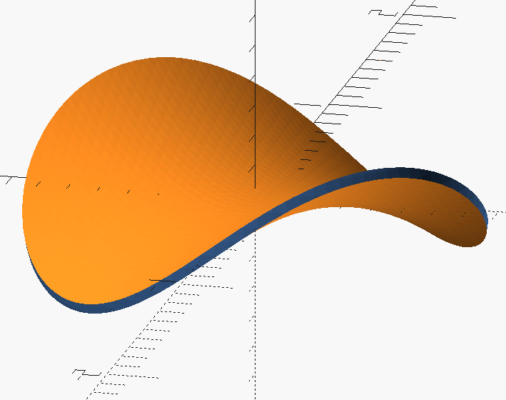

ah,... you are the guy with the potatoe chip.
Sorry, got your specification wrong.
  • calc points of upper and lower surface
  • calc triangles of upper and lower surface
  • calc triangles of border
Good idea to cut the square plot with a sphere!
http://forum.openscad.org/file/n15307/showcase13.png
I guess this is your code:
N = 140;
range = [for (i=[0:N-1]) -1+i*2/(N-1)];
upper = point_function(range, .1);  // upper face
lower = point_function(range, 0);  // lower face
Faces = concat(
triangles(N, upper),
triangles(N, lower, true),
triangles_border(N));
Points = concat(upper, lower);
intersection()
sphere(1, $fn = 100);
polyhedron(faces = Faces, points = Points, convexity=3);

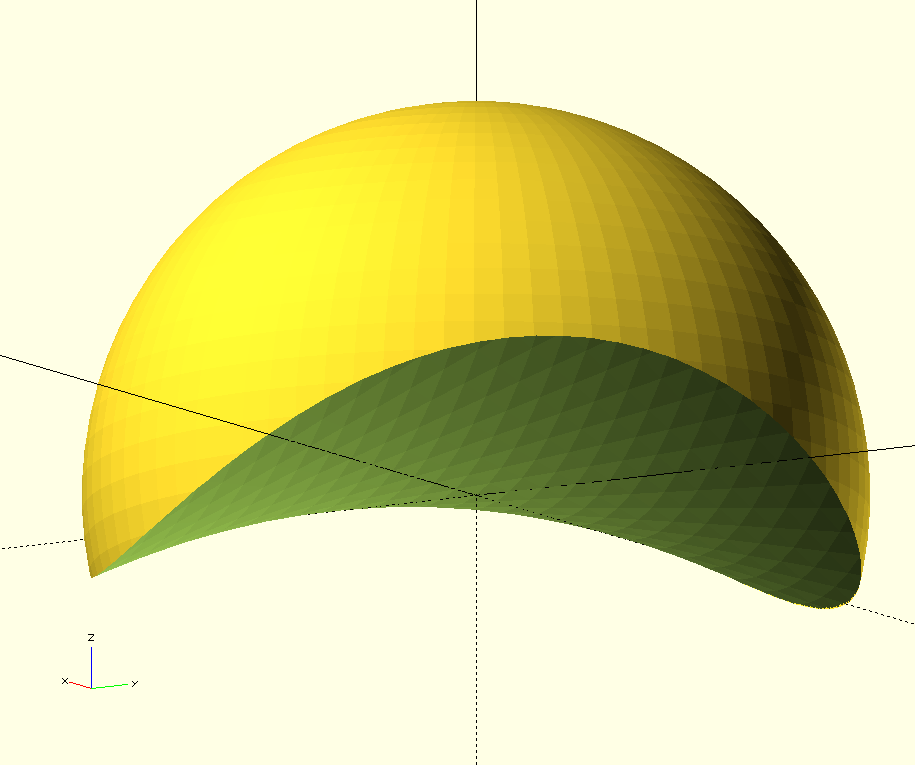

Neon22
Thu, Dec 24, 2015 6:07 AM
and having fun with thickness of chip :)
N = 40;
thick = 1;
sphere_res = 100;
upper = point_function(range, thick);  // upper face
Faces = concat(
intersection()
translate([0,0,thick/2])
sphere(1, $fn = sphere_res);
.. and the rest
gives
http://forum.openscad.org/file/n15308/sample-hyperbola.png
View this message in context: http://forum.openscad.org/intersecting-with-an-hyperbola-tp15280p15308.html

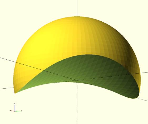

Thu, Dec 24, 2015 7:45 AM
LOL. Actually, I'm not the potato chip guy - I'm just trying to cut a sphere
in half with an hyperbola and getting a potato chip instead.
Hopefully the true Potato Chip Guy is reading this thread though!
View this message in context: http://forum.openscad.org/intersecting-with-an-hyperbola-tp15280p15313.html
LOL. Actually, I'm not the potato chip guy - I'm just trying to cut a sphere in half with an hyperbola and getting a potato chip instead. Hopefully the true Potato Chip Guy is reading this thread though! -- View this message in context: http://forum.openscad.org/intersecting-with-an-hyperbola-tp15280p15313.html Sent from the OpenSCAD mailing list archive at Nabble.com.
Thu, Dec 24, 2015 10:01 AM
Here is a version that finally works.
xmin = -1;
xmax = 1;
ymin = -1;
ymax = 1;
step = 0.05;
zmin = min(xmin *ymax, xmax * ymin);
xpoints = floor((xmax - xmin) / step) + 1;
ypoints = floor((ymax - ymin) / step) + 1;
function index(x,y) = x * ypoints + y + 2;
function x(i) = xmin + i * step;
function y(i) = ymin + i * step;
points = concat([[xmin, ymin, zmin]],
[[xmax, ymax, zmin]],
[for(i = [0 : xpoints - 1]) for(j = [0 : ypoints - 1]) [x(i),
y(j), x(i) * y(j)]]);
function flatten(l) = [for(a = l) for (b = a) b];
base = concat(
[[1, 0, index(xpoints - 1, 0)]],
[[0, 1, index(0, ypoints - 1)]],
[for(i = [0 : xpoints - 2]) [0, index(i, 0), index(i + 1, 0)]],
[for(j = [0 : ypoints - 2]) [0, index(0, j + 1), index(0, j)]],
[for(i = [0 : xpoints - 2]) [1, index(i + 1, ypoints - 1), index(i,
ypoints - 1)]],
[for(j = [0 : ypoints - 2]) [1, index(xpoints - 1, j),
index(xpoints - 1, j + 1)]]
faces = flatten([for(i = [0 : xpoints - 2]) for(j = [0 : ypoints - 2])
[[index(i,j), index(i, j + 1), index(i + 1, j + 1)],
[index(i + 1, j + 1), index(i + 1, j ), index(i, j)]]
sphere(r= 0.5, $fn=80);
polyhedron(points, concat(base, faces), convexity = 2);
My stupid mistake was flattening the base list when it didn't need to be.
The result was some faces with multiple triangles instead of single
triangle per face. Looks like cgal can't handle that but the rest of the
system can. The STL file it exported was correct..

Argh ... sorry again. The problem looked so similar. That made me think you
could be the same guy using different names. Maybe you are visiting the same
class? ;-)
By the way, you get both solutions by altering just one number!
// upper = point_function(range, .1);  // upper face
upper = point_function(range, 2);  // upper face
  • Rudolf
<hyperbola.png>
xmin = -1;
xmax = 1;
ymin = -1;
ymax = 1;
step = 0.05;
[for(i = [0 : xpoints - 1]) for(j = [0 : ypoints - 1]) [x(i), y(j), x(i) * y(j)]]);
base = concat(
[for(i = [0 : xpoints - 2]) [1, index(i + 1, ypoints - 1), index(i, ypoints - 1)]],
[for(j = [0 : ypoints - 2]) [1, index(xpoints - 1, j), index(xpoints - 1, j + 1)]]
My stupid mistake was flattening the base list when it didn't need to be. The result was some faces with multiple triangles instead of single triangle per face. Looks like cgal can't handle that but the rest of the system can. The STL file it exported was correct..
