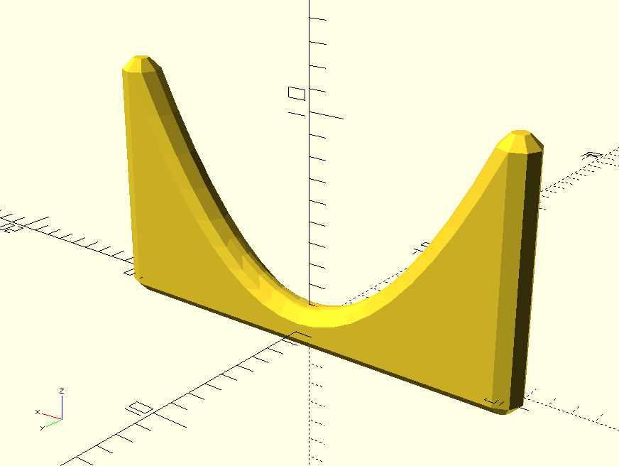

This depends somewhat on what kind of resolution you need.
You can stitch together a polyhedron from scratch.
Or you use the easy to understand, but slow chain-hull method.
Here is an example for a one dimensional case: z=x*x.
Generalize it to two dimensions and your good to go.
Just limit the $fn of the spheres to small numbers.
for (i=[-10:10-1]){
hull(){
s(i);
s(i+1);
t(i);
t(i+1);
module s(i){
translate([i,0,0.1ii])sphere(r=1,$fn=8);
}module t(i){
translate([i,0,0])sphere(r=1,$fn=8);

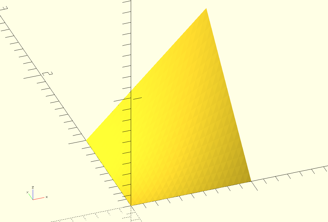

Wed, Dec 23, 2015 5:32 PM
It looks like this: -
Here is the code I used to make it:
xmin = 0;
xmax = 1;
ymin = 0;
ymax = 1;
step = 0.05;
xpoints = floor((xmax - xmin) / step) + 1;
ypoints = floor((ymax - ymin) / step) + 1;
function index(x,y) = x * ypoints + y + 1;
function x(i) = xmin + i * step;
function y(i) = ymin + i * step;
points = concat([[x(xpoints - 1), y(ypoints - 1), 0]],
[for(i = [0 : xpoints - 1]) for(j = [0 : ypoints - 1]) [x(i),
y(j), x(i) * y(j)]]);
function flatten(l) = [for(a = l) for (b = a) b];
base = [[0, 1, index(xpoints -1, 0)],
[1, 0, index(0, ypoints -1)],
[0, index(xpoints - 1, ypoints - 1), index(0, ypoints - 1)],
[0, index(xpoints - 1, 0), index(xpoints - 1, ypoints - 1)],
faces = flatten([for(i = [0 : xpoints - 2]) for(j = [0 : ypoints - 2])
[[index(i,j), index(i, j + 1), index(i + 1, j + 1)],
[index(i + 1, j + 1), index(i + 1, j ), index(i, j)]]
polyhedron(points, concat(base, faces));
