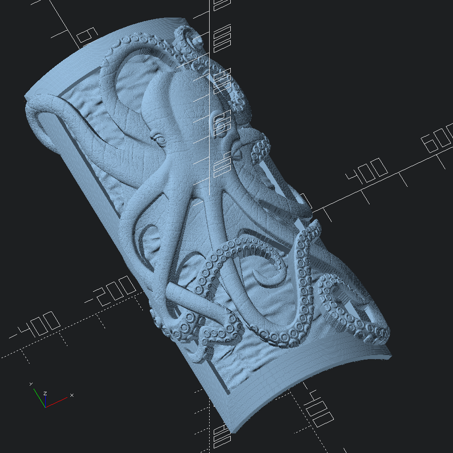

On May 11, 2022, at 4:48 PM, Adrian Mariano avm4@cornell.edu wrote:
You could definitely shrink the VNF from something like that, which would
probably help.  You could decrease the number of points in your image.
But also, the slow part of vnf_bend() is slicing the VNF into strips.  The
VNF you have there from the image I think is already in strips!  The hard
part has been done.  So you could just remap the points yourself without
going through vnf_bend().  That would be fast.

No doubt.  But it is always interesting to try! Here is what it was
freezing on.
<result2.png>
It is something like this that would be nice to bend ... in this case a
few degrees in the Y axis.
But, anyway, just so you know, Revar,  This was created from a data file
that was created using your python script, heightfield(), and
vnf_polyhedron().  Took less than a minute runtime.  Beautiful, indeed.

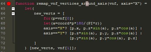

Thu, May 12, 2022 12:12 AM
function remap_vnf_vertices_around_axis(vnf, axis=“X”) =
let(
new_verts = [
for(p=vnf[0])
let(a=coordp180/(PIr))
axis=="X"? [p.x, p.z
sin(a), p.zcos(a)] :
axis=="Y"? [p.z
sin(a), p.y, p.zcos(a)] :
[p.y
sin(a), p.y*cos(a), p.z]
) [new_verts, vnf[1]];
-Revar

ERROR: Parser error: syntax error in file flourishTest.scad, line 64
Happens when I place that funcion code into the program
[image: 2022-05-11_20-37-42.png]
Also ... where is the variable "r" in (PI*r) originating? How do I call it?
x = remap_vnf_vertices-around_axis( vnfArray, axis="Y" ) ?

ERROR: Parser error: syntax error in file flourishTest.scad, line 64 Happens when I place that funcion code into the program [image: 2022-05-11_20-37-42.png] Also ... where is the variable "r" in (PI*r) originating? How do I call it? x = remap_vnf_vertices-around_axis( vnfArray, axis="Y" ) ? On Wed, May 11, 2022 at 8:12 PM Revar Desmera <revarbat@gmail.com> wrote: > function remap_vnf_vertices_around_axis(vnf, axis=“X”) = > > let( > > new_verts = [ > > for(p=vnf[0]) > > let(a=coord*p*180/(PI*r)) > > axis=="X"? [p.x, p.z*sin(a), p.z*cos(a)] : > > axis=="Y"? [p.z*sin(a), p.y, p.z*cos(a)] : > > [p.y*sin(a), p.y*cos(a), p.z] > > ] > > ) [new_verts, vnf[1]]; > > > -Revar > > > On May 11, 2022, at 4:51 PM, Revar Desmera <revarbat@gmail.com> wrote: > > Actually yes, the triangulation is small enough that you can just re-map > the vertices into a curve without splitting vertices. That should be much > faster. > > - Revar > > > On May 11, 2022, at 4:48 PM, Adrian Mariano <avm4@cornell.edu> wrote: > > You could definitely shrink the VNF from something like that, which would > probably help. You could decrease the number of points in your image. > > But also, the slow part of vnf_bend() is slicing the VNF into strips. The > VNF you have there from the image I think is already in strips! The hard > part has been done. So you could just remap the points yourself without > going through vnf_bend(). That would be fast. > > On Wed, May 11, 2022 at 7:41 PM Joe Weinpert <joe.weinpert@gmail.com> > wrote: > >> No doubt. But it is always interesting to try! Here is what it was >> freezing on. >> >> <result2.png> >> >> It is something like this that would be nice to bend ... in this case a >> few degrees in the Y axis. >> >> But, anyway, just so you know, Revar, This was created from a data file >> that was created using your python script, heightfield(), and >> vnf_polyhedron(). Took less than a minute runtime. Beautiful, indeed. >> >> >> >> >> >> On Wed, May 11, 2022 at 7:18 PM Revar Desmera <revarbat@gmail.com> wrote: >> >>> 420k vertices and 823k faces, bending with $fs=0.01… That is an >>> excessive degree of detail for OpenSCAD, I’m afraid. >>> >>> - Revar >>> >>> >>> On May 11, 2022, at 4:09 PM, Joe Weinpert <joe.weinpert@gmail.com> >>> wrote: >>> >>> >>> $fs=.01 >>> >>> After running for a couple of hours it came up with: >>> >>> WARNING: Bad range parameter in for statement: too many elements >>> (2551818) in file Documents/OpenSCAD/libraries/BOSL2/math.scad, line 57 >>> WARNING: Bad range parameter in for statement: too many elements >>> (2551818) in file Documents/OpenSCAD/libraries/BOSL2/vnf.scad, line 647 >>> WARNING: Bad range parameter in for statement: too many elements >>> (2551818) in file Documents/OpenSCAD/libraries/BOSL2/vnf.scad, line 648 >>> WARNING: Bad range parameter in for statement: too many elements >>> (2551818) in file Documents/OpenSCAD/libraries/BOSL2/lists.scad, line 428 >>> >>> WARNING: Bad range parameter in for statement: too many elements >>> (2551818) in file Documents/OpenSCAD/libraries/BOSL2/vnf.scad, line 650 >>> >>> and then did not finish. >>> >>> Choked to death, I guess. >>> >>> >>> >>> >>> On Wed, May 11, 2022 at 4:27 PM Adrian Mariano <avm4@cornell.edu> wrote: >>> >>>> I think vnf_bend is pretty slow. It has to first cut up your input >>>> into strips (so that means line-plane intersections with every edge in >>>> your data) and then once that's done, it maps it to the cylinder, >>>> which is fairly fast in comparison. I have not done rigorous timing >>>> tests. I think time will mainly depend on the number of edges, so you >>>> could try using 1% of your faces and see how long it takes. The >>>> result will be garbage (a non-manifold partial result ) but it will >>>> give you some idea of time. Then you can try 2% and see what happens, >>>> 5%, etc. That will give you a way to predict how long your real >>>> problem will take. >>>> >>>> I think that you probably will need to find a way to simplify the >>>> problem, but the above exercise will tell you how much it needs to be >>>> simplified. >>>> >>>> On Wed, May 11, 2022 at 2:24 PM Joe Weinpert <joe.weinpert@gmail.com> >>>> wrote: >>>> > >>>> > >>>> > len( vnf[0] ) = 420204 >>>> > >>>> > len( vnf[1] ) = 823326 >>>> > >>>> > >>>> > If the length of the vnf array I am trying to bend is as large as >>>> what was echoed above, am I whistling past the graveyard to try and get >>>> this: >>>> > >>>> > >>>> > bent1 = vnf_bend( vnf, axis = "Y" ); >>>> > >>>> > >>>> > to work? Machine just stops forever until I force openSCAD to close. >>>> > >>>> > >>>> > _______________________________________________ >>>> > OpenSCAD mailing list >>>> > To unsubscribe send an email to discuss-leave@lists.openscad.org >>>> _______________________________________________ >>>> OpenSCAD mailing list >>>> To unsubscribe send an email to discuss-leave@lists.openscad.org >>>> >>> _______________________________________________ >>> OpenSCAD mailing list >>> To unsubscribe send an email to discuss-leave@lists.openscad.org >>> >>> >>> _______________________________________________ >>> OpenSCAD mailing list >>> To unsubscribe send an email to discuss-leave@lists.openscad.org >>> >> _______________________________________________ >> OpenSCAD mailing list >> To unsubscribe send an email to discuss-leave@lists.openscad.org >> > _______________________________________________ > OpenSCAD mailing list > To unsubscribe send an email to discuss-leave@lists.openscad.org > > > > _______________________________________________ > OpenSCAD mailing list > To unsubscribe send an email to discuss-leave@lists.openscad.org >
Thu, May 12, 2022 6:33 AM
Partly my bad for cut-and-paste coding on the fly, partly Apple replacing my quotes with “smart” curly quotes.  Right.  Forgot this replacement laptop hasn't ever had me turn all that off. Lets try this again with actual testing:

Partly my bad for cut-and-paste coding on the fly, partly Apple replacing my quotes with “smart” curly quotes. Right. Forgot this replacement laptop hasn't ever had me turn all that off. Lets try this again with actual testing: include <BOSL2/std.scad> include <foof.scad> function remap_vnf_vertices_around_axis(vnf, r, bend_scale=1, axis="X") = let( coord = axis=="X" ? BACK : RIGHT, new_verts = [ for(p=vnf[0]) let(a=coord*p*180/(PI*r)*bend_scale) axis=="X"? [p.x, p.z*sin(a), p.z*cos(a)] : axis=="Y"? [p.z*sin(a), p.y, p.z*cos(a)] : [p.y*sin(a), p.y*cos(a), p.z] ] ) [new_verts, vnf[1]]; vnf = up(20, p=heightfield(foof/255.0*2, bottom=0, anchor=BOT)); vnf2 = remap_vnf_vertices_around_axis(vnf, 50, 2); vnf_polyhedron(vnf2); -Revar > On May 11, 2022, at 5:48 PM, Joe Weinpert <joe.weinpert@gmail.com> wrote: > > > ERROR: Parser error: syntax error in file flourishTest.scad, line 64 <> > > Happens when I place that funcion code into the program > > <2022-05-11_20-37-42.png> > > Also ... where is the variable "r" in (PI*r) originating? How do I call it? > x = remap_vnf_vertices-around_axis( vnfArray, axis="Y" ) ? > > > > > On Wed, May 11, 2022 at 8:12 PM Revar Desmera <revarbat@gmail.com <mailto:revarbat@gmail.com>> wrote: > function remap_vnf_vertices_around_axis(vnf, axis=“X”) = > let( > new_verts = [ > for(p=vnf[0]) > let(a=coord*p*180/(PI*r)) > axis=="X"? [p.x, p.z*sin(a), p.z*cos(a)] : > axis=="Y"? [p.z*sin(a), p.y, p.z*cos(a)] : > [p.y*sin(a), p.y*cos(a), p.z] > ] > ) [new_verts, vnf[1]]; > > -Revar > > >> On May 11, 2022, at 4:51 PM, Revar Desmera <revarbat@gmail.com <mailto:revarbat@gmail.com>> wrote: >> >> Actually yes, the triangulation is small enough that you can just re-map the vertices into a curve without splitting vertices. That should be much faster. >> >> - Revar >> >> >>> On May 11, 2022, at 4:48 PM, Adrian Mariano <avm4@cornell.edu <mailto:avm4@cornell.edu>> wrote: >>> >>> You could definitely shrink the VNF from something like that, which would probably help. You could decrease the number of points in your image. >>> >>> But also, the slow part of vnf_bend() is slicing the VNF into strips. The VNF you have there from the image I think is already in strips! The hard part has been done. So you could just remap the points yourself without going through vnf_bend(). That would be fast. >>> >>> On Wed, May 11, 2022 at 7:41 PM Joe Weinpert <joe.weinpert@gmail.com <mailto:joe.weinpert@gmail.com>> wrote: >>> No doubt. But it is always interesting to try! Here is what it was freezing on. >>> >>> <result2.png> >>> >>> It is something like this that would be nice to bend ... in this case a few degrees in the Y axis. >>> >>> But, anyway, just so you know, Revar, This was created from a data file that was created using your python script, heightfield(), and vnf_polyhedron(). Took less than a minute runtime. Beautiful, indeed. >>> >>> >>> >>> >>> >>> On Wed, May 11, 2022 at 7:18 PM Revar Desmera <revarbat@gmail.com <mailto:revarbat@gmail.com>> wrote: >>> 420k vertices and 823k faces, bending with $fs=0.01… That is an excessive degree of detail for OpenSCAD, I’m afraid. >>> >>> - Revar >>> >>> >>>> On May 11, 2022, at 4:09 PM, Joe Weinpert <joe.weinpert@gmail.com <mailto:joe.weinpert@gmail.com>> wrote: >>>> >>>> >>>> $fs=.01 >>>> >>>> After running for a couple of hours it came up with: >>>> >>>> WARNING: Bad range parameter in for statement: too many elements (2551818) in file Documents/OpenSCAD/libraries/BOSL2/math.scad, line 57 <> >>>> WARNING: Bad range parameter in for statement: too many elements (2551818) in file Documents/OpenSCAD/libraries/BOSL2/vnf.scad, line 647 <> >>>> WARNING: Bad range parameter in for statement: too many elements (2551818) in file Documents/OpenSCAD/libraries/BOSL2/vnf.scad, line 648 <> >>>> WARNING: Bad range parameter in for statement: too many elements (2551818) in file Documents/OpenSCAD/libraries/BOSL2/lists.scad, line 428 <> >>>> WARNING: Bad range parameter in for statement: too many elements (2551818) in file <>Documents/OpenSCAD/libraries/BOSL2/vnf.scad, line 650 <> >>>> >>>> and then did not finish. >>>> >>>> Choked to death, I guess. >>>> >>>> >>>> >>>> >>>> On Wed, May 11, 2022 at 4:27 PM Adrian Mariano <avm4@cornell.edu <mailto:avm4@cornell.edu>> wrote: >>>> I think vnf_bend is pretty slow. It has to first cut up your input >>>> into strips (so that means line-plane intersections with every edge in >>>> your data) and then once that's done, it maps it to the cylinder, >>>> which is fairly fast in comparison. I have not done rigorous timing >>>> tests. I think time will mainly depend on the number of edges, so you >>>> could try using 1% of your faces and see how long it takes. The >>>> result will be garbage (a non-manifold partial result ) but it will >>>> give you some idea of time. Then you can try 2% and see what happens, >>>> 5%, etc. That will give you a way to predict how long your real >>>> problem will take. >>>> >>>> I think that you probably will need to find a way to simplify the >>>> problem, but the above exercise will tell you how much it needs to be >>>> simplified. >>>> >>>> On Wed, May 11, 2022 at 2:24 PM Joe Weinpert <joe.weinpert@gmail.com <mailto:joe.weinpert@gmail.com>> wrote: >>>> > >>>> > >>>> > len( vnf[0] ) = 420204 >>>> > >>>> > len( vnf[1] ) = 823326 >>>> > >>>> > >>>> > If the length of the vnf array I am trying to bend is as large as what was echoed above, am I whistling past the graveyard to try and get this: >>>> > >>>> > >>>> > bent1 = vnf_bend( vnf, axis = "Y" ); >>>> > >>>> > >>>> > to work? Machine just stops forever until I force openSCAD to close. >>>> > >>>> > >>>> > _______________________________________________ >>>> > OpenSCAD mailing list >>>> > To unsubscribe send an email to discuss-leave@lists.openscad.org <mailto:discuss-leave@lists.openscad.org> >>>> _______________________________________________ >>>> OpenSCAD mailing list >>>> To unsubscribe send an email to discuss-leave@lists.openscad.org <mailto:discuss-leave@lists.openscad.org> >>>> _______________________________________________ >>>> OpenSCAD mailing list >>>> To unsubscribe send an email to discuss-leave@lists.openscad.org <mailto:discuss-leave@lists.openscad.org> >>> >>> _______________________________________________ >>> OpenSCAD mailing list >>> To unsubscribe send an email to discuss-leave@lists.openscad.org <mailto:discuss-leave@lists.openscad.org> >>> _______________________________________________ >>> OpenSCAD mailing list >>> To unsubscribe send an email to discuss-leave@lists.openscad.org <mailto:discuss-leave@lists.openscad.org> >>> _______________________________________________ >>> OpenSCAD mailing list >>> To unsubscribe send an email to discuss-leave@lists.openscad.org <mailto:discuss-leave@lists.openscad.org> >> > > _______________________________________________ > OpenSCAD mailing list > To unsubscribe send an email to discuss-leave@lists.openscad.org <mailto:discuss-leave@lists.openscad.org> > _______________________________________________ > OpenSCAD mailing list > To unsubscribe send an email to discuss-leave@lists.openscad.org
Thu, May 12, 2022 7:57 AM
I should note that the r argument basically means that something that is that far above the XY plane will be the same size wrapped around the cylinder.  ie: If you raise something 20mm above the XY plane, then wrap it with r=20, then the part of the un-bent shape that was originally at the XY plane should be 1:1 sized at the surface of the 20mm radius cylinder.
The backside isn't bent quite right with the vertex-only warp, but after differencing a cylinder away, I get this:
  • Revar
 let(
     new_verts = [
         for(p=vnf[0])
-Revar

Thu, May 12, 2022 8:40 PM
Been running a lot of different pics for testing.  It is all working great.
This really opens a huge door for using *openSCAD *and *BOSL2 *to easily
render intricately wrapped designs that are needed in woodworking.  Hope
that you place this new feature into the BOSL2.library.  Until then, I will
continue using the python script and bending function you designed and
developed.  And will post any other question I run across.
[image: octoBent.png]
