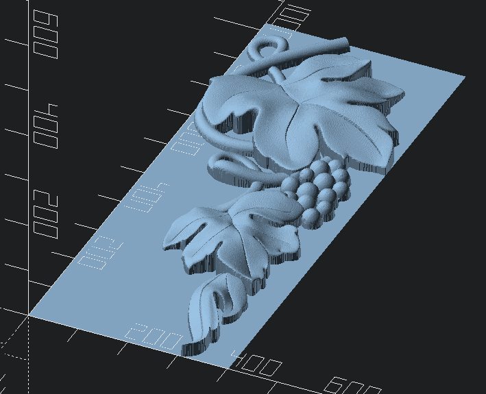

No doubt.  But it is always interesting to try! Here is what it was
freezing on.
[image: result2.png]
It is something like this that would be nice to bend ... in this case a few
degrees in the Y axis.
But, anyway, just so you know, Revar,  This was created from a data file
that was created using your python script, heightfield(), and
vnf_polyhedron().  Took less than a minute runtime.  Beautiful, indeed.

You could definitely shrink the VNF from something like that, which would
probably help.  You could decrease the number of points in your image.
But also, the slow part of vnf_bend() is slicing the VNF into strips.  The
VNF you have there from the image I think is already in strips!  The hard
part has been done.  So you could just remap the points yourself without
going through vnf_bend().  That would be fast.

No doubt.  But it is always interesting to try! Here is what it was freezing on.
<result2.png>
It is something like this that would be nice to bend ... in this case a few degrees in the Y axis.
But, anyway, just so you know, Revar,  This was created from a data file that was created using your python script, heightfield(), and vnf_polyhedron().  Took less than a minute runtime.  Beautiful, indeed.
<result2.png>
On Wed, May 11, 2022 at 7:18 PM Revar Desmera <revarbat@gmail.com mailto:revarbat@gmail.com> wrote:
420k vertices and 823k faces, bending with $fs=0.01… That is an excessive degree of detail for OpenSCAD, I’m afraid.
freezing on.
<result2.png>
  • Revar
