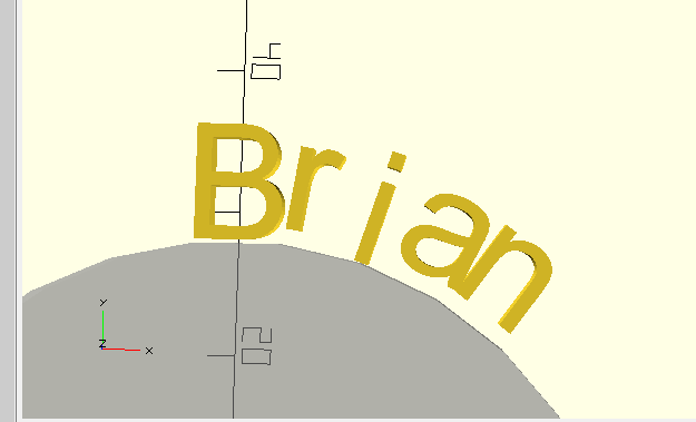

I am new to openscad, so if this is an obvious error I apologize for
wasting anyone's time.  I am trying to write text partially around a
cylinder.  I thought I worked through the code to do it, but some of the
letters are not sitting on the cylinder, and also the letter spacing is
inconsistent. Here is the code and screenshot of what I see. Code is
attached.

You have set valign to "center", so each letter is centered
vertically.  You should use the default (don't set it) or set it to
"baseline".  Note that you'll still have problems with letter spacing.
You need to either use the experimental textmetrics feature in a
recent dev snapshot or you need to use a monospaced font, or you need
to hand tune the spacing of each ltter.  As far as I know, there's no
way to predict the spacing you need even in a monospaced font, so
without textmetrics is all going to be trial and error to get a good
looking letter spacing.

To see what's going on, try the output in a few different ways. See
attached.
Centering vertically first is probably not what you want to do.  It centers
each individual letter, regardless of the letter's actual size. Then by
rotating to move the letter to its final place, you are moving the center,
and that's not going to work.
I think rather than rotating the letters into position, you want to rotate
first, then move the bottom center of each letter outward by the required
distance.
for(i = [0 : chars_len - 1]) {
translate([sin(i*14)radius,cos(i14)radius,0])
rotate([0,0,-(i
14)])
linear_extrude(height = 3){text(
name[i],
font = "Arial",
size = font_size,
halign = "center");
Note that arial is a proportional font, so the width of each character is
different.  You may want to take that into account somehow when
incrementing the angle, currently fixed at 14 degree intervals.

Thanks guys,
Adrian,the valign correction got me on the right path.  I was viewing the
spacing and v-alignment as a single issue, once it was pointed out that
they were separate, I made my way onto the same thought path as Patrick but
the maths eluded me.  Thank you Patrick.  Im going to play around with
fonts or possibly see if I can work up (or find) a table for letter
adjustments and work from there.  Thanks again guys.

I don't think that there's anything better about Patrick's method
compared to your original method.  Basically both can work and produce
the same result.  I believe that somewhere on thingiverse there's a
package that has huge tables of text sizes if you want to go that
route.  (Is this mailing list archived somewhere?  It was mentioned a
few months ago.)  But fundamentally using textmetrics is the only way
to be robust, because that's using the data from your actual font.

Note that arial is a proportional font, so the width of each character is different.  You may want to take that into account somehow when incrementing the angle, currently fixed at 14 degree intervals.

You can use textmetrics() if you install the OpenSCAD nightlies.
a=textmetrics(name[i],
font = "Arial",
size = font_size,
halign = "center"))
a.size[0] will represent the width of the character.
but now we want to position each character at an angle that depends on the
width of the character plus the angle calculated for all the
previous characters.
Is some kind of recursion the only answer here or can it be done inline?
-Pat

On Fri, Nov 26, 2021 at 11:01 AM brian s bschaulejr@gmail.com wrote:
Thanks guys,
the spacing and v-alignment as a single issue, once it was pointed out that

Typography! Always a fun thing to do.
attached.
centers each individual letter, regardless of the letter's actual size.
Then by rotating to move the letter to its final place, you are moving the
center, and that's not going to work.
rotate first, then move the bottom center of each letter outward by the
required distance.
rotate([0,0,-(i
14)])
name[i],
font = "Arial",
size = font_size,
halign = "center");
You can use textmetrics() if you install the OpenSCAD nightlies. a=textmetrics(name[i], font = "Arial", size = font_size, halign = "center")) a.size[0] will represent the width of the character. but now we want to position each character at an angle that depends on the width of the character plus the angle calculated for all the previous characters. Is some kind of recursion the only answer here or can it be done inline? -Pat On Fri, Nov 26, 2021 at 11:15 AM Adrian Mariano <avm4@cornell.edu> wrote: > I don't think that there's anything better about Patrick's method > compared to your original method. Basically both can work and produce > the same result. I believe that somewhere on thingiverse there's a > package that has huge tables of text sizes if you want to go that > route. (Is this mailing list archived somewhere? It was mentioned a > few months ago.) But fundamentally using textmetrics is the only way > to be robust, because that's using the data from your actual font. > > On Fri, Nov 26, 2021 at 11:01 AM brian s <bschaulejr@gmail.com> wrote: > > > > Thanks guys, > > Adrian,the valign correction got me on the right path. I was viewing > the spacing and v-alignment as a single issue, once it was pointed out that > they were separate, I made my way onto the same thought path as Patrick but > the maths eluded me. Thank you Patrick. Im going to play around with > fonts or possibly see if I can work up (or find) a table for letter > adjustments and work from there. Thanks again guys. > > > > > > > > > > Thank You > > > > Brian V Schaule Jr > > bschaulejr@gmail.com > > > > > > > > On Fri, Nov 26, 2021 at 10:19 AM Patrick Callahan < > pat.callahan1@gmail.com> wrote: > >> > >> > >> > >> On Fri, Nov 26, 2021 at 8:41 AM brian s <bschaulejr@gmail.com> wrote: > >>> > >>> > >>> > >>> I am new to openscad, so if this is an obvious error I apologize for > wasting anyone's time. I am trying to write text partially around a > cylinder. I thought I worked through the code to do it, but some of the > letters are not sitting on the cylinder, and also the letter spacing is > inconsistent. Here is the code and screenshot of what I see. Code is > attached. > >>> > >> > >> > >>> > >>> <snip> > >> > >> Typography! Always a fun thing to do. > >> > >> To see what's going on, try the output in a few different ways. See > attached. > >> > >> Centering vertically first is probably not what you want to do. It > centers each individual letter, regardless of the letter's actual size. > Then by rotating to move the letter to its final place, you are moving the > center, and that's not going to work. > >> > >> I think rather than rotating the letters into position, you want to > rotate first, then move the bottom center of each letter outward by the > required distance. > >> > >> for(i = [0 : chars_len - 1]) { > >> translate([sin(i*14)*radius,cos(i*14)*radius,0]) > >> rotate([0,0,-(i*14)]) > >> linear_extrude(height = 3){text( > >> name[i], > >> font = "Arial", > >> size = font_size, > >> halign = "center"); > >> > >> Note that arial is a proportional font, so the width of each character > is different. You may want to take that into account somehow when > incrementing the angle, currently fixed at 14 degree intervals. > >> > >> _______________________________________________ > >> OpenSCAD mailing list > >> To unsubscribe send an email to discuss-leave@lists.openscad.org > > > > _______________________________________________ > > OpenSCAD mailing list > > To unsubscribe send an email to discuss-leave@lists.openscad.org > _______________________________________________ > OpenSCAD mailing list > To unsubscribe send an email to discuss-leave@lists.openscad.org >
Fri, Nov 26, 2021 6:25 PM
Yes, you're getting closer to how the BOSL2 path_text() function works
if you enable the text metrics.  You want to use the "advance" value
returned by text metrics, not "size".  I would argue that it's better
to think in terms of arc length instead of angle.  That approach can
generalize to any path instead of just circles.  In order to position
each character you need to know the position of the previous
character, which requires a cumulative sum.  This cannot be done with
a list comprehension "inline" as you say.  It should be done using
recursion to write a cumulative sum function.

Yes, you're getting closer to how the BOSL2 path_text() function works if you enable the text metrics. You want to use the "advance" value returned by text metrics, not "size". I would argue that it's better to think in terms of arc length instead of angle. That approach can generalize to any path instead of just circles. In order to position each character you need to know the position of the previous character, which requires a cumulative sum. This cannot be done with a list comprehension "inline" as you say. It should be done using recursion to write a cumulative sum function. On Fri, Nov 26, 2021 at 12:42 PM Patrick Callahan <pat.callahan1@gmail.com> wrote: > > You can use textmetrics() if you install the OpenSCAD nightlies. > > a=textmetrics(name[i], > font = "Arial", > size = font_size, > halign = "center")) > a.size[0] will represent the width of the character. > but now we want to position each character at an angle that depends on the width of the character plus the angle calculated for all the previous characters. > > Is some kind of recursion the only answer here or can it be done inline? > > -Pat > > > On Fri, Nov 26, 2021 at 11:15 AM Adrian Mariano <avm4@cornell.edu> wrote: >> >> I don't think that there's anything better about Patrick's method >> compared to your original method. Basically both can work and produce >> the same result. I believe that somewhere on thingiverse there's a >> package that has huge tables of text sizes if you want to go that >> route. (Is this mailing list archived somewhere? It was mentioned a >> few months ago.) But fundamentally using textmetrics is the only way >> to be robust, because that's using the data from your actual font. >> >> On Fri, Nov 26, 2021 at 11:01 AM brian s <bschaulejr@gmail.com> wrote: >> > >> > Thanks guys, >> > Adrian,the valign correction got me on the right path. I was viewing the spacing and v-alignment as a single issue, once it was pointed out that they were separate, I made my way onto the same thought path as Patrick but the maths eluded me. Thank you Patrick. Im going to play around with fonts or possibly see if I can work up (or find) a table for letter adjustments and work from there. Thanks again guys. >> > >> > >> > >> > >> > Thank You >> > >> > Brian V Schaule Jr >> > bschaulejr@gmail.com >> > >> > >> > >> > On Fri, Nov 26, 2021 at 10:19 AM Patrick Callahan <pat.callahan1@gmail.com> wrote: >> >> >> >> >> >> >> >> On Fri, Nov 26, 2021 at 8:41 AM brian s <bschaulejr@gmail.com> wrote: >> >>> >> >>> >> >>> >> >>> I am new to openscad, so if this is an obvious error I apologize for wasting anyone's time. I am trying to write text partially around a cylinder. I thought I worked through the code to do it, but some of the letters are not sitting on the cylinder, and also the letter spacing is inconsistent. Here is the code and screenshot of what I see. Code is attached. >> >>> >> >> >> >> >> >>> >> >>> <snip> >> >> >> >> Typography! Always a fun thing to do. >> >> >> >> To see what's going on, try the output in a few different ways. See attached. >> >> >> >> Centering vertically first is probably not what you want to do. It centers each individual letter, regardless of the letter's actual size. Then by rotating to move the letter to its final place, you are moving the center, and that's not going to work. >> >> >> >> I think rather than rotating the letters into position, you want to rotate first, then move the bottom center of each letter outward by the required distance. >> >> >> >> for(i = [0 : chars_len - 1]) { >> >> translate([sin(i*14)*radius,cos(i*14)*radius,0]) >> >> rotate([0,0,-(i*14)]) >> >> linear_extrude(height = 3){text( >> >> name[i], >> >> font = "Arial", >> >> size = font_size, >> >> halign = "center"); >> >> >> >> Note that arial is a proportional font, so the width of each character is different. You may want to take that into account somehow when incrementing the angle, currently fixed at 14 degree intervals. >> >> >> >> _______________________________________________ >> >> OpenSCAD mailing list >> >> To unsubscribe send an email to discuss-leave@lists.openscad.org >> > >> > _______________________________________________ >> > OpenSCAD mailing list >> > To unsubscribe send an email to discuss-leave@lists.openscad.org >> _______________________________________________ >> OpenSCAD mailing list >> To unsubscribe send an email to discuss-leave@lists.openscad.org > > _______________________________________________ > OpenSCAD mailing list > To unsubscribe send an email to discuss-leave@lists.openscad.org

I solved the radial text problem using Alexander Pruss's
fontmetrics.scad workaround (already alluded to in this thread) and got
beautiful letter spacing. My code (as well as the aforementioned
library) is available in this Thing:
Beer/Soda Can Insulating Sleeve by fishlet - Thingiverse
https://www.thingiverse.com/thing:5041806
The OpenSCAD code prints radial text on the bottom of a soda can holder
(see the 3rd picture).
Needless to say, I'm looking forward to the upcoming textmetrics feature.
