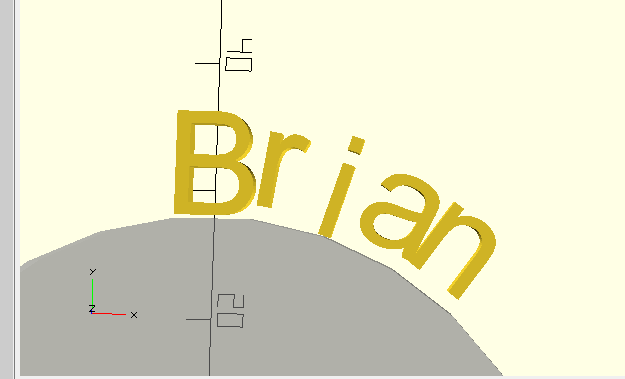

Awesome, Thanks Curt, That font data file is what I needed.
Thanks again to all who chimed in.

On Sun, Nov 28, 2021 at 2:31 AM Curt McDowell maker@fishlet.com wrote:
I solved the radial text problem using Alexander Pruss's fontmetrics.scad
workaround (already alluded to in this thread) and got beautiful letter
spacing. My code (as well as the aforementioned library) is available in
this Thing:
Beer/Soda Can Insulating Sleeve by fishlet - Thingiverse
https://www.thingiverse.com/thing:5041806
The OpenSCAD code prints radial text on the bottom of a soda can holder
(see the 3rd picture).
Needless to say, I'm looking forward to the upcoming textmetrics feature.
Regards,
Curt
On 11/26/2021 5:40 AM, brian s wrote:
I am new to openscad, so if this is an obvious error I apologize for
wasting anyone's time.  I am trying to write text partially around a
cylinder.  I thought I worked through the code to do it, but some of the
letters are not sitting on the cylinder, and also the letter spacing is
inconsistent. Here is the code and screenshot of what I see. Code is
attached.
Thank You
Brian V Schaule Jr
bschaulejr@gmail.com
Thank You
Brian V Schaule Jr
