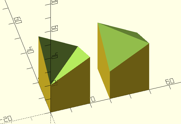

On Sat, Mar 23, 2024 at 10:07:31AM -0400, Marius Kintel wrote:
cam_upper_lid
cam_upper_part
I just tested this on the latest master build and they work fine
with Manifold enabled.
Correct! I thought nothing significant would've changed in the past
month or so as I didn't see any big announcements.
Verfied: Version mid-february still shows the problem. Version march23
does not.

Even the latest version 28-03-2024 has the same issue with manifold.
Luckily I have a 14th Jan 2024 version which works perfectly without any
errors.

Hi Marius,
This same example of Hook has this issue:
you can download it from here:
https://github.com/sprabhakar2006/openSCAD/blob/main/hook.scad
In case any issue in downloading, will send the file through mail
Regards
Sanjeev

Sanjeev,
Oh, you’re referring to that it stops on a warning if you have “stop on first warning” enabled?
We’re considering whether or not we should issue warnings on user-supplied non-manifold topologies, but the easy workaround is to disable that setting in preferences.
-Marius

Sanjeev, Oh, you’re referring to that it stops on a warning if you have “stop on first warning” enabled? We’re considering whether or not we should issue warnings on user-supplied non-manifold topologies, but the easy workaround is to disable that setting in preferences. -Marius > On Mar 29, 2024, at 19:15, Sanjeev Prabhakar <sprabhakar2006@gmail.com> wrote: > > Hi Marius, > This same example of Hook has this issue: > you can download it from here: > https://github.com/sprabhakar2006/openSCAD/blob/main/hook.scad > > In case any issue in downloading, will send the file through mail > Regards > Sanjeev > > On Sat, 30 Mar 2024 at 01:18, Marius Kintel <marius@kintel.net <mailto:marius@kintel.net>> wrote: >> Sanjeev, can you post an example which is broken with 2024-03-28 ? >> >> -Marius >> >>> On Mar 29, 2024, at 12:19, Sanjeev Prabhakar <sprabhakar2006@gmail.com <mailto:sprabhakar2006@gmail.com>> wrote: >>> >>>  >>> Even the latest version 28-03-2024 has the same issue with manifold. >>> >>> Luckily I have a 14th Jan 2024 version which works perfectly without any errors. >>> >>> >>> On Mon, 25 Mar 2024 at 19:56, Marius Kintel via Discuss <discuss@lists.openscad.org <mailto:discuss@lists.openscad.org>> wrote: >>>> > On Mar 25, 2024, at 05:09, Rogier Wolff <R.E.Wolff@BitWizard.nl> wrote: >>>> > >>>> >> I just tested this on the latest master build and they work fine >>>> >> with Manifold enabled. >>>> > >>>> > Correct! I thought nothing significant would've changed in the past >>>> > month or so as I didn't see any big announcements. >>>> > >>>> The big announcement will come once Manifold moves out of experimental :) >>>> We doing a lot of small fixes these days, some of which will enable us to process previously tricky corner cases. >>>> >>>> -Marius >>>> _______________________________________________ >>>> OpenSCAD mailing list >>>> To unsubscribe send an email to discuss-leave@lists.openscad.org <mailto:discuss-leave@lists.openscad.org>
Sat, Mar 30, 2024 4:12 AM
Hi Marius,
Ok, Thanks for the clarification.
Yes with the "stop on first warning" disabled, it is OK.
Regards
Sanjeev
That's a "works as designed". I remember posting something to that
effect before.
OK! I vote: YES, complain on creation of the object that it is not
manifold.
I remember in the old days, say:
difference () {
        cube ([40,40,20]);
    translate ([2,2,2]) cube ([36,36,18]);
    translate ([20,20,2]) cylinder (d=10,h=5);
would throw errors when rendering or result in unusable STLs. That
would be annoying because you'd have no clue where in your design you
did something wrong and it would be hard-to-find when the design is
real-world and not this simple example.
Issue a warning when importing or creating an object that is not
manifold.
Maybe it shouldn't be an error: If you cut off the part that has the
anomaly, then it might still be OK. That might be exactly the reason
the object is being manipulated in openscad.

IMHO, "repairing" is always a bit fishy. The obvious repair may seem
obvious, but it is not guaranteed to have been the intent. In theory
it can be "wrong".
Suppose we have a cube with the top face missing. The obviously right
thing to do is to add two triangles closing the cube.
Now two of the vertices are raised a bit above the other two. Now you
can choose which diagonal to use and get different results is the two
cases.
s=20;
difference () {
cube ([s,s,s*(1+sqrt(.5))]);
translate ([0,0,s*(1+sqrt(.0))]) rotate ([0,-45,-45])cube ([s,2*s,s]);
translate ([1.5*s,0,0])
difference () {
translate ([0,0,s]) rotate ([0,-45,45])translate ([0,-s,0]) cube ([s,2s,s]);
translate ([s,s,s]) rotate ([0,-45,45])translate ([0,-s,0]) cube ([s,2
s,s]);
