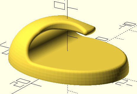

Sometimes a seemingly simple hook is fairly difficult to model.
It really is not trivial as per me.
In case some one else can do this in a simpler method, would like to
understand
https://github.com/sprabhakar2006/openSCAD/blob/main/hook.scad

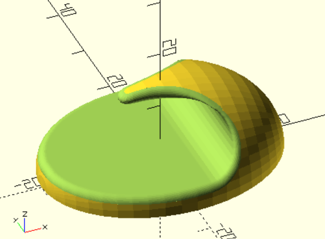

Not fully the same but this is how I would create this in Openscad
Regards Hilbrand Klaver
$fn=$preview?20:100;
  minkowski()
      scale([1.4,1,1])
        sphere(15);
      hull()
        translate([3,0,8.5])
          rotate([90,0,0])
            cylinder(h=50,r=5,center=true);
        translate([-30,0,8.5])
          rotate([90,0,0])
      for (i=[-1,1])
        translate([-4,i*10,10])
          scale([1.2,1,1])
            cylinder(h=10,r=9);
    sphere(1);
  translate([0,0,-20])
    cube([50,50,40],true);

Hi Sanjeev,
Are you using the latest development snapshot with manifold enabled?
(yes I am asking this again...)
The minkowski code takes about 1 minute to render on my machine (<1s if
$fn=20), not really fast but not unusable...

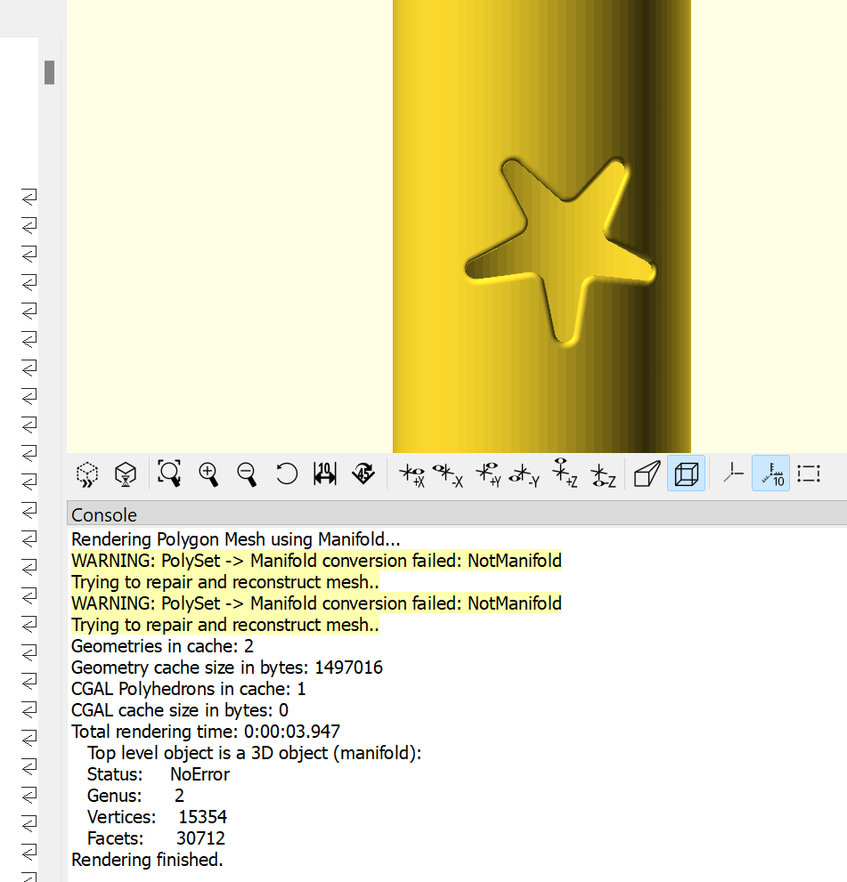

In a few of my models with manifold enabled, there is a rendering problem
if you check the option: "stop on the first warning" in the "advanced" tab
in "preferences"
This issue is observed in the latest nightly. Last one I was using, dated
14th Jan 2024, did not have this issue.
An example:
in "preferences"
The "stop on first warning" is meant to help you find "the first problem"
with your openscad file.
Sometimes a single small error near the top will cause an enormous
cascade of further errors down the line.
Somewhere in the mid eighties my first pascal program compiled with
125 errors! I had missed a semicolon near the top. All other 124
errors were caused by that first missing semicolon.
Anyway, in openscad say a "warning module xyz doesn't exist" might
cause the whole thing of not having a purpose. So you can turn this on
and find the first "problem".
This all has to do with the parsing of the openscad source code and
nothing with the rendering backend "manifold" or whatever.
So... you might have "stop on first warning" enabled and not had any
warnings from previous versions and that some check has gotten a bit
more strict, so that where it previously worked it may not now.

I have the nightly from 19 feb with manifold enabled. Usually works a
charm, but not for these two.
On Tue, Mar 19, 2024 at 07:11:45AM +0530, Sanjeev Prabhakar via Discuss wrote: > In a few of my models with manifold enabled, there is a rendering problem > if you check the option: "stop on the first warning" in the "advanced" tab > in "preferences" The "stop on first warning" is meant to help you find "the first problem" with your openscad file. Sometimes a single small error near the top will cause an enormous cascade of further errors down the line. Somewhere in the mid eighties my first pascal program compiled with 125 errors! I had missed a semicolon near the top. All other 124 errors were caused by that first missing semicolon. Anyway, in openscad say a "warning module xyz doesn't exist" might cause the whole thing of not having a purpose. So you can turn this on and find the first "problem". This all has to do with the parsing of the openscad source code and nothing with the rendering backend "manifold" or whatever. So... you might have "stop on first warning" enabled and not had any warnings from previous versions and that some check has gotten a bit more strict, so that where it previously worked it may not now. You might say: it used to work, so why am I getting a warning now and not before. I'm just having this discussion with a friend: Having "strict" warnings is just useless in 95% of the cases. But it does require you to do the "quick fix" to get rid of the warning. But the remaining 5% of the cases, you get handed: "A problem exists on line X of file Y", which would have otherwise cost you hours, days or weeks to find the bug if you hadn't spotted it on the first "compile". My friend has debugged his code already on a previous version of the software. So he is annoyed he gets to do all those 95% "small fixes" today as opposed to over the years he's been writing/debugging all that code. Roger. > This issue is observed in the latest nightly. Last one I was using, dated > 14th Jan 2024, did not have this issue. > An example: > [image: image.png] > > > On Mon, 18 Mar 2024 at 22:23, Rogier Wolff via Discuss < > discuss@lists.openscad.org> wrote: > > > On Sun, Mar 03, 2024 at 05:03:57PM +0800, Chun Kit LAM via Discuss wrote: > > > Are you using the latest development snapshot with manifold enabled? > > (yes I > > > am asking this again...) > > > > Are you guys still interested in a model that works in prosaslicer, > > but cannot be imported and rendered with openscad? > > > > They are: > > > > cam_upper_lid > > cam_upper_part > > > > from https://www.thingiverse.com/thing:3826740 > > > > > > I have the nightly from 19 feb with manifold enabled. Usually works a > > charm, but not for these two. > > > > Roger. > > > > -- > > ** R.E.Wolff@BitWizard.nl ** https://www.BitWizard.nl/ ** +31-15-2049110 > > ** > > ** Delftechpark 11 2628 XJ Delft, The Netherlands. KVK: 27239233 ** > > f equals m times a. When your f is steady, and your m is going down > > your a is going up. -- Chris Hadfield about flying up the space shuttle. > > _______________________________________________ > > OpenSCAD mailing list > > To unsubscribe send an email to discuss-leave@lists.openscad.org > > > _______________________________________________ > OpenSCAD mailing list > To unsubscribe send an email to discuss-leave@lists.openscad.org -- ** R.E.Wolff@BitWizard.nl ** https://www.BitWizard.nl/ ** +31-15-2049110 ** ** Delftechpark 11 2628 XJ Delft, The Netherlands. KVK: 27239233 ** f equals m times a. When your f is steady, and your m is going down your a is going up. -- Chris Hadfield about flying up the space shuttle.
They are:
cam_upper_lid
cam_upper_part
I just tested this on the latest master build and they work fine with Manifold enabled.
-Marius
