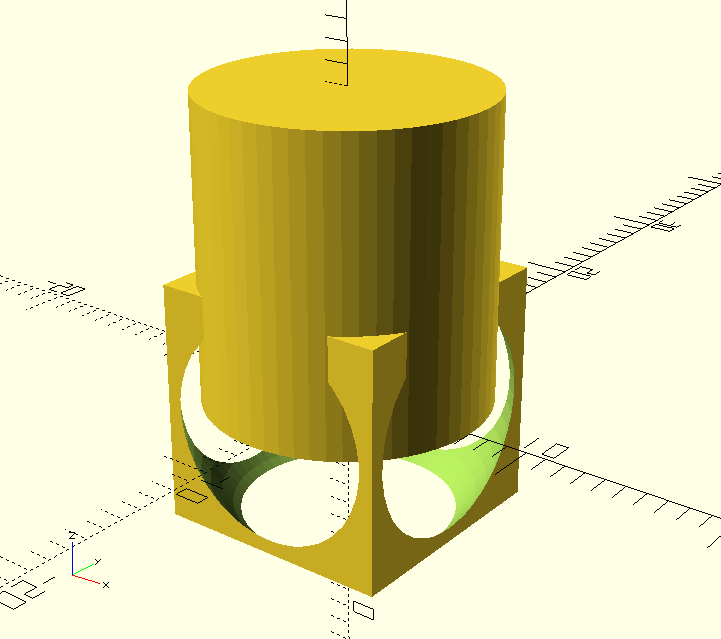

As I had similar thoughts after using OpenSCAD for some time, I made
AngelScript CSG which I currently use for generating OpenSCAD models.
Your example then becomes straight forward (AngelScript syntax):
solid@ myShape = difference3d(cube(12,true),sphere(8));
@myShape       = union3d(myShape, cylinder(15,7));
When running this, an OpenSCAD .csg file can be generated and the result
in OpenSCAD is as shown in the attached image.

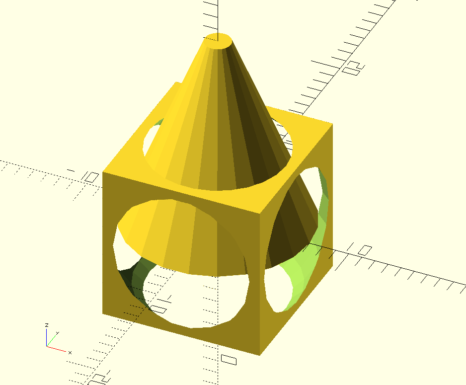

module partOfMyShape() difference()  {cube(12, center=true); sphere(8);};
module myShape() union()  {partOfMyShape(); cylinder(15, 7);};
myShape();
Makes a lot more sense though. Why use a single name to represent two
different things?
It produces this:
Seems like AngelScript CSG interprets the cylinder parameters differently
to OpenScad.

On 24. feb. 2016 23:48, nop head wrote:
cylinder(15, 7);
Just inserting myself here as the openscad newbie.
Is this expected?
If I check the manual, it says
cylinder(h = height, r1 = BottomRadius, r2 = TopRadius, center = true/false);
*Parameters*
*h* : height of the cylinder or cone
*r*  : radius of cylinder. r1 = r2 = r.
*r1* : radius, bottom of cone.
*r2* : radius, top of cone.
so I would have assumed that when writing cylinder(15,7); openSCAD
interprets the single r as r=r1=r2 and gives me a cylinder, 15 high, 7
in diameter?
But then again, that is not visible from the functions' parameter list.
The manual goes on to state
defaults: cylinder();  yields: cylinder($fn = 0, $fa = 12, $fs = 2, h = 1, r1 = 1, r2 = 1, center = false);
which probably explains the cone (H and R1 are given, R2 is assumed
default).
But this is a bit confusing to me, shouldn't the manual then NOT state
that r1=r2=r ?
On 24. feb. 2016 23:48, nop head wrote: > cylinder(15, 7); Just inserting myself here as the openscad newbie. Is this expected? If I check the manual, it says cylinder(h = height, r1 = BottomRadius, r2 = TopRadius, center = true/false); *Parameters* *h* : height of the cylinder or cone *r* : radius of cylinder. r1 = r2 = r. *r1* : radius, bottom of cone. *r2* : radius, top of cone. so I would have assumed that when writing cylinder(15,7); openSCAD interprets the single r as r=r1=r2 and gives me a cylinder, 15 high, 7 in diameter? But then again, that is not visible from the functions' parameter list. The manual goes on to state defaults: cylinder(); yields: cylinder($fn = 0, $fa = 12, $fs = 2, h = 1, r1 = 1, r2 = 1, center = false); which probably explains the cone (H and R1 are given, R2 is assumed default). But this is a bit confusing to me, shouldn't the manual then NOT state that r1=r2=r ?
Thu, Feb 25, 2016 1:31 PM
Yes it was a surprise to me as well but cylinder also takes d and d1 and
d2, so I have no idea how positional parameters are interpreted. I always
use the names for cylinder.

of cone.
diameter?
default).
that r1=r2=r ?
Yes it was a surprise to me as well but cylinder also takes d and d1 and d2, so I have no idea how positional parameters are interpreted. I always use the names for cylinder. On 25 February 2016 at 12:53, Stefan Göttsche <stefan.gottsche@gmail.com> wrote: > On 24. feb. 2016 23:48, nop head wrote: > > cylinder(15, 7); > > Just inserting myself here as the openscad newbie. > Is this expected? > If I check the manual, it says > > cylinder(h = height, r1 = BottomRadius, r2 = TopRadius, center = true/false); > > *Parameters* *h* : height of the cylinder or cone *r* : radius of > cylinder. r1 = r2 = r. *r1* : radius, bottom of cone. *r2* : radius, top > of cone. > > so I would have assumed that when writing cylinder(15,7); openSCAD > interprets the single r as r=r1=r2 and gives me a cylinder, 15 high, 7 in > diameter? > But then again, that is not visible from the functions' parameter list. > > The manual goes on to state > > defaults: cylinder(); yields: cylinder($fn = 0, $fa = 12, $fs = 2, h = 1, r1 = 1, r2 = 1, center = false); > > > > which probably explains the cone (H and R1 are given, R2 is assumed > default). > > But this is a bit confusing to me, shouldn't the manual then NOT state > that r1=r2=r ? > > > _______________________________________________ > OpenSCAD mailing list > Discuss@lists.openscad.org > http://lists.openscad.org/mailman/listinfo/discuss_lists.openscad.org > >
arnholm@arnholm.org
Thu, Feb 25, 2016 2:02 PM
in diameter?
cylinder(15,7) in OpenSCAD is equivalent to cylinder(15,r1=7) which will
give you a cone with default r2=1. You can, however, write
cylinder(15,r=7) to get a proper cylinder (constant radius).
In AngelScript CSG, cone and cylinder are distinct types, a cylinder
will always have constant radius:
cylinder@ c1 = cylinder(15,7);  // a cylinder: h, r
cone@ c2 = cone(15,7,1);    // a cone: h, r1, r2
http://arnholm.org/
