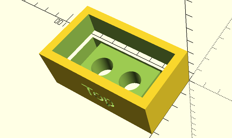

I have come across an odd problem.
I have a box out of which I cut various holes using difference() which is for a drill guide.
This works fine, but the side of the thing over which the guide fits is slightly slanted, making it not fit well.
So I made the cut out which creates the hole for the to-be-drilled-box into a polyhedron, so the floor could have the matching slant.
This works fine when I cut out a cube. But when I cut out a polyhedron, the bottom surface of the shape cut from the cube is see through.
Any insights would be much appreciated.

// Drill guide for Attenuator holes
// A box with the bottom slanted, to match the slanted side of the Hammond 1590B, which is 112mm long
// on the base and 111mm long on the top. To be cut out of the main lump of plastic.
module slanted_side_box(width, depth, height, slant) {
polyhedron(
points=[[0,0,0],[0,depth,slant],[width,depth,slant],[width,0,0], [0,0,height+4],[0,depth,height+4],[width,depth,height+4],[width,0,height+4]],
faces=[[0,1,2,3],[0,4,7,3],[0,1,5,4],[1,2,6,5],[3,7,6,2],[4,5,6,7]], convexity = 10);

Hi David,
It's a good idea to start a new topic rather than replying to someone
else's.
You problem isa face is inside-out. You see this in View/Thrown-together as
purple;
http://forum.openscad.org/file/n16248/davidJohnson.jpg
See Point ordering for faces in
https://en.wikibooks.org/wiki/OpenSCAD_User_Manual/Primitive_Solids#polyhedron

Ah. That got quite counterintuitive. The polyhedron is declared all CW on
all faces, but when taking a difference and the face becomes the inside,
so needs to be run CCW.
So constructing the polyhedron as a solid first (so you can see what
you're making) then stuffing into your solid as a difference, doesn't
work. You have to CCWize the formerly outside faces that are now inside.
Changing the first face (the bottom) to CCW works..
convexity = 10);
to
faces=[[0,3,2,1],[0,4,7,3],[0,1,5,4],[1,2,6,5],[3,7,6,2],[4,5,6,7]],
convexity = 10);
I.E. [[CCW],[CW],[CW],[CW],[CW].[CW]]

No that isn't true. You don't have to construct a polyhedron differently
when it is used in a difference. You simply had the bottom face CCW and it
needs to be CW looking from the outside, i.e. viewed from underneath.
I.e. [0,1,2,3]
is CW.
