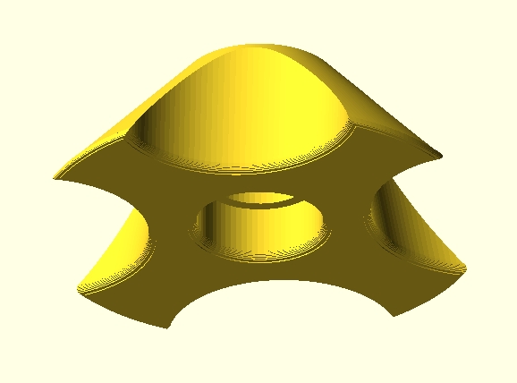

Ray West
Tue, May 11, 2021 10:54 PM
I said it was slow. For simple shapes, cubes/whatever, then there are
quicker ways, but it is faster if you run the scad script in AngelCAD,
pretty darn fast, in fact. You can control the stair stepping - it makes
no difference in 3d printing, use finer steps. Minkowski does not do
fillets - it adds, not subtracts the rounding, as does offset in 2d.
Hull just wraps the shape, it does not follow indents. In the past, I've
used freecad, which has useful filleting, and for stuff like boxes I've
generated shaped extrusions to round of the corners by differencing, and
you do not need to go back and alter dimensions as you would need to do
for simpler shapes, using hull or minkowski. But using the code I
mentioned, you can  easily round of the bottom or top edge of shapes,
such as below, and afaik, there is no inbuilt method for filleting in
openscad.
